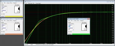

I have worked for a while on designing drivers now and I wanted to make something I would really love to have in my own system. After a bit of considerations, I found out that the basic requirements should be as follows:
- T/S-parameters that fits a 150 liter vented box with 24Hz tuning.
- X-max (real x-max) in the 10-12mm range.
- 15 inch paper cone and paper dustcap with F0-1000Hz operating range.
- Roll off that fits a typical room response (-3dB @ 50-60Hz and -6dB @ 30-35Hz).

The idea is as follows:
- The system is compatible with standard ABS plumbing tubes.
- It is a concentric port with a core element to give the entire exit a larger circumference so that it can withstand higher flow speeds.
- The flare has a cross section profile that is exponential with a low coefficient so that the air speed is gradually reduced until it reaches the roundover. The cross section of the exit is therefore around 3 times the cross section of the tube itself.
- The core of the concentric tube is a closed ends quarter wave resonator that is designed to absorb the main mode of the main tube. It does this through a diffused part mid way through the tube. At this point the main tube has a pressure maximum while the inner tube has a node.
- The system allows for a slightly smaller tube, thus shorter, compared to typical ports. This raises the fundamental mode of the entire port. And since the fundamental mode is absorbed, the secondary mode, which is also raised due to the shortened port, will be around 2,5 times higher than comparable solutions.
I am planning to make documentation that describes the effective acoustic length of each part. I also plan to make laminar bends with separate ducts and larger radius to make the air less turbulent through the bend.
This is what the flare looks like at this point. It uses a 90mm + a 50mm tube, and the flare is 99x99mm with 5mm corner radius:
