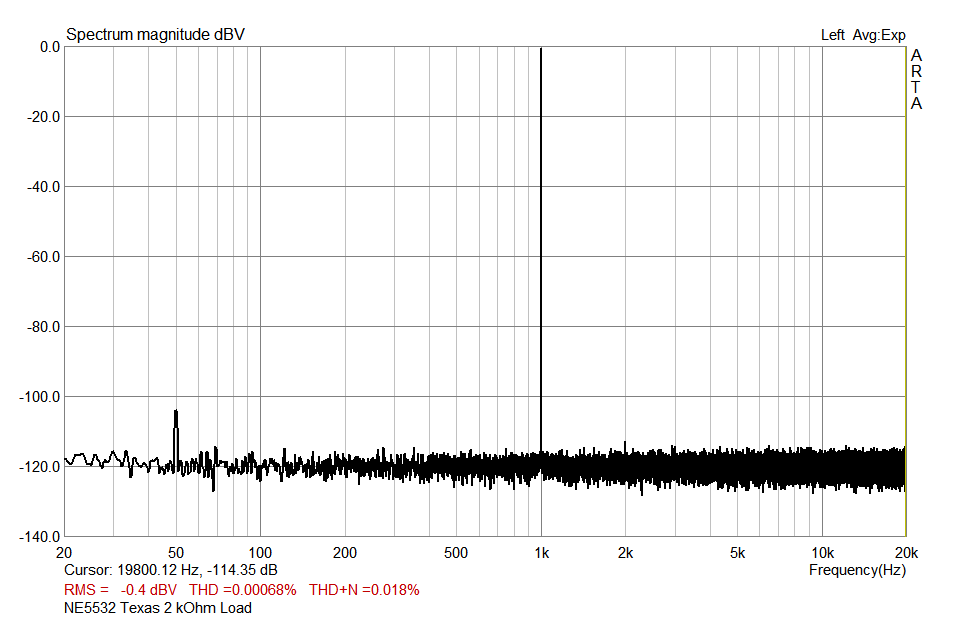

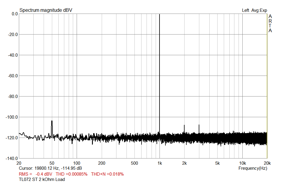

Just measured a couple of examples to illustrate your argument. TI 5532P vs ST TL02CN Inverting configuration Gain=10 Output=1VRMS across 2kΩ Load. I kept the test output level at 0dBV to avoid visible THD contribution from the sound card. Best performing sample I have is a TL082CP vintage National Semiconductor by the way. Goes 0.00075% in same conditions.
^ Interesting result, thanks for trying that. We probably all suspect there is always more to 'how they sound' than just raw numbers but its great to see an actual device tested.

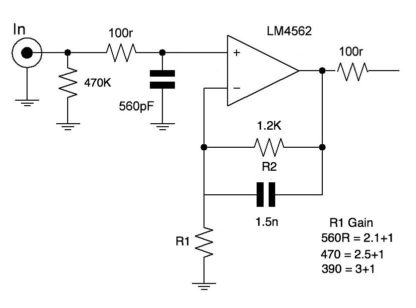

Here's a sample of the opamp circuit I'll be using att. By all means criticise it!
Nothing to criticise so much... just observations 🙂
The 470k input resistor is fine but will allow a very small DC offset to appear at the output, an offset made worse by the fact the feedback return is DC coupled (so the offset voltage at the input is amplified by the circuit gain).
Also any DC already present in whatever you connect will also be amplified.
The feedback values are good for minimizing noise contribution and even at 2 to 3 volts RMS output will only 'consume' around 3ma peak or less of the available current the opamp can deliver.

Thanks for that, Mooly. What value input resister should I use to replace 470K? I see a few circuits with 47K.

It all depends...
If the circuit was AC coupled at the input and output then 470k is perfect. It offers light loading and the noise contribution (in all cases) doesn't figure into things because it falls as you parallel the resistor with whatever you connect to the input.
If the circuit you are connecting the input to is direct coupled anyway (such as straight from another opamp stage) then you don't need the 470k at all because the driving source sets all the DC conditions and impedance.
AC coupling the opamp output is pretty much universally advised, value of cap dependent on what you intend to connect it to.
