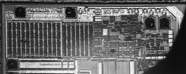

Does anyone know the logo [M] left-top on the attached pic? Looks like Matsushita to me.
Could be from a production by Matsushita for Analog Devices. It is not uncommon in this industry to have basics like wafer´s made by another company.
Such a chip is nothing secret, you can open and copy it. If another company has free capacity to produce them, maybe even cheaper than AD, that is no problem, just a commercial decision.
