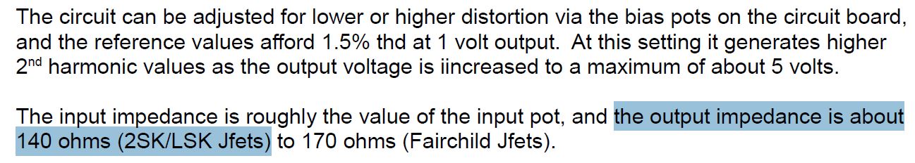

Input impedance is 140ohm
Weird number. How did you come up with it?
Not that the circuit shown has either such ridiculously low input impedance or is inverting.
Is this what you are looking for?I'm trying to make an inverting buffer to pair a pre-amp to headphones and hoping for some recommendations for a suitable op-amp. (Sorry, I've only just started to dip my toes into chips!)
That number came from the application note by Nelson Pass.

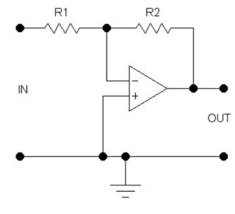

Is this one better:
Thanks, that looks like it could work.
Am I right that the gain for that one is A = -47k/12k = -3.91?
Would I need to alter the values to match the source impedance?
That looks like a cracking op amp for the job. It's the first time I have come across it so I don't know if it's the zenith for a headphone amp (having never done one) but you could certainly do (a lot) worse.
No, that's not the arrangement for an inverter. The usual setup is the -ve input being used with a series resistor and (for a gain of 1) the same resistor in the feedback loop. You then take the +ve to Gnd through a resistor or directly. Look at the datasheet for this (I have only skimmed it) but don't let the feedback resistor get so low that it's drawing too much current. There is often some advice in the datasheet on what the chip likes best but in general you don't want to be heating up the feedback resistor. You can also use the feedback resistor as a volume control if you put a pot in its place.
You will also need to bias the op amp to 1/2 Vcc, which also means you will need a capacitor on the input and output. How you drop the 4.5V or 12V onto the input is up to you but if you use a potential divider then half of the ripple on the supply will get onto the signal path. It's a dreadful way of doing it but plenty of people have in the past.

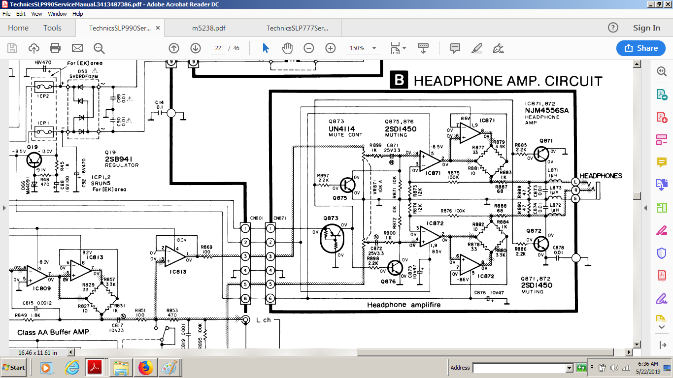

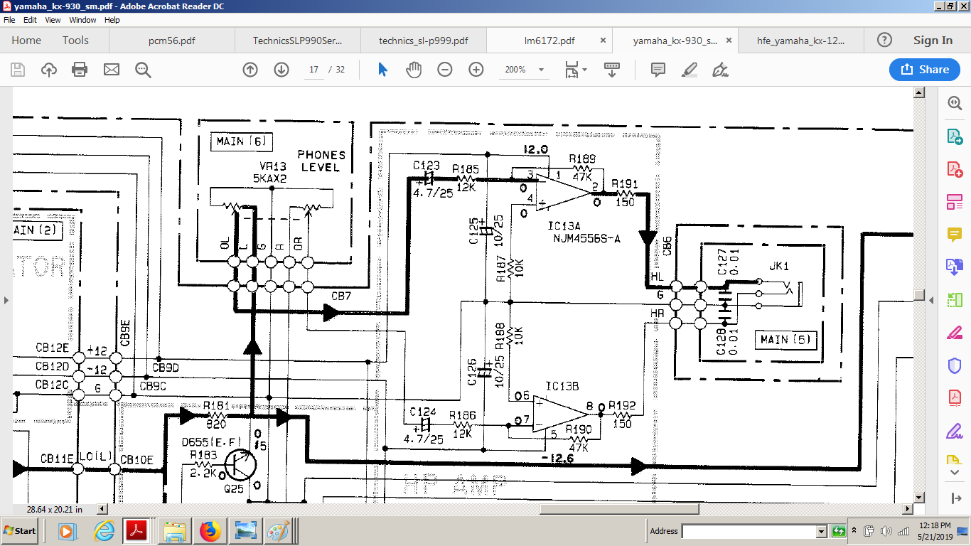

The headphones amp schematic is working in some of the best Yamaha cassette players and monitoring the line input from a cd player made me realize that this is a very good headphones amp.Now i would recommend something even more interesting as i'm going to build this thing myself after having a chat with a friend who has the Technics slp990. As you see, they both use very low value potentiometers , 1k in the Technics which has a unity gain buffer for that purpose.
Both used njm4556s (sa) which was a special version of njm4556, but the usual 4556D through hole version can do a very good job too.
