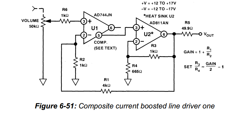

the AD744 +AD811 combo by Walt Jung works very well as a line stage.
i built and used one heavily years ago and still use it occasionally between experiments with other line stage designs i play with.
Thanks to a rare/unique feature of the pinout of the AD744, Walt's design does not use the AD744's output stage to drive the AD811.

Below is the schematic for the Jung 744/811 preamp.
Other JFET op-amps can be used if you connect pin 6 to the input of the 811.
Even some bipolars can be used, but watch out for high DC offset at the outputs!
The sound is okay, but I find most op-amps(including the 744 when using pin 6 instead of pin 5) actually sound better when used by themselves and forgetting about the AD811s.

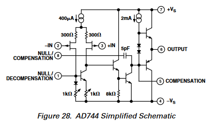

Honestly, I'm not convinced that 811 can sound good. It is ultra fast/wide bandwidth and high output current, but as long as we don't need those two properties, it looks hopeless to me.
744 OTOH can be special. I own 746, which is the dual version of 744. It is slightly inferior than the 744 (from spec) but it has potential that I have been tempted to buy the 744. Now that I know it has the COMP pin that can be used to bypass the output, I'm more tempted.
But if we take the output from COMP, the signal is inverted. It seems that we can take the output from the output pin but running it in class-A (with resistor bypass)?
Opamps do exist which have an inverting output stage and an external COMP pin - CA3130 comes to mind which I played with a lot in my childhood. Input pins could always be transposed to accommodate signal inversion.
I thought the +in was the left JFET while actually it is the right hand side JFET.
Have never played with such comp/output pin. Will keep an eye for the CA3130 🙂

Since you have the AD746, why don't you try it by itself and forget about the AD811, BUF634, LM6171 or any other high output op-amp that can only totally ruin the sound quality?
I have tried almost every op-amp out there from all the top companies over the years and I can tell you without a shadow of doubt that adding some type of buffer after most op-amps whether a IC(like the BUF634 or the infamous but sh_tty sounding LME49600) or a discrete buffer like the wildly popular BD139/140 output stage used in the Lehmann Cube and some other headphone amps, only totally ruins the sound of a otherwise good-sounding and simple op-amp circuit.
