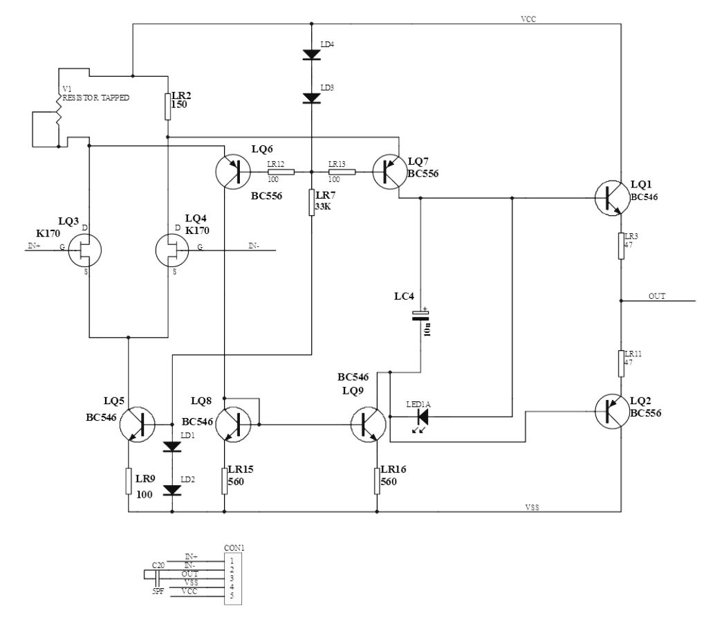

In the case of those discrete ICs that were mentioned, I got to get a schematic, This uses two K170s. and a trimmer to balance DC offset. It should drift, though.
A cap or DC servo might be necessary to block DC offset. But you can use higher voltages.
