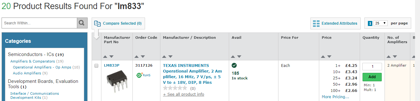

Incidentally, did you know that the DIP LM833s are presently £3 or so at Farnell. So about the price of an OPA1612. Not sure why.
Actually £4.25 in singles. Phew!

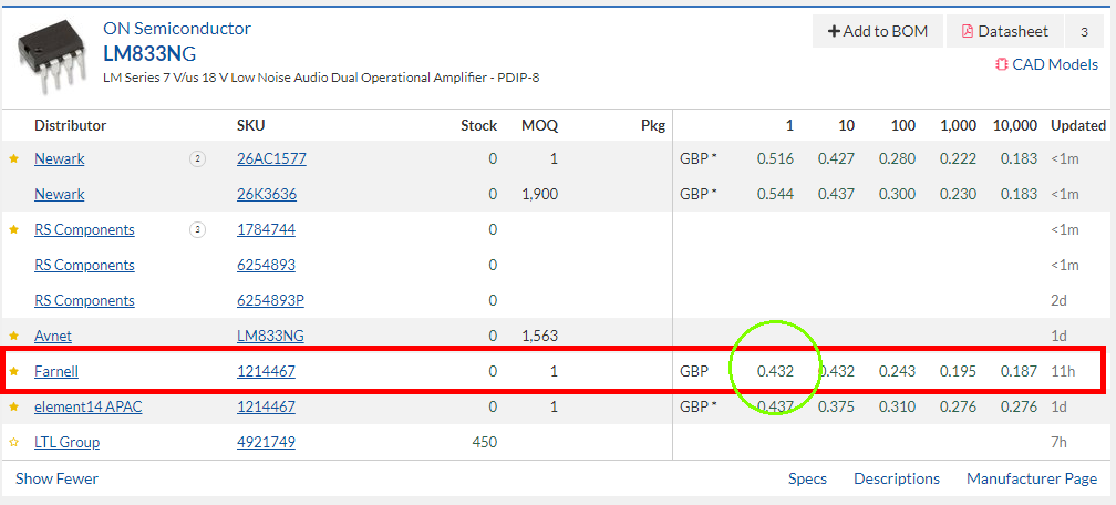

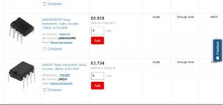

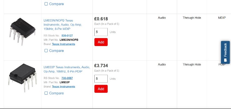

Octopart.com says this
_
For the LM833N Farnell either says No Longer Manufactured or No Longer Stocked. I suspect if you tried to place those orders they'd want to sell you a small outline package.

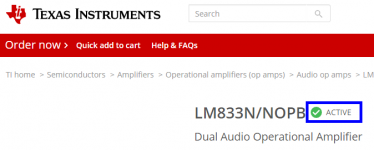

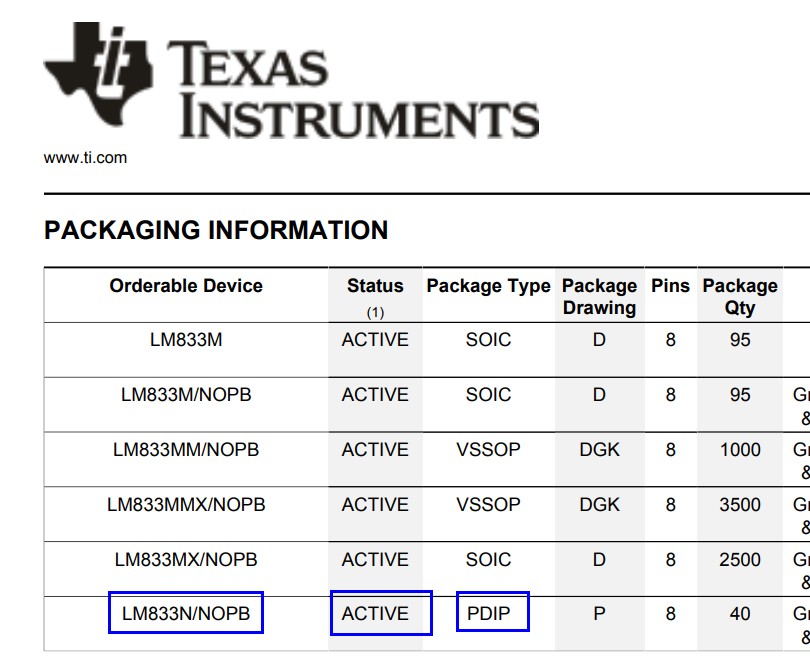

Might have to find another supplier not named Farnell. This is what is on Texas Instruments' website today
_
To be fair it says No Longer Stocked next to the TI 833N and it's an ST Electronics 833N that is no longer manufactured.
But Farnell has been upping its prices everywhere, on all my favourite parts - if they are actually stocking them at all. It's increasingly useless and the website, which was one of the best, now is slow and increasingly frustrating.

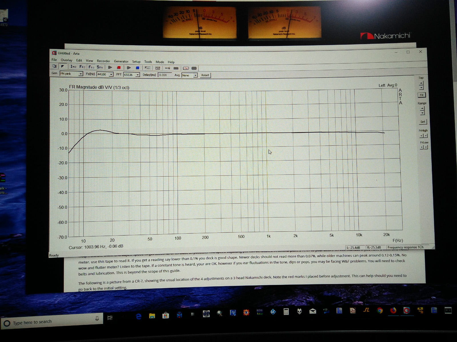

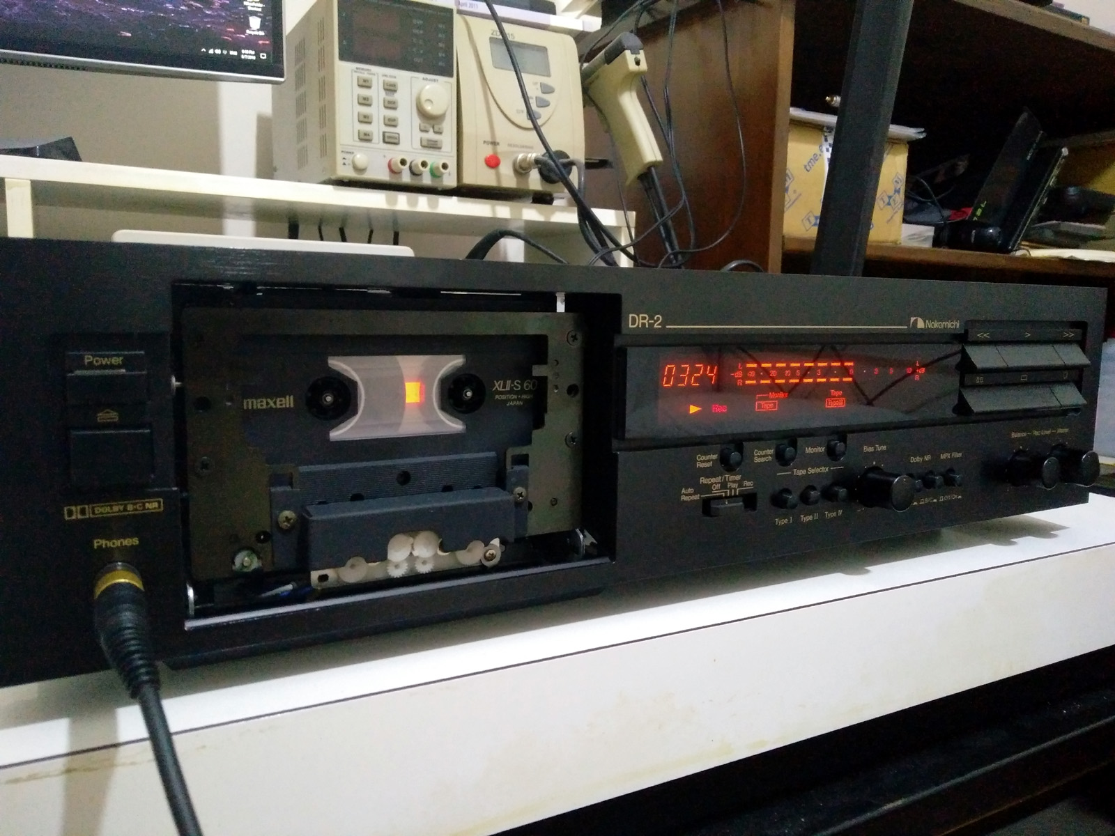

Dolby were not alone. I just dug up pictures from a well preserved cassette deck I was aligning some months ago. Was initially well out for heads height, azimuth, and bias. Many hours later a nice result even for a TDK-D graph (-20dB actual REC level).

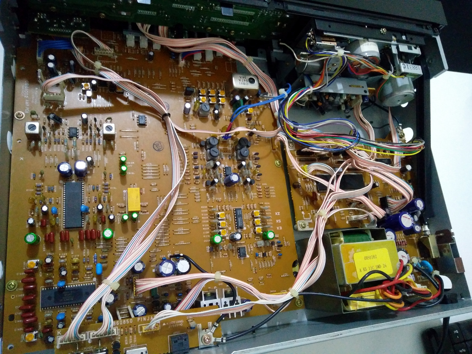

The three head Nakamichi DR-2. Introduced in 1992. This is a made in Taiwan unit from 1995. Not a sharp shot but JRC proudly stamped on the eight legged bugs is still visible. Those are mainly 1V/us NJM4558. In many models including the CR-7.
They never let go of those NJM and their boosted derivatives until they stopped making decks. Even when they had the good sensibility to use low THD green bipolar Nichicons in selected places of their later years decks as seen in the photo.
