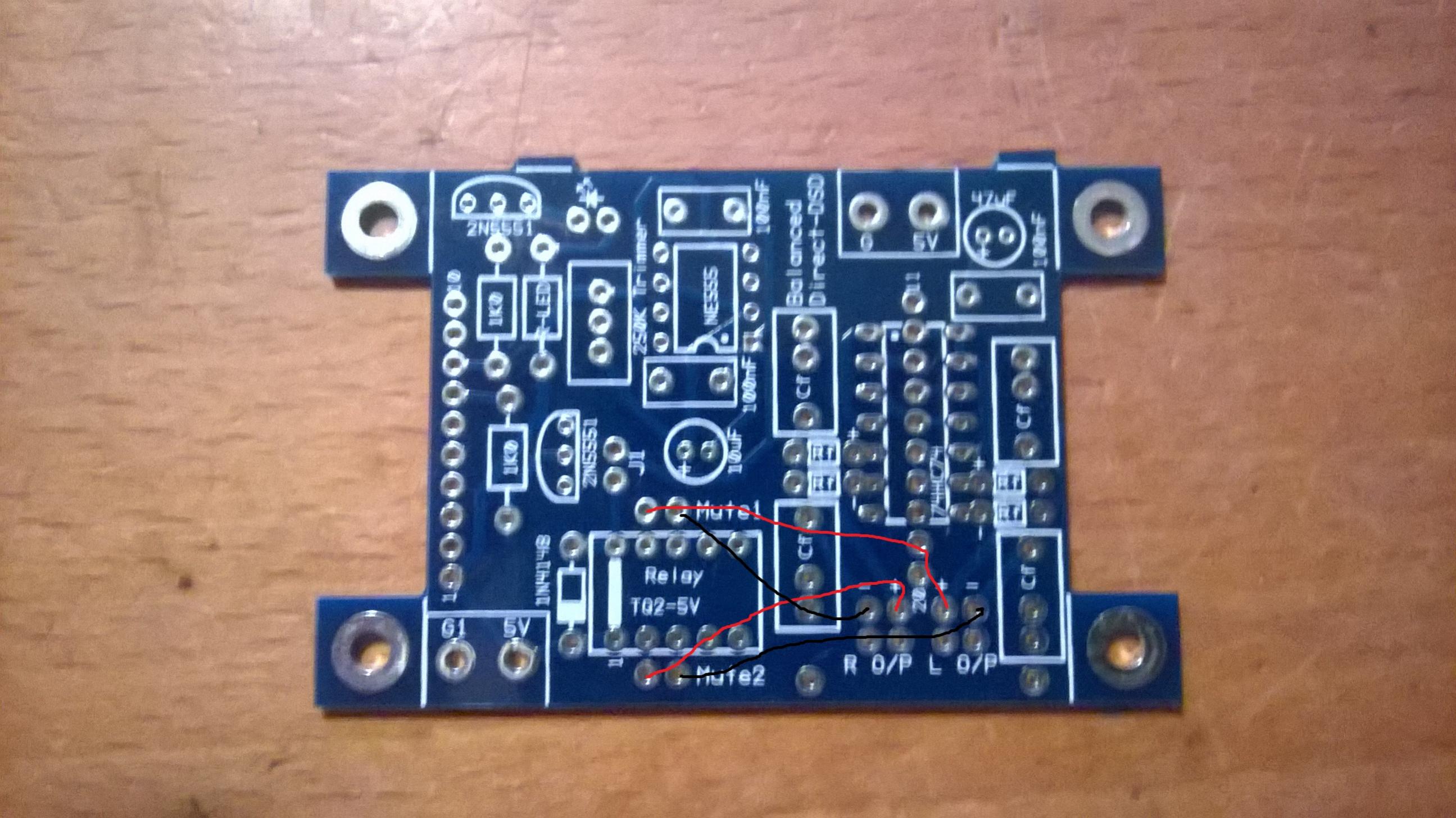

The isue with Fabio's circuit is that I have "no sound"!!!!!!!!!!!!
Have you tried adjusting the preset? Maybe it is in a position that means the relay is 'locked' in the mute position.
It looks you've inverted channels' return:Pic how I connected the mute, is OK?
Mute 1 Pin 1 = channel 1 signal (or channel 1 output +)
Mute 1 Pin 2 = ground (or channel 1 output -)
Mute 2 Pin 1 = channel 2 signal (or channel 2 output +)
Mute 2 Pin 2 = ground (or channel 2 output -)
Ray

Yes, preset = trimmer pot.
Regarding mute connections, should be as ghiglie has pointed out.

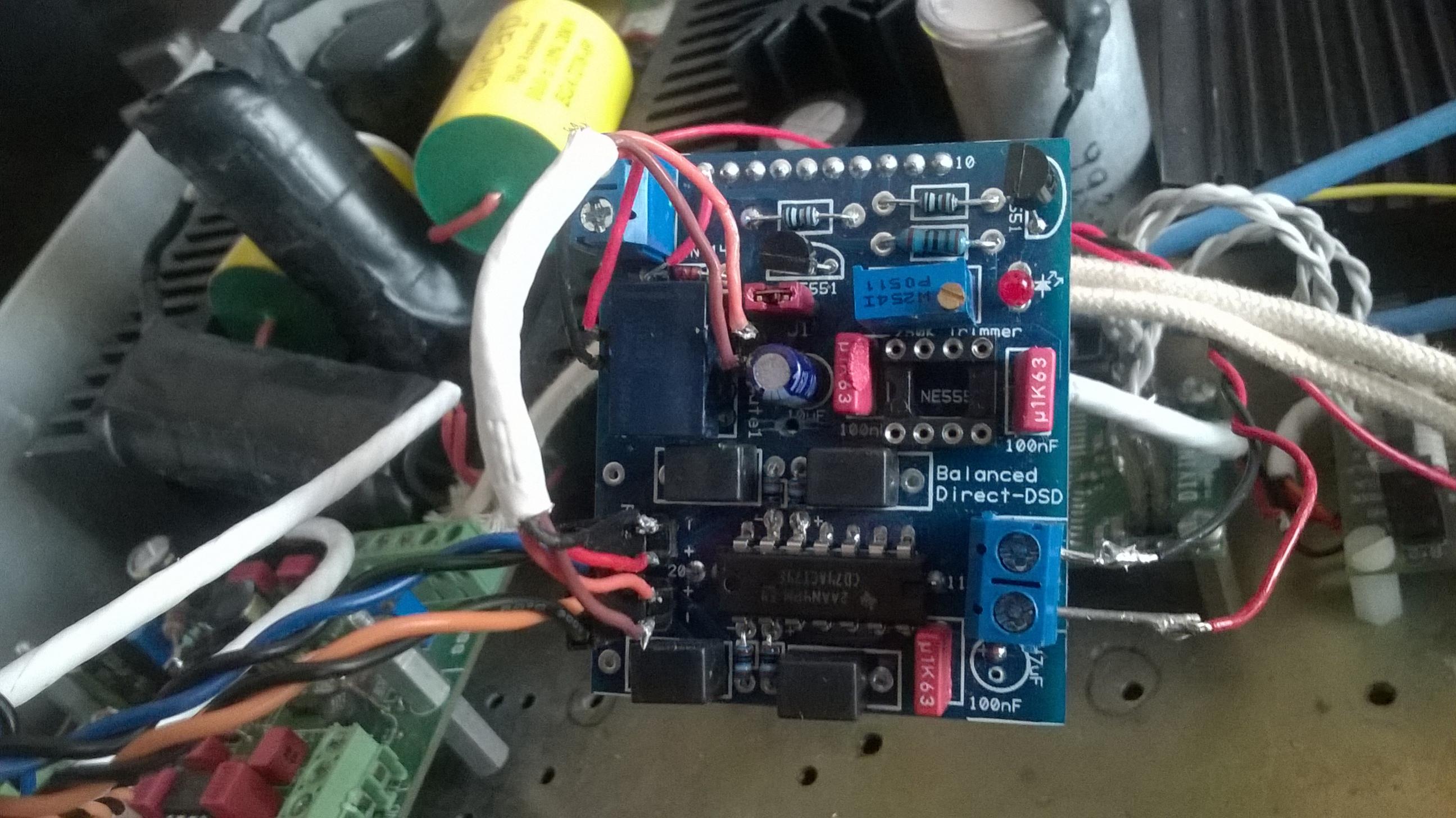

I did not draw well the connections, attached real pic, is OK?
Looks OK
