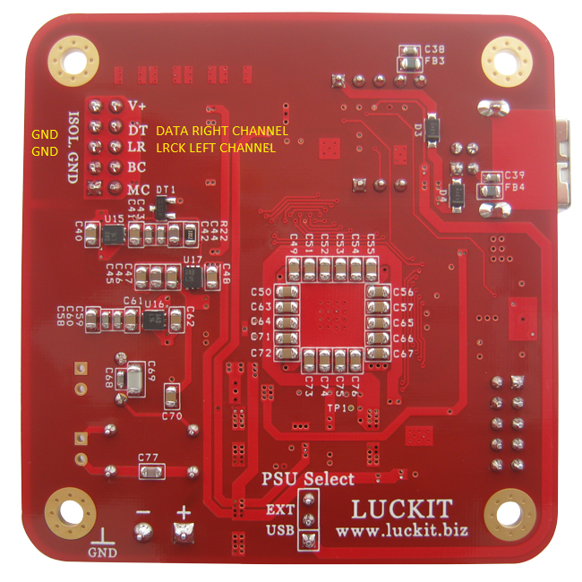

Ray the Pin numbers are as per attached picture or inverted?

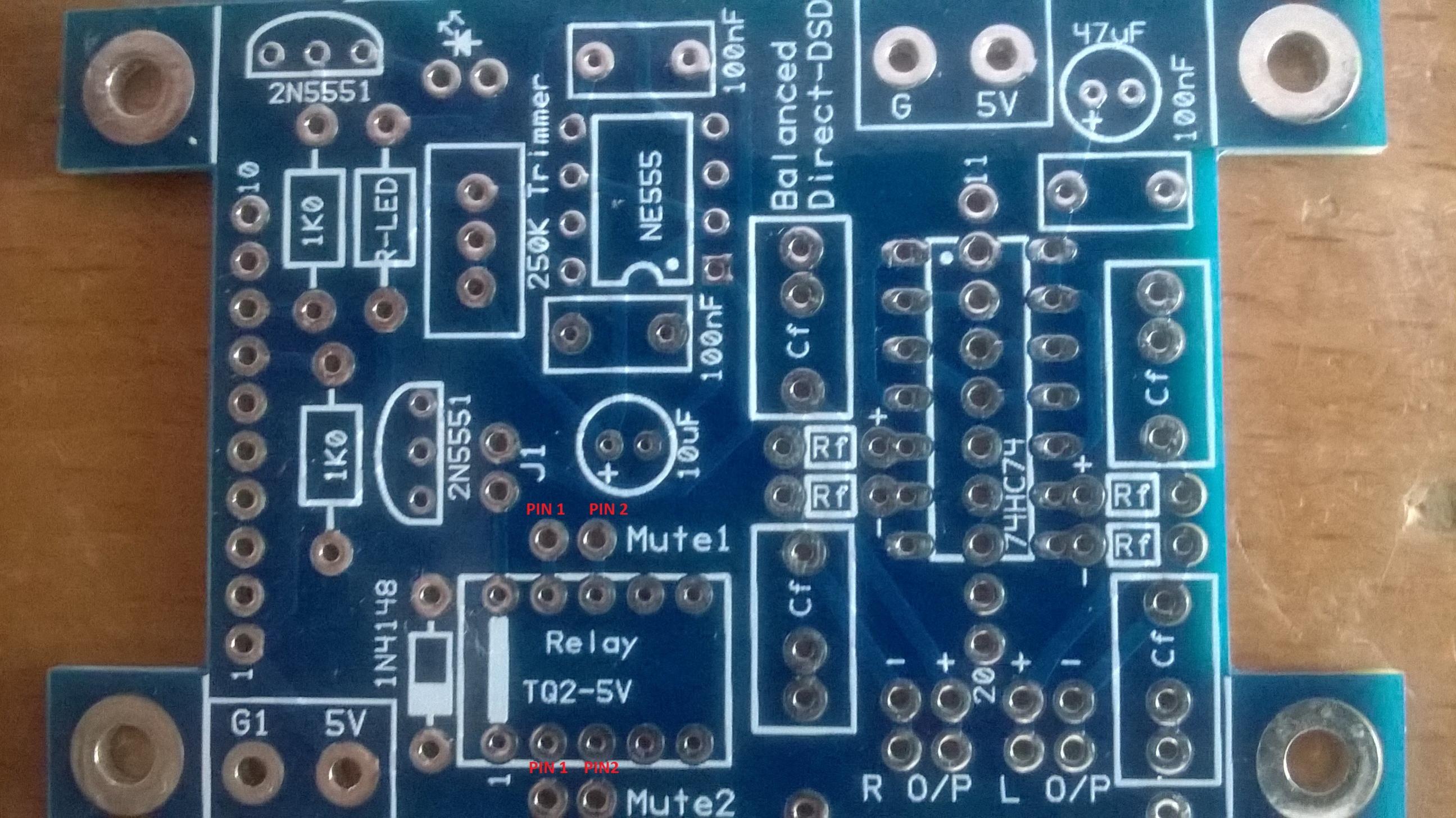

As you've used an IC socket for the NE555 you can have both mute options available if you use a header and removable jumper instead of soldering a link across J1. That's what I have done;
There's a schematic here;
http://www.diyaudio.com/forums/digital-line-level/273474-best-dac-no-dac-94.html#post4630381
No.
Mute 1 Pin 1 = channel 1 signal (or channel 1 output +)
Mute 1 Pin 2 = ground (or channel 1 output -)
Mute 2 Pin 1 = channel 2 signal (or channel 2 output +)
Mute 2 Pin 2 = ground (or channel 2 output -)

No, I was still talking about Mute1&2, just wondering how you'll use them - just 'cause as you've seen I have same 2pin strip soldered.
I was plenty of 2pin female sockets I used to salvage from old PC chassis... Wish I had kept them so I could try them here.

I use this sort of thing;
Du Pont header pin crimp connectors | eBay
Ray
That's just what I was referring to, I have a bag of them... somewhere. Yet cabled - you can get them from old computers, they are used for LEDs and reset switch (2pin) and come splitted or 3pins for ATX power button.
