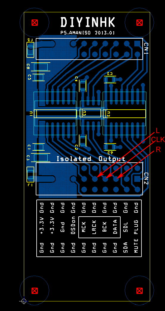

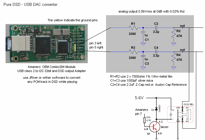

Works but needs more filtering, mixed signal with strong white noise, I used as per Ray advice 1K + 3.3nF.

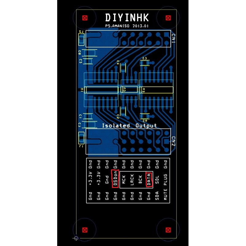

The DSDon line is just an indicator that the Amanero is outputting DSD! The actual DSD signal is coming out of the BCL, DATA & LRCK lines.

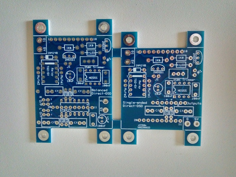

BTW, I too have received my boards. Thanks Ray! 🙂
Eureka, works like a charm, no noise and I have 94dBs speakers....
Good news, what do you think. Any pictures😀
BTW, if you've populated all of your SE board, if you connect DSDon to the pin8 pad you should have the LED light when you have DSD data to the amanero.
First impression is more relaxed and less electronic sound like less processed, have less gain than B3 + Legato, I used 1K Shinkoh + 3,3nF MKP 1000V, I have to listen more, I will keep informed.
