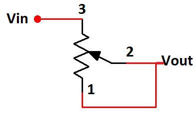

I think a potentiometer Is not the best way to achieve a volume control in that place.

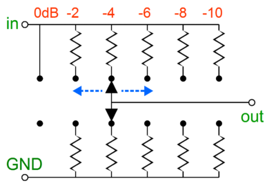

If you want a potentiometer, it must have a constant input impedance - eg a shunt ladder stepped attenuator.
If you use a simple potentiometer, every time you change volume you change the LPF -3dB frequency.
I don't think I said it was the best way, just that I did it - it actually worked very well.
I'm adding an analogue volume control to my current project and will be using a balanced 'U' shunt attenuator between the LP filter and the buffer input.

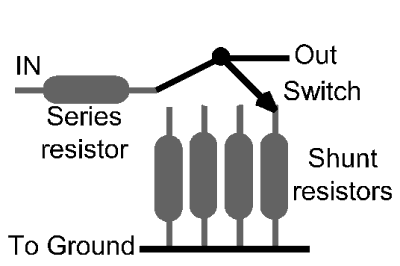

Shunt attenuator (1 resistor) changes the LPF -3dB frecuency, ladder attenuator (2 resistors) not changes the LPF -3dB frecuency.

Now I'm confused. Thinking about this, wouldn't a 50K potentiometer always be a 50K load? Merlin's second diagram looks just like a potentiometer to me too - I'm assuming each pair or resistors always add up to the same total resistance so switching between pairs of resistors changes the potential divider ratio, just like a wiper in a pot?
Somebody educate me please
In the second graph the input impedance is always the same since always the sum of both resistances is equal (10K, 25K, 50K, etc depending your attenuator choice)

See attachment - regular potentiometer.
The best way is, of course, the ladder one.

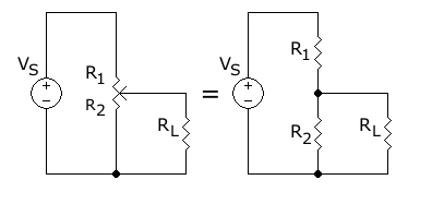

With regular potentiometer R1 and R2 vary with volume changes, so Zin from source is:
R1+R2*RL/(R2+RL) = not constant.

It is not a big problem due to the LPF (relative) high frequency.
Even if you change a little the Rin, frequency is always high enough to regular operation.

How is that possible? both circuits are simple potential dividers, electrically the same. If they're electrically the same then they must behave the same.

Thanks iperv, I think your equation is the information I was missing. I'll run some values through that a bit later so I can see what is going on.

Assume a fixed RL. If you have two potential dividers (#1 and #2) and at any given point, R1(#1) = R1(#2) and R2(#1) = R2(#2) then Zin(#1) must = Zin(#2), regardless of whether R1 and R2 are defined by a potentiometer or fixed value resistors.
Pot not varies the impedance seen by the source, pot varies the impedance seen by the load.
