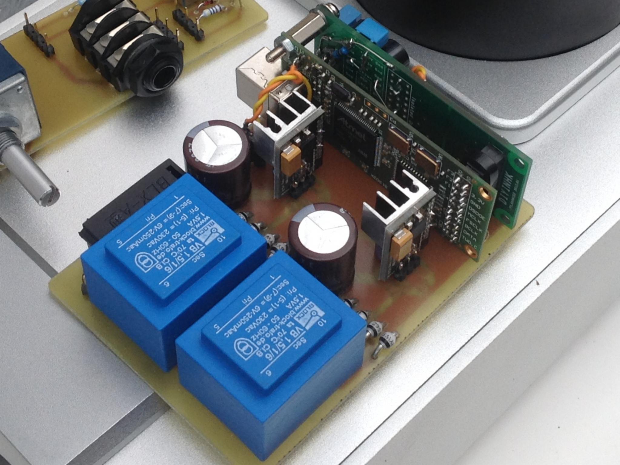

Here's this weekend's experiment;
Balanced/flipflop board mounted on the JLSounds with the differential outputs going straight to Silk STA522S transformer volume controls - the TVC is the LP filter and there's no R/C filter.
Input is DSD256, upsampled from 16/44.1 PCM with HQPlayer.
As it stands this delivers the most amazing sound quality, I think perhaps the best I've yet achieved with the no-dac approach, but, frustratingly, it is also the worst I've had for noise - there's audible white noise/mush during quieter passages.
It's so good I'm going to have to persevere with it.
I'm currently powering everything via USB so the first thing I'll try is to hook up some good quality low noise power supplies, which will also re-enable the USB board's isolation.
Also, the wires connecting the flipflop outputs to the TVCs are quite long (didn't want to cut the wires short until I had an idea of the potential) and there are a lot of unscreened wires from the TVCs to the switch, which could be acting as antennas.
Thoughts?

Very interesting
It seems like tvcs aren't enough to act as lpf.
It's a shame, on paper they are the best way.
Can you monitor the waveform with an oscilloscope?
It seems that an active buffer is a must.
EDIT: too long unshielded wires and radio frequency waveform is not good for a silent audio experience.
EDIT2: you can try to close board and tvcs in a solid metal chassie.

Maybe u can try cascading the 2 TVC to one channel only, the input of the 2nd TVC to the output of the first TVC just to see if there is noise on one channel... or adding the RC filter in the signal path just to experiment...
white noise on the 20KHz band might not be coming from the DSD signal... @256DSD the noise is pretty far away...
I was able to play DSD(2.8Mhz) without problems using digital filter method from electrart and yanasoft...the filter cutoff is rather modest...of course there is the opamp LPF on the electrart board and the yanasof board had a Lundahl transformer to further cut off the signal...
the electrart board i got initially had static noise as well... but i solve it by removing most of the parts and resolder each of them back... maybe its pure luck i got it to work...
Pure DSD DAC (DAC Less)
yet to try the passive LPF... hopefully i get he time to experiment it myself...
I've just spent a couple of hours listening to the TVC project.
I hooked up some good quality low noise power supplies. Although they didn't fix the noise issue they did deliver a good step upwards with the sound quality.
I don't want to lose what this project is delivering, the music is so immediate but with an organic sort of quality. Everything in the music has it's own space and the details really tell you about the playing. To be honest it is really hard to put into words; perhaps real would be a good descriptor.
But then there's the noise!
With a little experimentation I have determined that the noise isn't general environmental interference being picked up as it isn't present when there is no playback. I'll still look out for a metal enclosure I can put it inside to confirm this hypothesis.
So if it is playback related it must either be the result of the filtering not working well enough or by noise being generated by the digital circuitry which is picked up via the antenna.
I'll try to record the noise tomorrow evening.
I can't look at the noise on an oscilloscope as I haven't owned one for a number of years after my last one went to oscilloscope heaven.
I'm thinking I'll make up another flipflop board with LP filters, followed by the TVCs. Perhaps that sort of compound arrangement will eliminate the noise.

Well.
I still think an active buffer is a must, but it's only my though.
Dsd works like a sigma-Delta dac.
The frequency shaping push out the noise.
The noise is a white noise, white noise is common mode noise.
Balanced output make possible for us to work with the noise.
By the way, i'm planning on a valve buffer that acts as unbalancer and i'm asking myself how much exactly is the single ended rms voltage at output.

When there is no playback, there is no high frequency signal.
So you still don't know nothing about the 'goodness' of the devices.
Probably a set of good shielded wires will work well.
Ray, I would love to try a pair of Silk TVCs but they are a bit pricey right now, especially with AUD exchange rate. But I think that this is most elegant solution to filtering/buffering/volume control in one device, and I hope that you can make this work.
For what its worth, I think that the noise must be picked up. I say this because:
1. My initial build had lots of noise - but it was a very naked prototype just like yours. I've now enclosed everything and it sounds fine.
2. I use Lundahl transformer for filtering, and I don't have a noise problem, The -3db point on these trannies is above 150kHz!!! So I doubt that you need additional filtering with the Silks, which don't seem to extend as far.
I'm really interested to see how this goes. Good luck.

I don't believe that an active filter is required. In fact, I know that an active filter is not required. Please refer to my earlier circuit diagram.Well.

The noise I'm getting isn't simple white noise, there's a sort of variable mush, a bit like tuning a radio in the old days. I'll try to record the end of one track and the start of the next, when it is most audible.
BTW, I'm running the TVCs with balanced input to SE output at the moment - didn't make that clear before. My Broskie BCF is a Bal to SE buffer so maybe worth a try.
Aound 650-700mV as I recall.
Thanks for the encouragement. Yes, the simplicity is amazing and the results very encouraging.
What sort of noise where you experiencing with your prototype? I'll try and post a sample of the noise I'm getting a bit later.
Thinking about how to break this problem down into rational, testable bites I'm incline to give the LP filter aspect the benefit of the doubt for now as there are some very obvious compromises with the wiring, particularly the long wires from the flipflop outputs (when laying out the PCBs the message from those with the knowledge/experience was keep everything as tight as possible). I'm also trying to work out how I could screen the flipflop device. Would be delighted with some input from any professionals out there?
To test the LP filter aspect I'm thinking I'll put another PCB together but with a LP filter and connect the TVCs after the filter.
Ray
With regards to output voltage - as i documented in an earlier post - I created a 0db test tone (440Hz) and played it back through my no-DAC. I measured 1.55volt output (balanced). But also note that supply rail for my flip flops is a 6V SLA (actual voltage under load is around 6.4V) and I assume that if use use a lower supply rail (say 5volt) then output will be less.

To shield your trafos you can simply put them in a metallic case and connect them to the board with shielded wires.
The board too in a little metallic box is a good idea.
Then put both box in a bigger metallic case.
Yes, it's easy to say but the execution is harder. I'm looking out for something to experiment with.
In the past I have used an inexpensive cake pan! 🙂
