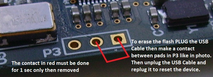

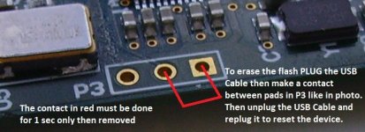

I just downloaded the 1.18 and seeing that there are quite some different CPU & flash options I wonder if I can ask you to share which CPLD & CPU firmwares are the "best" for DSD playback?
Thanks for any help in this ;-)
Jesper
This you can see all
thanks

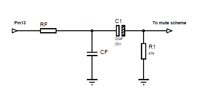

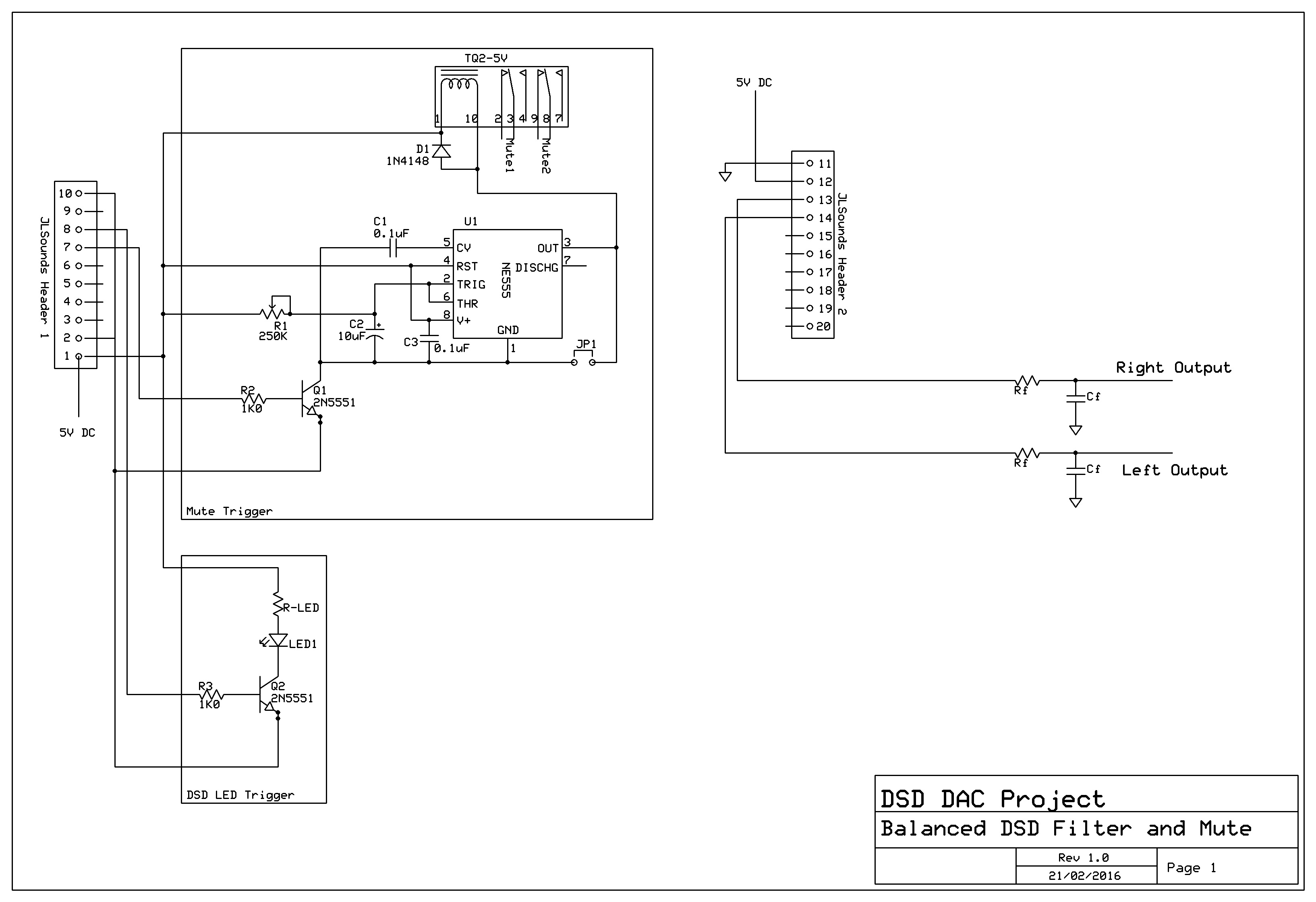

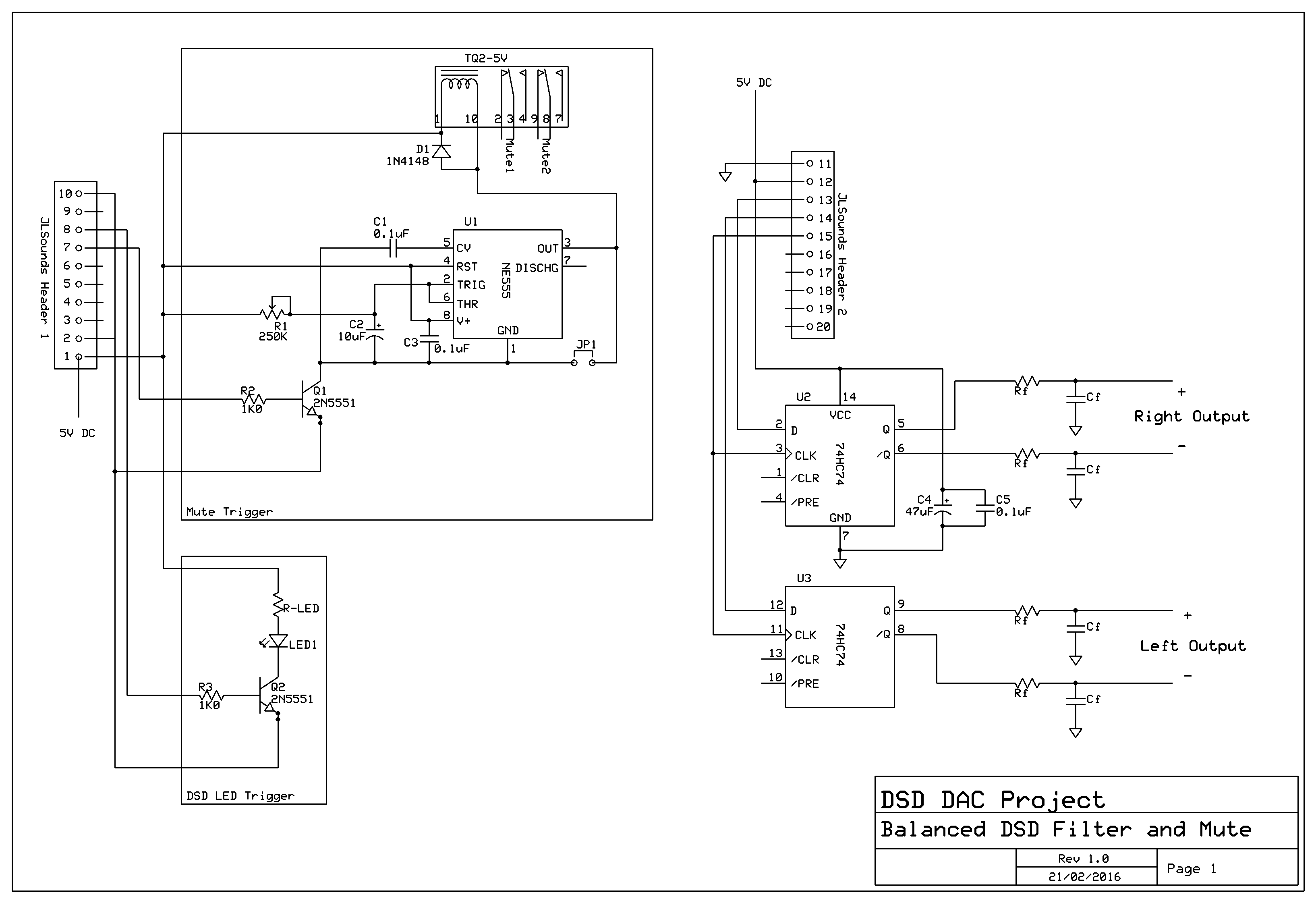

Attached are the schematics and BOMs for both the Balanced and SE boards.
For the SE board, it is worth a reminder that the board only has the LP filter components so you will need to consider DC blocking cap etc. arrangements depending on how you plan to use the boards. I have attached the original JLSounds simple filter schematic that started this whole thing off for info. I believe 22uF is a typo and a 2.2uF cap should suffice. (on my first build I used this original schematic but replaced the 47K0 resistor after the DC blocking cap with a 50K potentiometer to get a volume control.
Anyway, over to you...

Just a brief comment: The formula for the cut off frequency for an RC circuit is 1 / (2*pi*R*C). Thus e.g. if the 22 uF capacitor in the JLSounds example looks into 10 kohms input impedance (e.g. pre-amplifier or amplifier) the cut-off frequency would be 0.7 Hz. With 2.2 uF the cut-off frequency is 7.234 Hz. Many of you probably know this already so I just mention it.
If I understand, what you are describing is a CR, not RC circuit. Gain should be close to zero unless you have a resistor in that path that would form a divider with the input impedance. If it didn't the audio signal would be lost any time there is a sizable capacitor parallel to the signal before any big resistance at all. Please correct me if I'm wrong.

I think a potentiometer Is not the best way to achieve a volume control in that place.
If you want a potentiometer, it must have a constant input impedance - eg a shunt ladder stepped attenuator.
If you use a simple potentiometer, every time you change volume you change the LPF -3dB frequency.
