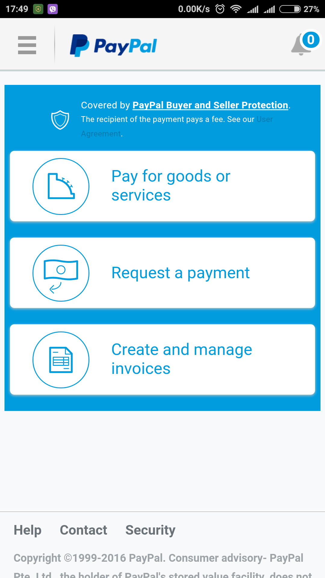

I have a problem with PayPal Australia. There is no gift button and Ray does not accept payment that incurs fees. Not Rays problem but do any Ozzie know a way around this?

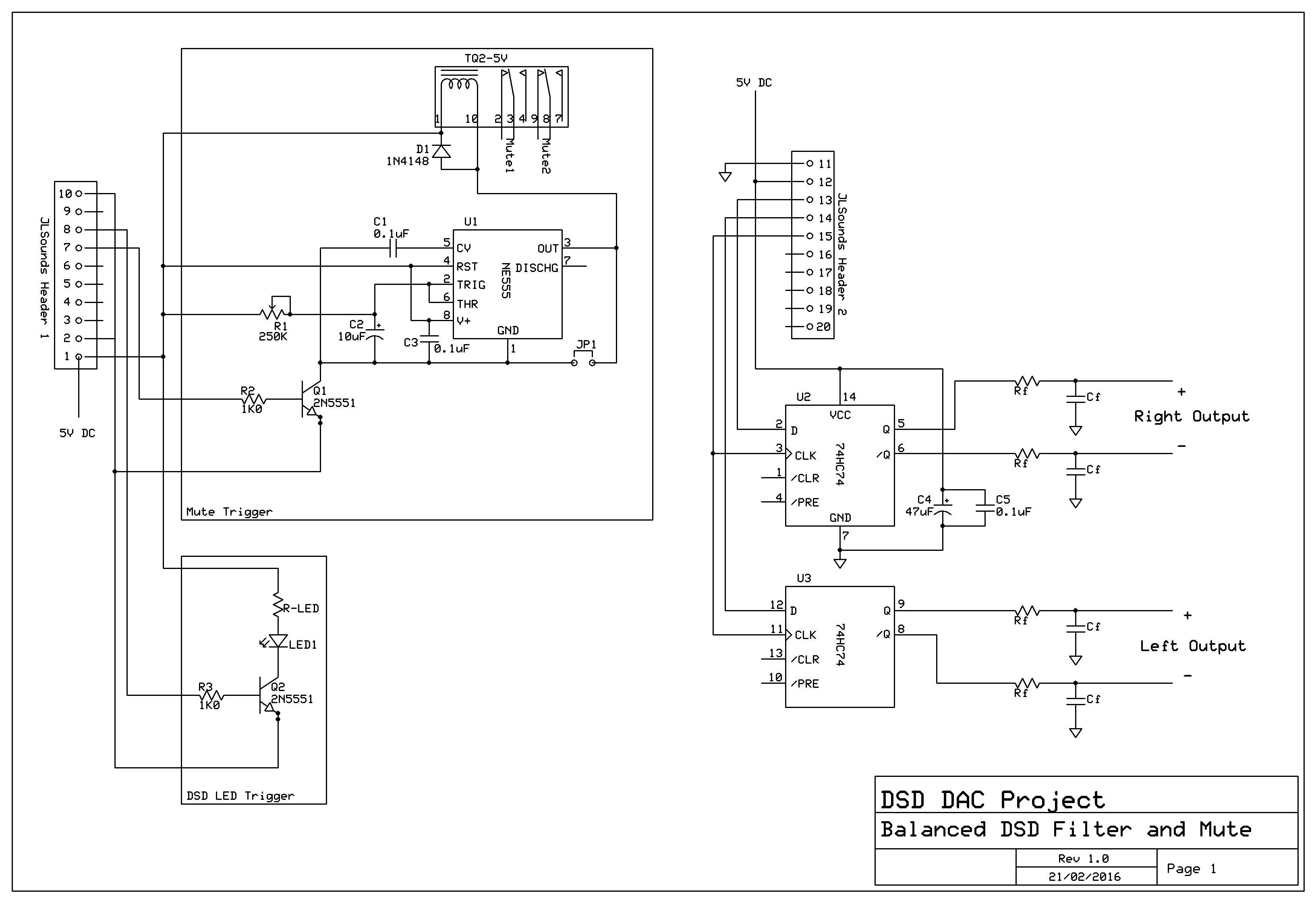

Attached is the latest schematic and BOM for the balanced/flip-flop board.
Note that I have tried to make the PCBs largely self-documenting so they have the part values rather than the part # on the silkscreen.
I need to update the schematic and produce a BOM for the single-ended board; probably in the next day or two. That said, the schematic and BOM will only be different with respect to the filter section; the mute and LED sections are identical to those on the balanced/flip-flop board.

No gift button. Ca I use Pay for goods or service?
Just multiply the amount by 1.05, to cover the fee, and do a normal payment. That'll make the amount £10.45

I am trying to understand the concept. In order to bypass a traditional DAC, one can purchase a JL Sounds USB to I2S board add the SE and flipflop boards described in this thread and playback digital files, cleaner, simpler, better, etc.

I would have said:
In order to bypass a traditional DAC, one can purchase a JL Sounds USB to I2S (or similar) board add the SE or flipflop boards described in this thread and playback DSD data, cleaner, simpler, better, etc. (IMO)
- Digital Line Level
- The Best DAC is no DAC
