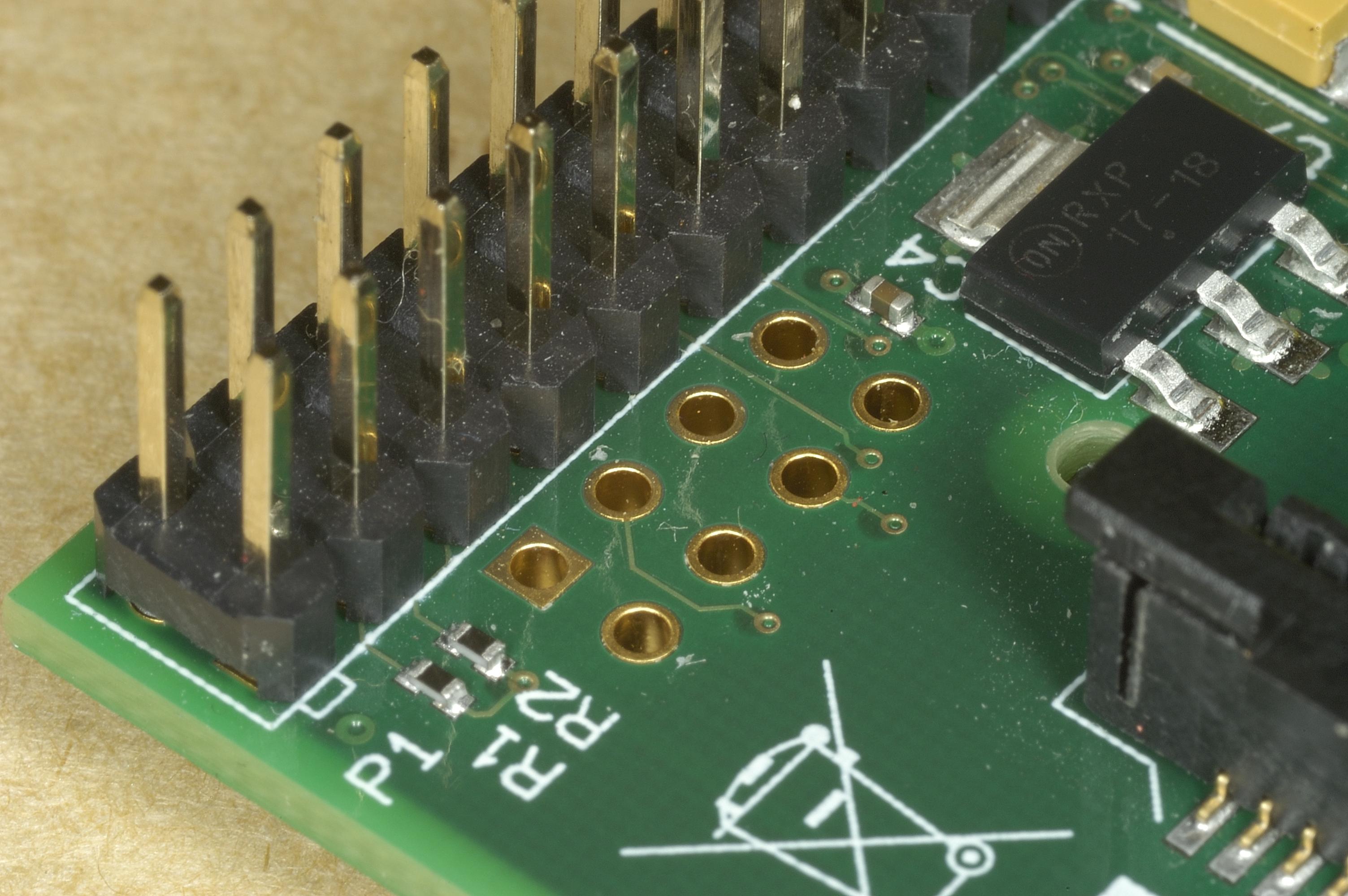

I wondered what that lot was doing... I now see the light🙂 I would connect the two caps to the device gnd pin and then to the switched GND then.
I've revised the board as per marce's suggestions;
Ray
- added a cap at the NE555 Vin
- rerouted tracks to NE555 ground pin
- amended J1 layout so it can use a removable jumper instead of a soldered wire link
Ray
That's better, the things relating to the 555 are close to it especially the GND parts of the loops.

In this day and age of firmware, apps and programming one would nearly forget the not too unimportant item of "mounting holes"......
M3 preferably.
Secondly power connectors better not be at the board edges but that is a matter of taste (and mechanical load). Just chiming in and trying to read the posts. If you add a SMD regulator footprint you could use other PSUs for this board. If I am severely mistaking please let me know. There are quite some posts to read....
Hello Jean-Paul.
No mounting holes required, the boards are specifically designed to mount onto the header pins of the JLSounds I2SoverUSB boards.
There are no power supplies on these boards, you use your choice of regulated supplies, which are mounted off-board.
The boards are very small so difficult to locate the power connectors anywhere else without compromising things; they're located right next to where they're needed.
It is also not legal to solder wires to PCBs directly unless they are mechanically secured.
If you don't tell anyone I won't either 😀
Ray
Yeah I just noticed after reading up and deleted my post. I thought the board would be used separately. Still it would be nice to use standard footprints for 0.100" connectors for muting connections. Soldering wires to boards is asking for peeled off PCB tracks. If connectors are considered taboo then please enlarge the pads somewhat.
There is enough board space to use 2 x SMD low noise 5V regs, thereby eliminating the need for an external sophisticated PSU but just a simple PSU or a PSU with prereg. Less possible stray in garbage too.
It does?
Soldering wires to PCB's is considered "chinese craftsmanship". Melting glue and all. I won't argue anymore as I need to read this thread to catch up.
It would help tremendously if the boards, BOM and design would be in the first post (or a separate thread) ! It is quite hard to catch up now.

Yes that is why european designers should be better 😉 The pads are 0.1" but do the more or less standard Molex KK connectors or similar 0.1" ones fit in the available space physically ? I don't think so.
I would have gone SMD on such a simple and small board to allow for onboard PSUs (read: added versatility). Some GND pads at the bottom of the board could be added to solder a metal GND shield under the PCB to avoid nasties.

Thanks for the feedback and concerns Jean-Paul,
I'm not using Molex KK, just simple headers like the ones in the attached picture, but used in pairs. They've been fine on the previous versions of the boards.
There are many things that might be done differently. I recognise that some people, myself included, aren't comfortable with smd soldering. It's a protoyping exercise and if my approach enables a few more people to try out the no-dac approach to DSD playback then why not. There's nothing to stop the approach being iteratively optimised. So for now I've deliberately kept things simple in line with my experience/knowledge/time.
The bottom of the boards are ground planes.
