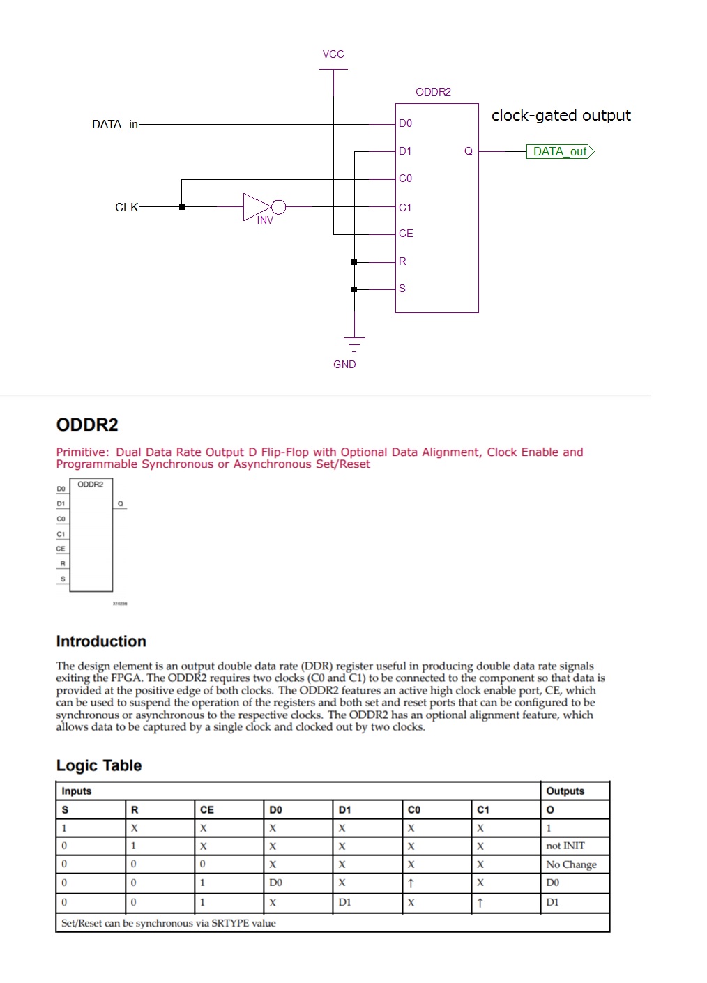

If you want to design RTZ signal in FPGA, "clock gate" is usually inhibited because the clock is dedicated to drive clock input only to ensure low jitter and skew. 100MHz clock with more than 1000 fanouts is ordinary in FPGA design. Instead, double clock rate or DDR FF is used to make RTZ. Double clock (2x100MHz) ends up high power consumption. DDR FF is better for RTZ like the attached pic since the double rate is local.

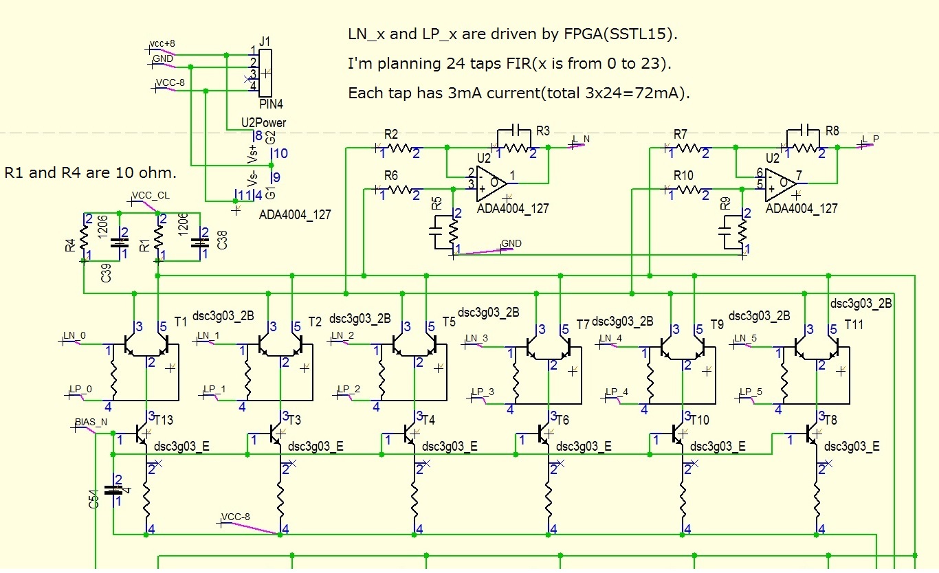

BTW, I'm now designing DA converter(no DAC chip) for 1bit DSM. No DAC topology usually has 0 PSRR, which is the disadvantage of no DAC. I tried ECL logic conversion to have some PSRR before. I wasn't able to have a good result because it had only one tap, and the driver was poor. My current design has 24 taps and a powerful driver, e.g., SSTL15 designed for DDR3(up to 800MHz). My PCM to DSM conversion implemented by FPGA is already finished. The rest to the goal is ideal PA conversion, I would say Pulse to Analog, in 1bit DSM. How about the attached pic?
At first I thought the names of the transistors were automatically generated (DSC version 3, gen 03), but it turns out they're actual transistors. What a coincidence!
I thought about doing something similar to ensure voltage swing as well as having great speed and true current outputs etc. I thought matching of the transistors would be important as well as exact placement and thermal coupling between the parts. Seems really difficult to do well.
What made you abandon the ecl logic, too much noise, distortions...?
