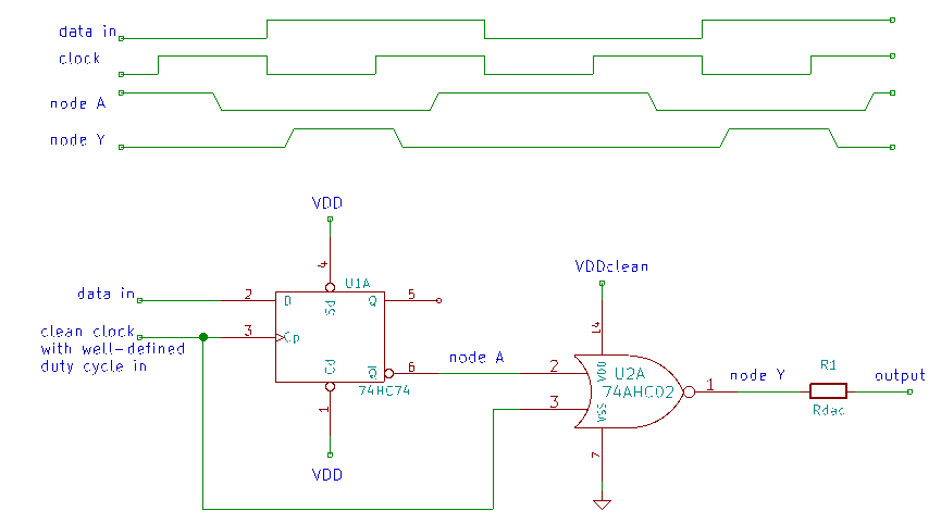

I've drawn a picture to show what I mean. The input data change at the falling clock edge in the drawing, but any position that meets the set-up and hold time requirements would be just as good.
For clarity, I assume a relatively slow flip-flop with about a quarter of a clock cycle of delay and a fast NOR gate. By inspecting the schematic and the timing diagram, you will see that the output transitions of the NOR (node Y) are caused by the clock transitions. The flip-flop output (node A) gates the clock pulses, but does not affect the delay from clock to node Y as long as certain timing constraints are met (*).
Hence, small variations in the flip-flop's delay (flip-flop jitter) don't affect the output. Only the NOR gate's jitter and the clock jitter reach node Y.
(*): That is, the delay must be more than the difference in propagation delays between the NOR gate inputs, and less than the time that the clock pulse is high minus the difference in propagation delays between the NOR gate inputs. In fact, because of possible pattern sensitivity of the NOR gate's delay, it is probably safest if the flip-flop's delay is greater than or equal to the NOR gate's delay and smaller than or equal to the time that the clock is high minus the NOR gate's delay.

This still doesn't make any sense to me. The way logic gates, latches and flip-flops can worsen jitter is by small random variations of their delay (due to noise, supply ripple or whatever). Hence, any delay that is not in the path from clock to output does not worsen the jitter.
If you design your RTZ circuit properly, the clock and the delay of the logic gate determine when the output switches. The data coming from the flip-flop switch at moments when the gate is not sensitive anyway, because the other input determines its output level.

I get it now. Because you are solely depending on the clock signal and assume a NOR can be found (or many are?) that have very low jitter it works as described. Clever way of making use of the delay
Yet this solution makes the circuit depending on the falling edge as well and by that you need a solution that ensures stable duty cycle and the pro of the need for a lower clock is out the window because you gain double the jitter by the addition of jitter of the falling edge.
In the end I can't see it performs better or worse than a FF at double the clock speed, but good to see "there's many ways to get to Rome", as they say ;-)

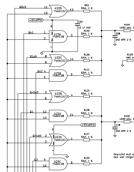

Attached is a fragment of a schematic for a four-tap differential FIRDAC. Note that all the logic gates get the same clock. The corresponding flip-flops (not in the picture) get opposite clocks. The full schematic is here: 74AHC02 and 74AHC08 DAC with 97 dB(A) dynamic range
(I used fairly fast flip-flops because at the 27 MHz clock rate, a 74HC74 could have a delay of more than half the clock cycle. The CD74AC74 seemed nice because it has a larger guaranteed minimum delay than most fast flip-flops.)

Yes, I understood this, but the reality is that the typical propagation delay of a fast FF is 2.2nS (with a min of 800pS) - in fact I find typical values around 1.5nS these days with the NC7SZ74 I use...
Your timing diagrams show a totally unrealistic propagation delay unless the circuits operating in the GHz region (I know you say you use a slow FF, but its not the case of todays FF)...
The danger here is that your NOR Flips on one input and changes state via the second input so both inputs contribute to the output Jitter (point I'm sure your aware off as you used a FF in your simulations with unrealistic PD)- Maybe OK for DIY build, but its not recommended to design a production circuit like this as one could not guarantee stable operation in all conditions, the point is relatching the output removes this uncertainty.
When your operating logic with such tight timing conditions (input transitions occurring close to each in time) the output switching edges are not so well defined as the outputs are in an unstable equilibrium or metastable state - this is seen as worst phase noise.
I don't mean to use the term metastable state as used with a FF where the output could finally end up in an unknown state until it finally happens, but that the output impedance of the switching edge could be somewhere in between states for longer period or could briefly oscillate between states - this will be seen as worst then expected phase noise.
There is such a variance in DIY Builds that its better to avoid asynchronous operation unless delays where introduced into the circuit that would guarantee to avoid such conditions.
With such tight switching periods you also have the issue of Ground bounce, your NOR gate is operating during a period where the Ground is still bouncing around from the FF operation...
Maybe I'm just being too perfect, but I can guarantee that you will not reach measured high performance operating like this (and for sure why so many projects have such relatively poor noise performance). With care its possible to reach Dynamic range figures of 130dB+ (DSD256) but not working like this...

RTZ indeed has the disadvantage of increased sensitivity to jitter and when you implement it like I do, sensitivity to duty cycle variations.
You can largely get rid of the increased sensitivity to jitter and the duty cycle dependence by making a FIRDAC with an even number of taps working on opposite edges, always using equal weights for a pair of unit DACs. Simplest example: one RTZ DAC that produces a pulse when clock = 0 and one that produces a pulse when clock = 1, outputs added with equal weights.
I wanted to say that with just a NOR circuit in the ADC you are not correctly encoding "DSD data" - this in itself will introduce an error - the Zero Data and RTZ period are Zero... your complementary NOR / AND approach correctly decodes the data (but with my concerns surrounding the phase noise).
If your OK, I'd rearrange your ADC Front-end and DAC section to be truly balanced 🙂 it be interesting to see how your NS then perform...
74AC logic is a great logic family - I'm sure just swapping the HC logic in your designs with AC will yield a SNR / THD improvement - but I strongly recommend that you try UHS TinyLogic which is the best logic family I've worked with todate (better performance then even PECL).
Could you make a drawing? I don't understand what you mean from this description.
I haven't really got an application for the ADC, so I have no intention of rearranging it. If you or anyone else would want to try a balanced version, you/they can go ahead, of course. The KiCAD database is included in the ADC's thread.
I've mainly used AHC logic rather than HC logic. Thanks for recommending UHS TinyLogic!
The timing diagrams just illustrate the concept and have no time scale, so how on Earth do you know whether they are realistic and why would it matter in the first place?
I understand the idea but for the concept to work correctly WITHOUT impacting the phase noise relies upon unrealistic PD delays - delays that in reality with today's fast logic and our DSD clock rates (as I say typical AC / UHS logic PD are in the 1-3ns - this delay does not place the clock conveniently almost 90deg away)...
My point is that the idealized timing diagram its not whats happening with the circuit in reality - and this is the important consideration.
Its clear that we are sadly running around in circles here 🙂
Nor does it need to be 90 degrees away, the actual requirements are in the footnote rather than the diagram. You can use a slower logic family for the flip-flop than for the NOR gate, and the path from the clock to the NOR gate is inherently shorter than the path from the clock via the flip-flop to the NOR gate.

These need to meet higher standards than "just" digital systems because any change in quantity or quality means a direct impact on the delivered analog performance.
Another way of looking at dsd dacs is to see them as a clock signal that is being manipulated to get low frequency data out of modulation of HF signals.
Jitter requirements, phase noise, amplitude and low power are excellent when cmos is used knowledgable.
