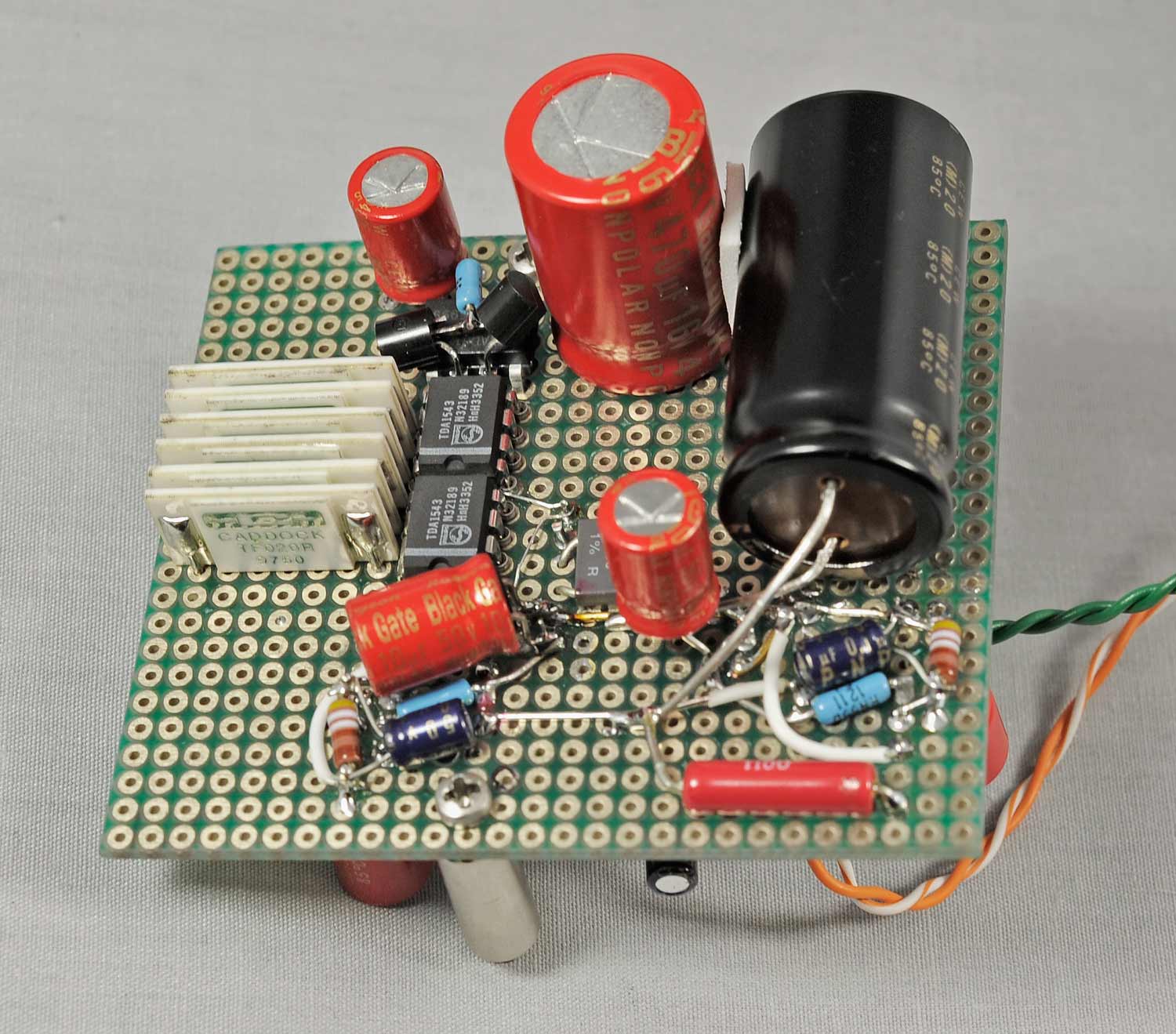

I really like you way of making P2P. I've made some projects P2P, including an OPA2134 based preamp.

Didn't really end up; I never finished that amp. It was more of an exercise in introduction to p2p wiring. I later built Aleph 5 this way though: http://www.diyaudio.com/forums/pass-labs/4018-more-beauty-p2p-wiring.html

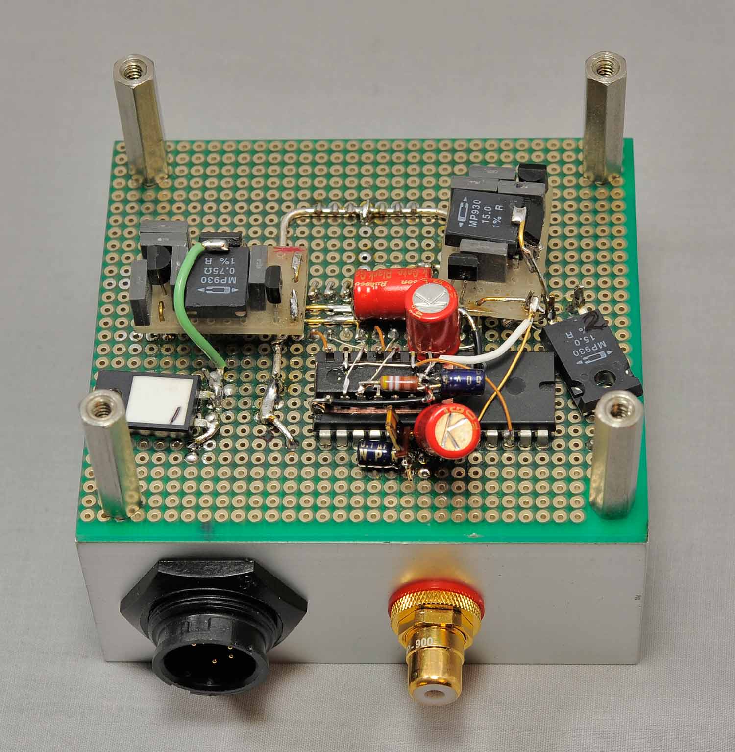

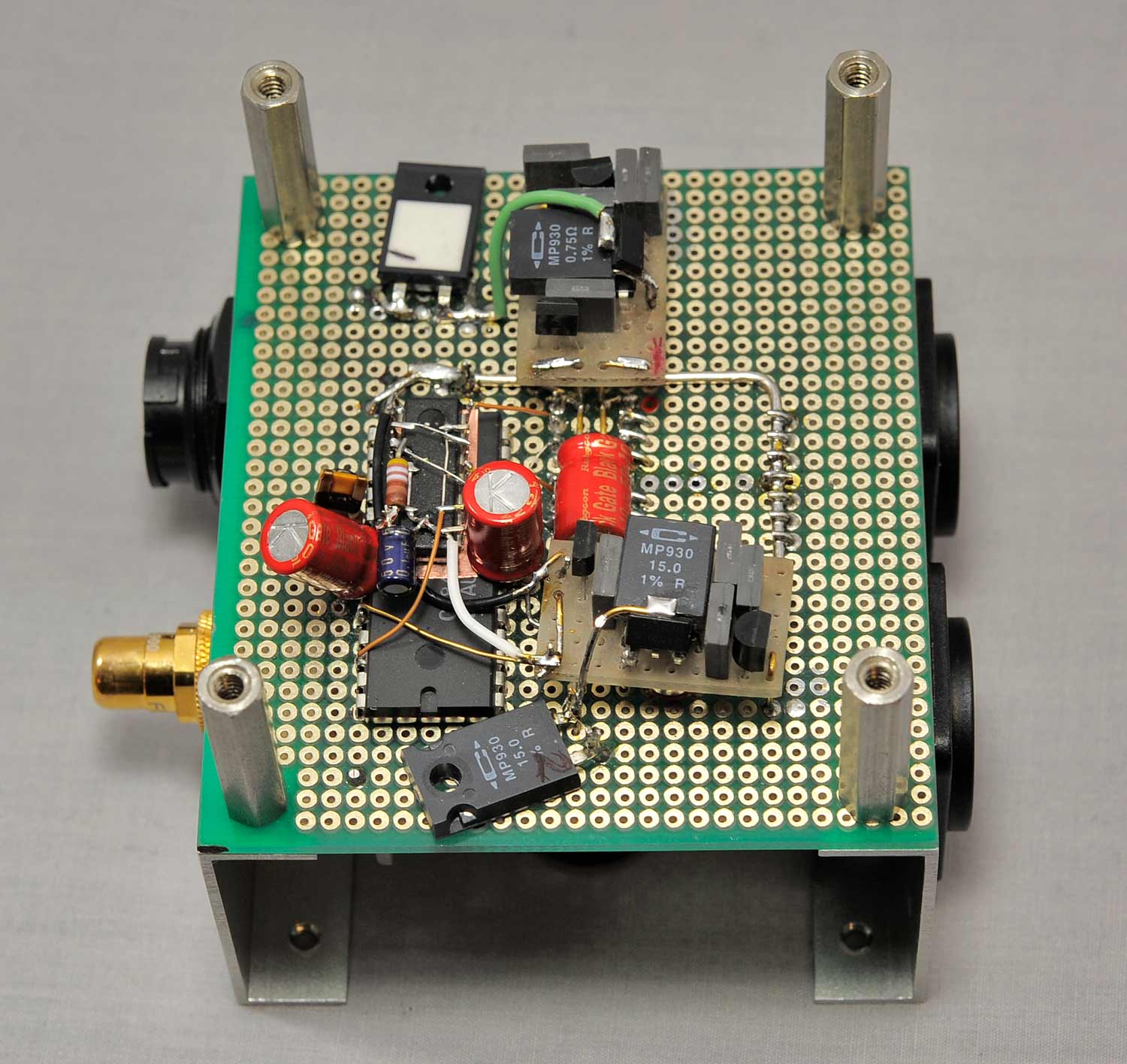

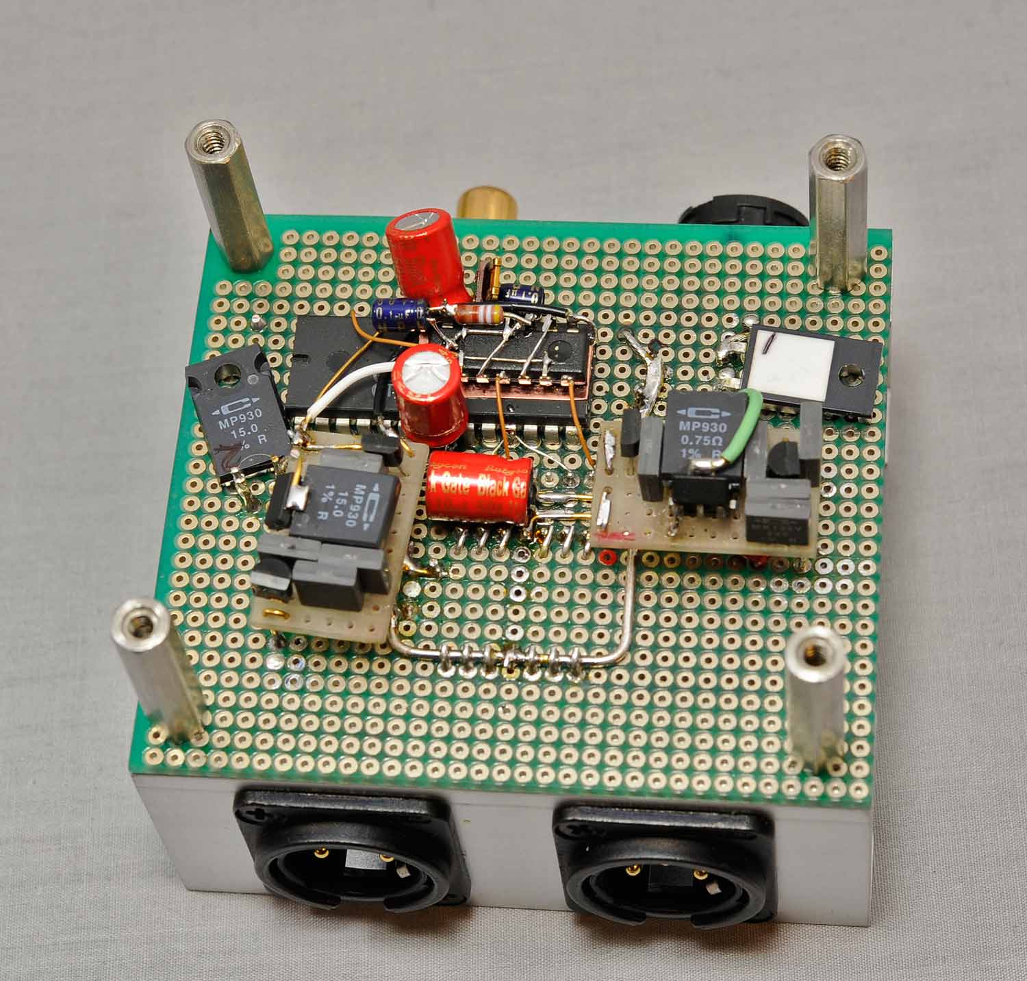

Recently, I've built few DACs using p2p method and I'm very satisfied with the results, in fact this is my best effort yet 😉

What an effort to assemble those dacs, I like'em alot. The messier it look the best it tends to sound 😀

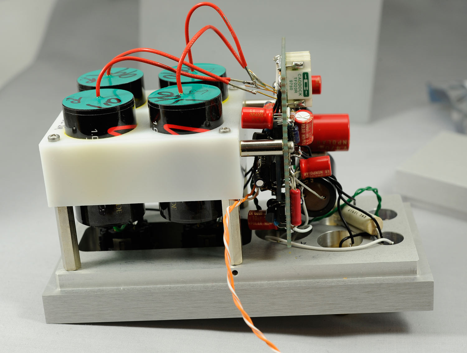

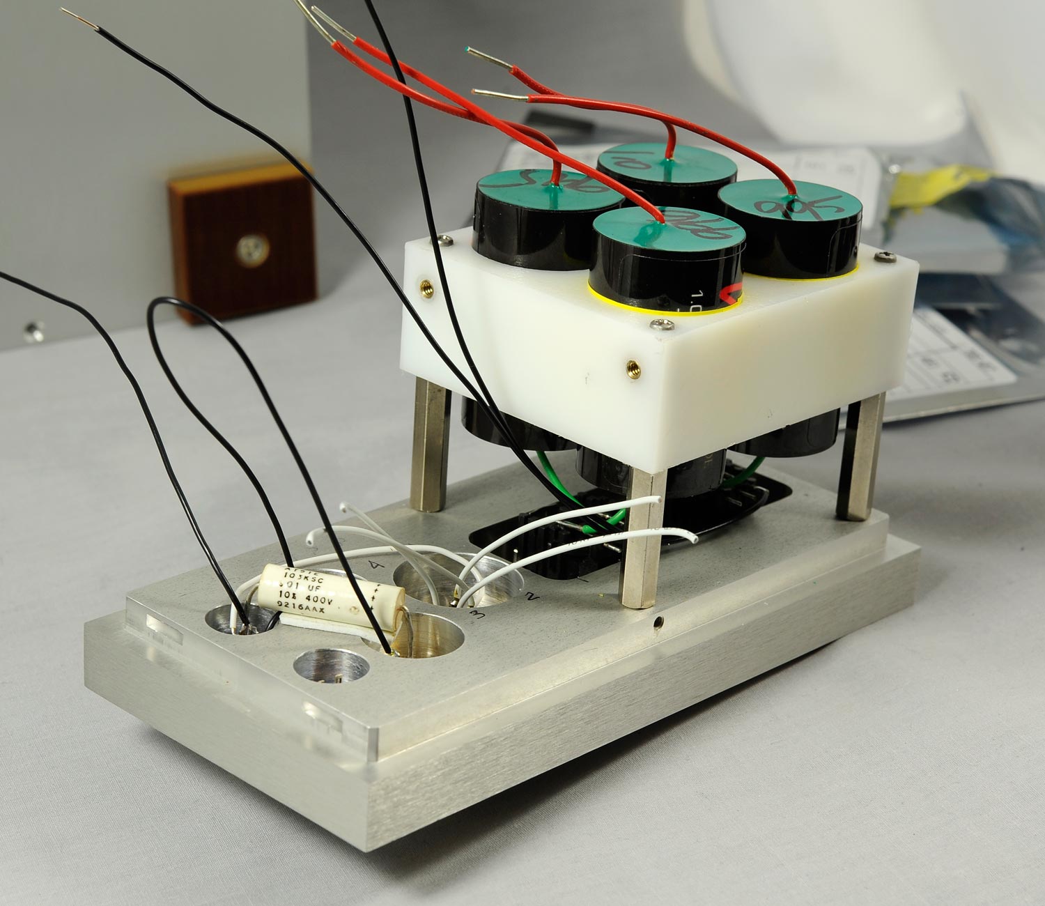

Peter, you have (brass?) threaded inserts in your nylon block, are these screwed into the nylon or do they need an arbor press or some other tool? I'm trying to find similar items that I could insert with my limited workshop.
Steve
Steve

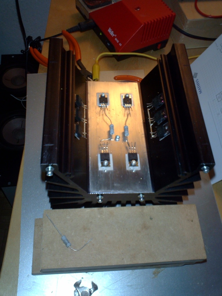

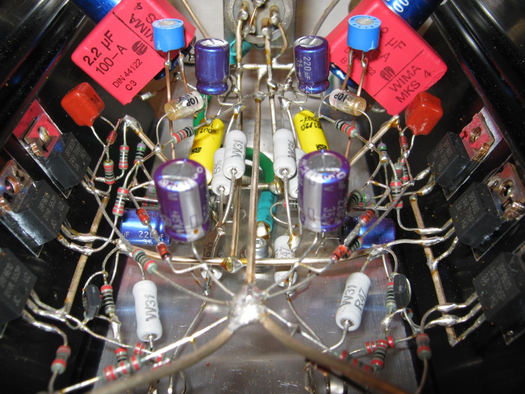

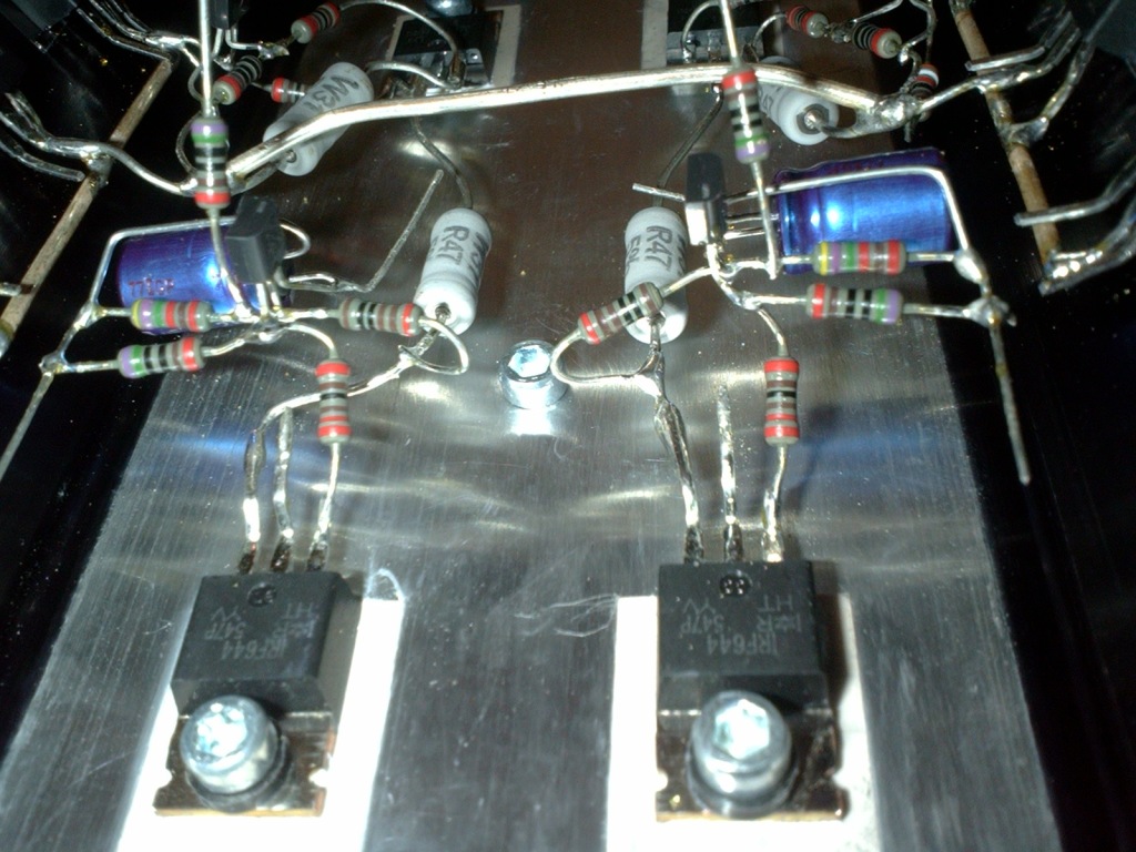

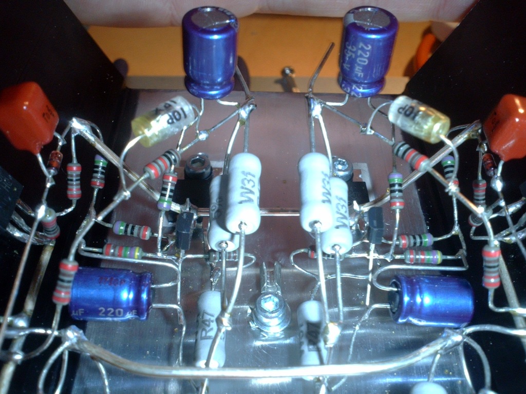

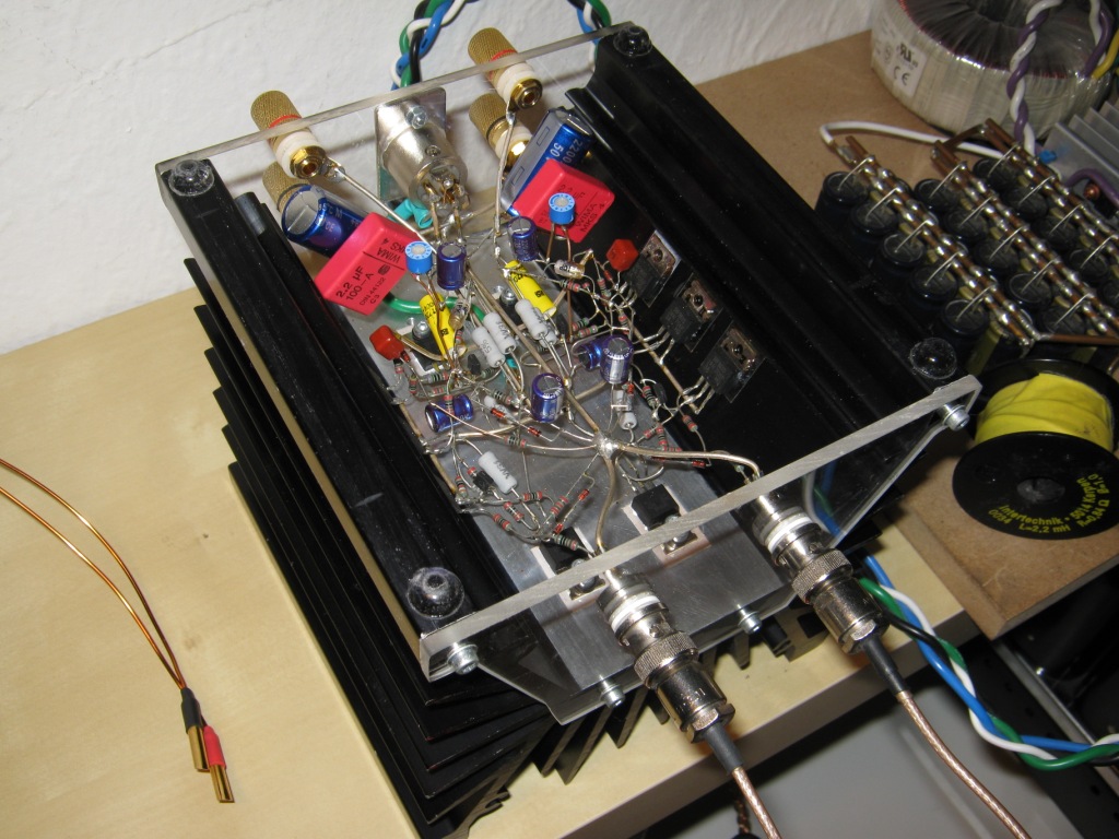

Kind of an old hat, but anyway, here's my p2p Mini Aleph built inside a heatsink (15cm wide/high/deep). Toasty.
And mind you, I built this using lead-free solder (99% Zn and 1% Cu).
In the 5th picture you'll notice that the Zener is facing in the wrong direction. That cost me quite some nerves. And yes, the IRF9610's are mounted with superglue. 😀
very cool - that's something I like - design for yourself, as the master speaks...
reminds me of some of my own amps, although a gainclone is much more easy in p2p
btw, how does it sound?

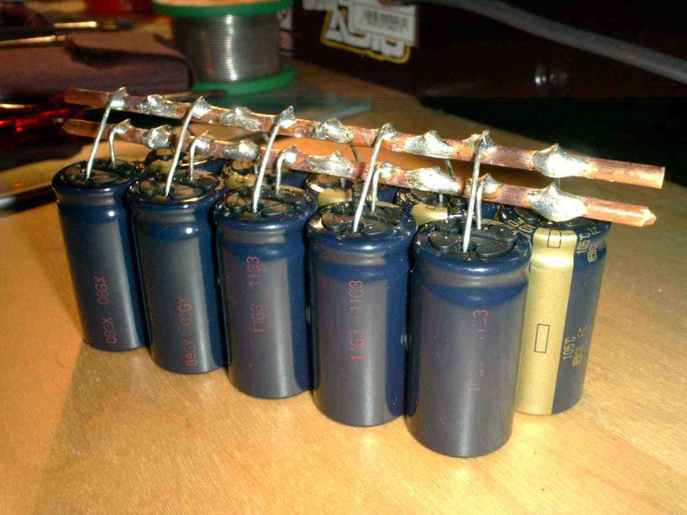

As in post 64, I had the idea of using a plastic as a capacitor frame. I bought some nylon block and found it surprisingly unhappy about my drilling (smoke, etc). My question is whether I should persist with Nylon, or try and find an easier to work plastic? The ebay shop where I got my nylon block also offers polyethylene, polypropylene, ptfe and others. Any suggestions would be most welcome
Very sweet. I'm feeding FE108EZ horns with it. The bass lacks some control that a LM3886 with regulated supply could offer, but the Mini-Aleph's midrange sweetness is unique. At least to my ears.
Be careful with ptfe, fumes and smoke from ptfe can be can be highly toxic and corrosive. I imagine machining polypropylene is not wildly different from nylon, but I'm no expert with these materials. You can find many article on machining polypropylene though, and it seems to be quite cheap.
Use some liquid coolant to keep the plastic's temperature down when machining. Alcohol (Isopropanol) or even water should do the trick. Stay away from acetone, it dissolves many plastics. Polyethylene is resistant to actone though, that's why the squeeze bottles are usually made of it.
