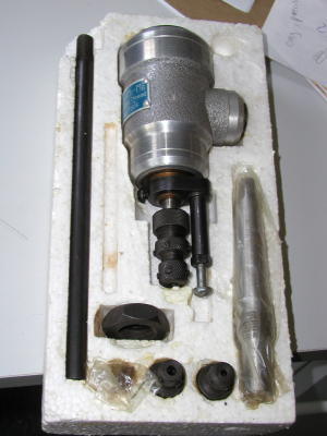

Nednai said:
I’d recommend using a self-reversing Tapmatic with a drill press instead of a drill gun with a clutch. I’d even suggest using drill guides with a drill press instead of drill guides and a drill gun.
Quick search on Tapmatic tools shows following link: http://www.penntoolco.com/catalog/products/54.cfm
The cheapest self-reversing head cost $360. Even my needs for drilling and tapping wouldn't justify that expense. As to flea markets my search didn't bring any results. However Mr. Nednai, I would be glad to buy a used one from you and check it again. Maybe the one I was using initially was defective.
More Tapmatic comments
Since you were so persistant with your Tapmatic I made an effort and found the tool I was using for tapping. While it's not exactly Tapmatic, the price was different as well. I paid CAD$150, used it once and never tried it again. The biggest problem I found about it was that when tapping small holes in aluminum it did not go into reverse and was breaking taps. It was happening probably because there was no torque adjustement.
The other and probably main reason for not using that kind of tool is that YOU ACTUALLY need two drill presses. As you can see that this tool has to be mounted on a drill press in place of a chuck, which means permanent installation. The way I work on my press is that I like to drill some holes, then tap them, put the parts together, mark more holes, drill them and then tap again and this is how it goes. With that kind of installation you either use your drill press for drilling or for tapping. I understand that Tapmatic mounts in similar way, at least for the price they ask it should.
I can only suspect that somebody using similar tool for the first time would experience more trouble than gain. Cordless drill gun is one most popular tool in home use. If used for tapping with a tap guide it can work marvels.
PS. Mr. Nednai, please remember about my challenge and present us with an easy solution to drill those holes at the ends of the rod. Enough time wasted for talk about Tapmatic.
