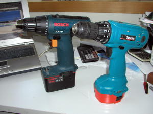

Nednai said:I’d recommend using a self-reversing Tapmatic with a drill press instead of a drill gun with a clutch. I’d even suggest using drill guides with a drill press instead of drill guides and a drill gun.
I tried Tapmatic with drill press and I will never use it again on heat sinks and small amplifier parts. Forget about that thing when tapping 7/64" holes. You don't need drill guides when using drill press. When your part is on the table the drill is always aligned properly. Drill guides blocks are designed to be used with hand drill guns. If you never tried cordless drill gun with a clutch for tapping I recommend you try. You will not believe the results and forget about Tapmatic.😱
... a clutch for tapping ...
Peter: I know I've seen your pictures and description of clutch for cordless drill for tapping purposes. Can I get the clutch that you mentioned from Home Depot? Part #? Is there different sizes? Thanks.

Re: ... a clutch for tapping ...
This is what I'm talking about. Both those pistols are available from Home Depot and they have build in clutches. I don't think you can get a clutch separately. For construction work I prefer Makita, for fine metal work on amplifiers I chose Bosch, 12 V should be enough. And don't listen to people who tell you that Tapmatic tool is better.🙂
fcel said:Peter: I know I've seen your pictures and description of clutch for cordless drill for tapping purposes. Can I get the clutch that you mentioned from Home Depot? Part #? Is there different sizes? Thanks.
But remember use a drill guide. You can make one out of two plates connected with spacers and dilled through on a drill press ( as you can see on my previous picture).

Those heat sinks are huge compared to the small parts I had to tap using a Tapmatic. We always used a clamped drill guide and a drill press. Without a mill, it was the quickest, easiest way to get accurate drilled holes, which was required to get FAA certification. After drilling/tapping 10’s of thousands of holes using drill guns and drill presses, I’m surprised you had difficulty with a press, even at 7/64”. I guess the ease came with experience.
Whenever possible I always use press drill to drill holes. Even size 70 drill doesn't present any problem. I never use clamps and guides on drill press because I'm not required FAA certification and it slows my work. When not using drill guides, clamp is actually not recommended because without it a drill centers better on a piece you are drilling.
Remember that we are talking here about DIY and most of the people don't have access to Tapmatic and drill press. Even mine is only 8" and some of the holes on that big heat sink I couldn't drill on drill press. The only alternative is using hand drill (alhough for that purpose I don't recommend cordless one because the speed is too slow, use electric one) and a guiding block I showed in a picture before. Most of the people don't have access to commercial ones but one can be easily made as I also show in a picture as well.
I tried Tapmatic before and didn't like it. Used to tap everything by hand. Just recently tried to use a cordless drill and I am surprised with results. And it also much faster. Ever tried tapping M2 on Tapmatic?
Actually, you clamp the guide to the piece you’re drilling. I didn’t notice any built in clamp on your guides. When a guide costs $10-15, why make one at home? As for certification, I’ve never known an FAA certified driller/tapper. It’s the parts that get certified. M2 on a Tapmatic? No problem. When a press&Tapmatic costs less than a new Weller, why not have them? Easy, precise, fast, who would want less?
When you use hand drill do you also clamp the guide to the piece you are drilling? Because you really don't have to. I'm using mine on aircrafts and it's impossible to clamp them to the skin. That's why you don't see them on my guides.
Would you mind leting everybody know where those cheap guides can be obtained? I guess they might be handy for everybody drilling holes in heatsinks.
I also don't understand your argument. I presented here something very simple and it works so why make it more complicated?
