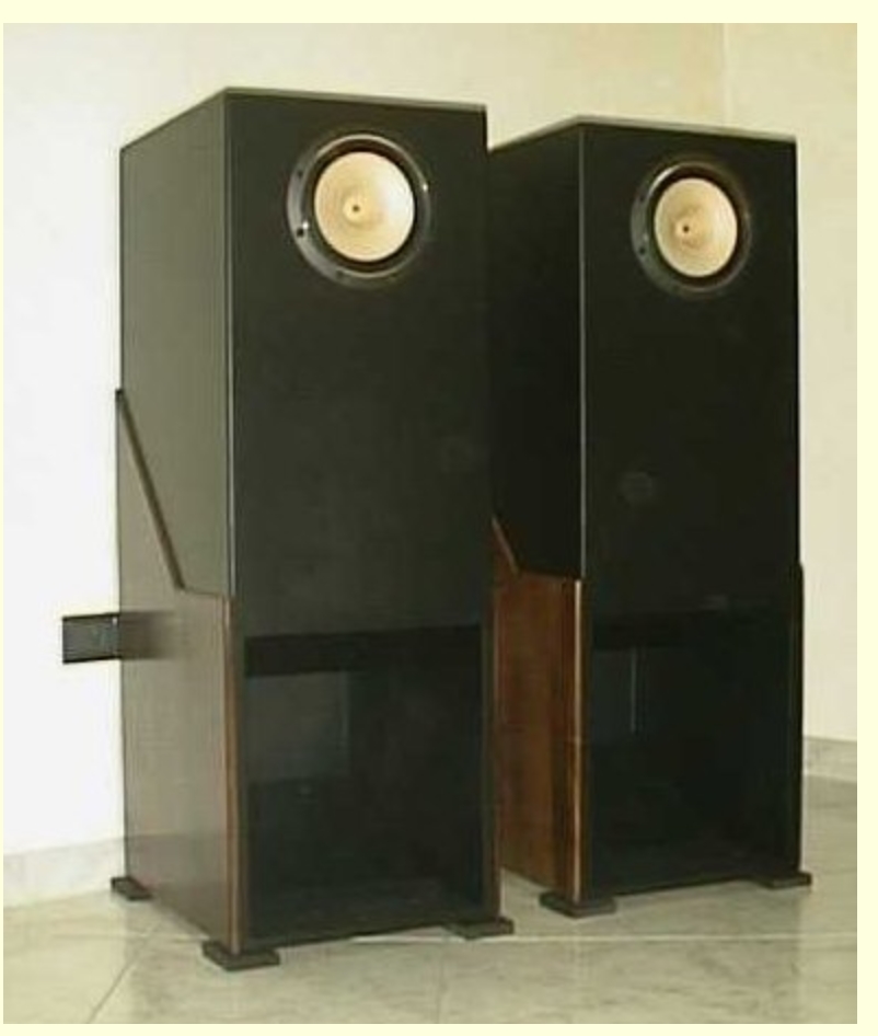

Seeker could be damn lucky bztrd from first (base? :rofl: ) if clever enough to mate that amplification with huge enough and sensitive enough speakers
beware , sensitive and efficient can be the same , but more often it isn't
both Altec 511 and modern JBL are efficient 15" drivers , but 511 is way more sensitive than other one...

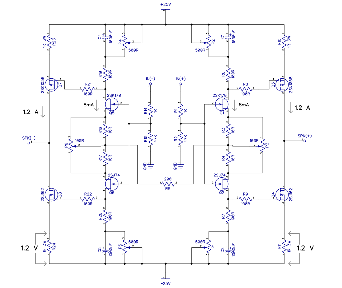

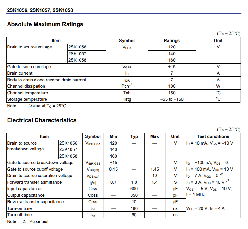

hello,
can we make this ba3 preamp into an amplifier using 2sk1058 2sj162 device
simply by changing the value of some parts and increase the bias current?
biased at 1.2A 25v 30watt, device Pd rated max 100watt.
:rolleyes:
please advice.
thanks.
