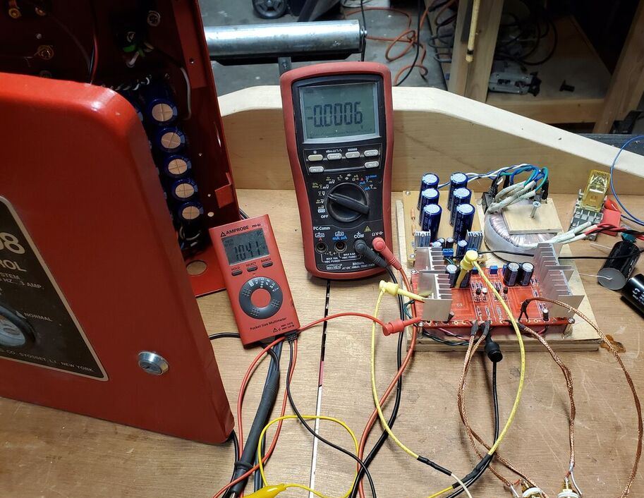

Thanks to you all another BA3 pre comes to life. I havent posted in quite some time but I've been following DIY Audio and particularly the Pass Labs forum and slowly but surely some of this is sinking in...
Thank you Mr. Pass, those of you who selflessly share your knowledge and experience and those who ask all of the questions before I need to. I'm amazed by the depth here.
So, anyway, I've had this board populated for a couple of years and just got around to putting a power supply together and getting on with it.
This build uses the fqp parts, 1k pots and the silmic 10uf caps. I may play with bypassing the silmic and later trying an MKP-fC 10uf but I'm plenty happy for now. I've been playing with a couple F5 channels so the biasing setup was familiar and painless. An Antek 0222 transformer pushes a homespun 317/337 supply outputting 25v. The regs run cooler than anticipated as do the qfets. Of course my shop is sitting at about 60deg F...
Now on to some casework and finishing the F5.
Cheers y'all

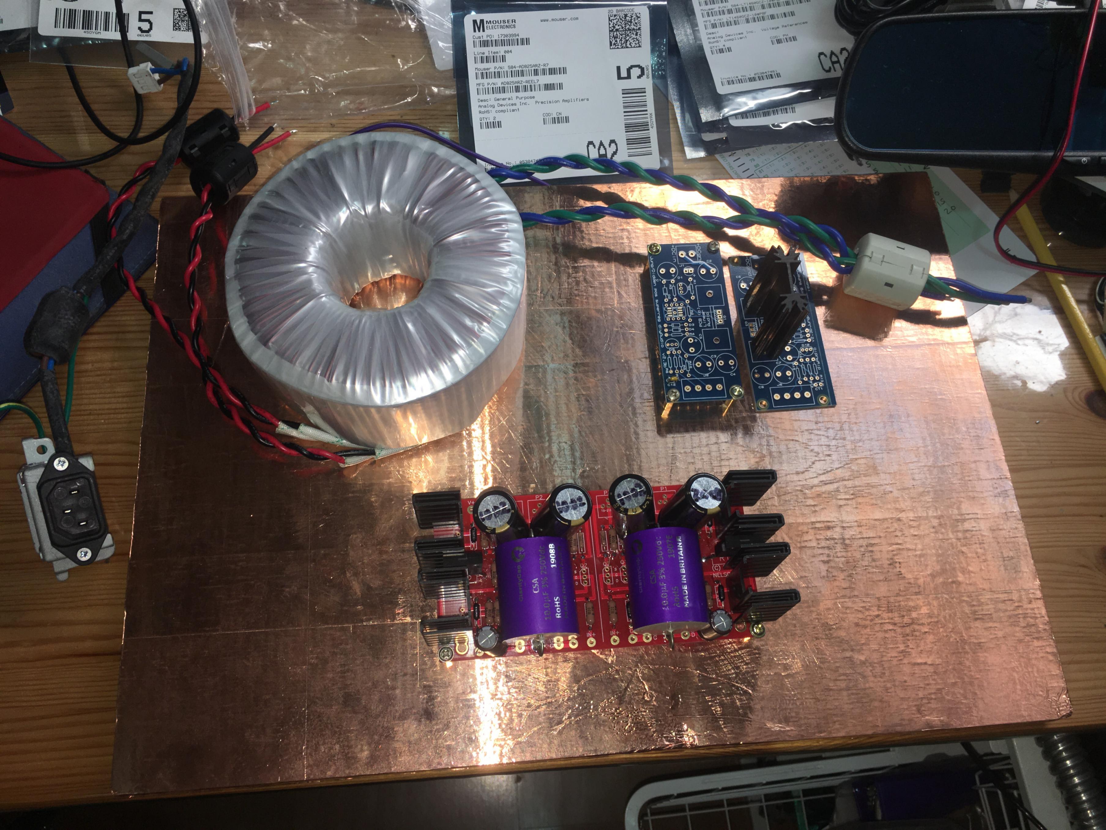

I think I made a mistake misunderstanding of the Super Reg
I believe I made a mistake looking back at the beginning of this thread at the photos was not the linear superregulator by Jan Didden. I guess I was not supposed to break the boards in half, though not crucial.
Got a little confused looking at the photo of one singular power board in the build guide on the first page . So without remembering what I read in between the photos that the board in the photos was another manufacture.

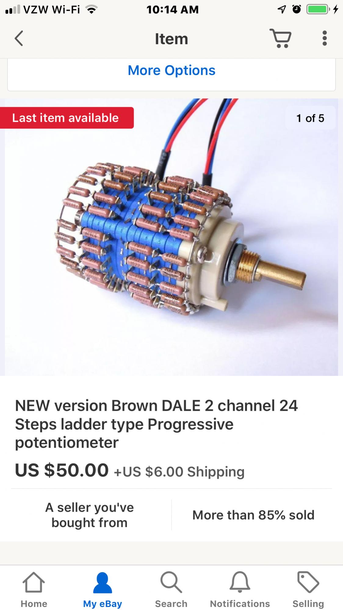

My question I did order one of the eBay attenuators because I just could not right now stomach the expense of the (Goldpoint). The photo attached is this the correct attenuator ?.

The attenuator is correct, but you don't show the value in your screenshot. Should be 10-50K, 25K probably preferable.

Opps, the SuperReg PSU needs A separate DC Supply ? Ouch!!!
Getting closer but ran into one small obstacle to overcome, other than waiting for the unobtainium fets to come into stock at DIY store.
On the first page of this thread just under the schematic. First paragraph stating the use of a “317\337 linear regulator power supply from Tubecad.com (Model PS-12)”.
Then make a note that you can use the super regulator in the DIY audio store and I took this route because I only wanted to make as few orders with as few companies as possible.
Now that I have all my parts and started populating I just noticed on the super regulator boards it says (DC in) !!!. Jumping back to the first page I took a closer detailed look at the glassware power supply noticed it had diode‘s for rectifying on the same board.
The super regulators do not. Since I want to stay with a somewhat clean professional look instead of me making up a tiny full bridge rectifier Out of perff board. Can somebody recommend me a premade circuit board to give me the correct reference DC V to the superReg boards.
Now I see why you would choose the glassware all in one solution easier and much cheaper.
