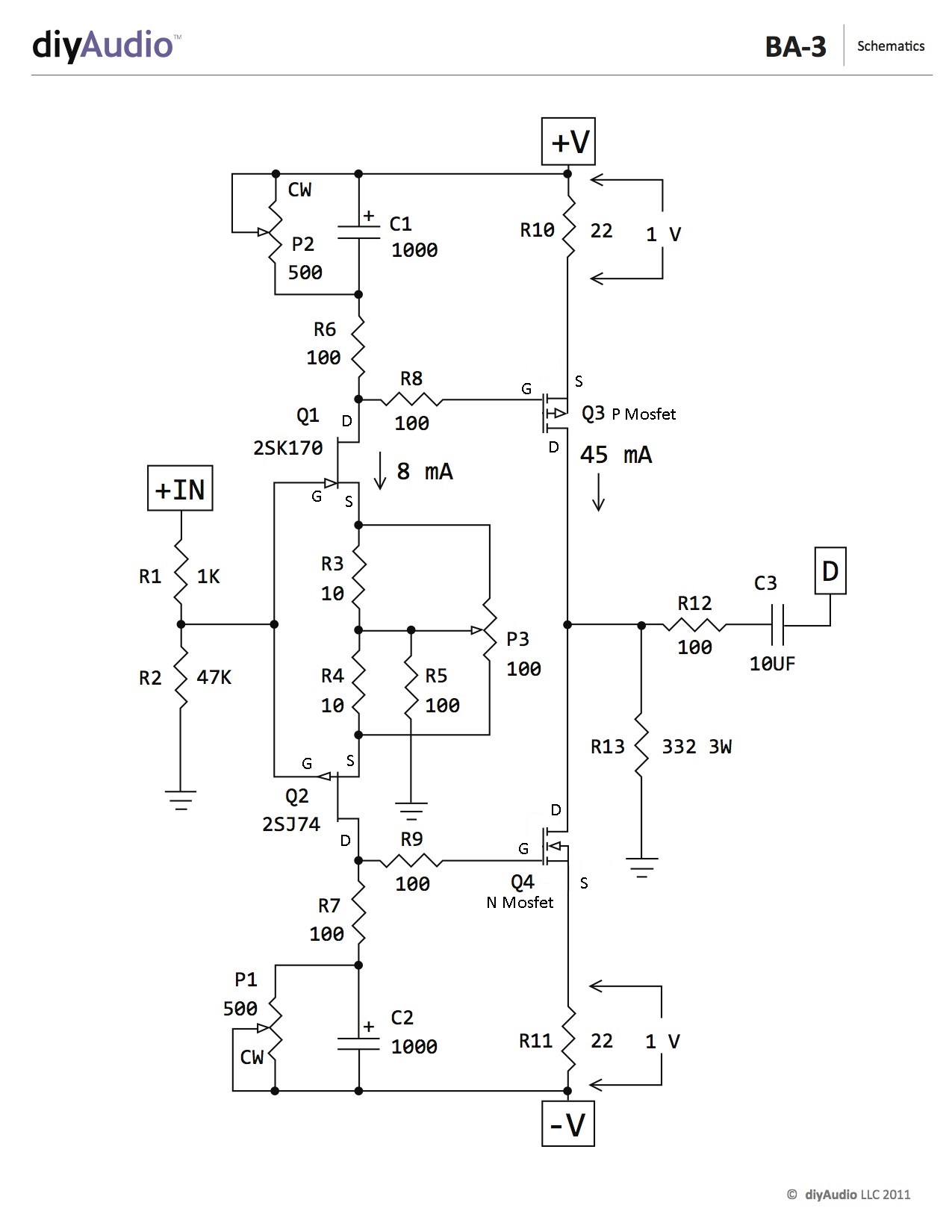

What determines the size of the output decoupling capacitor?
I'm looking at building a "beefed up" BA-3 preamp with a cascode for the JFETs and current mirrors between the JFET stage and the MOSFETs.
The HPA-1 is similar and appears it uses 100uF at the output (whereas the BA-3 uses 10uF). What are the factors that feed into the choice of values here? (Disregarding cost, space, etc. I'm just trying to understand the electrical side of it.)

It depends of the load. E.g. if it is 10kohm or 8ohm load. It defines the lower cut off frequency of the "high pass" filter that is formed by the C (output cap) and the R (load) …..assumed it is almost an "ohmic" load.

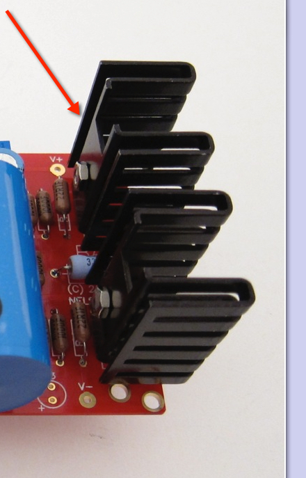

Finding it hard to source these Heatsinks, I know I can use alternatives, however I like the compactness of these. Does anyone have a link to purchase these? Thanks.
Looks like Aavid 7020 series. Available from Digi-Key. PN 7020B-MTG.
I bought 7020s for mine and they don’t fit great, rather go for these
551002B00000G Aavid, Thermal Division of Boyd Corporation | Fans, Thermal Management | DigiKey

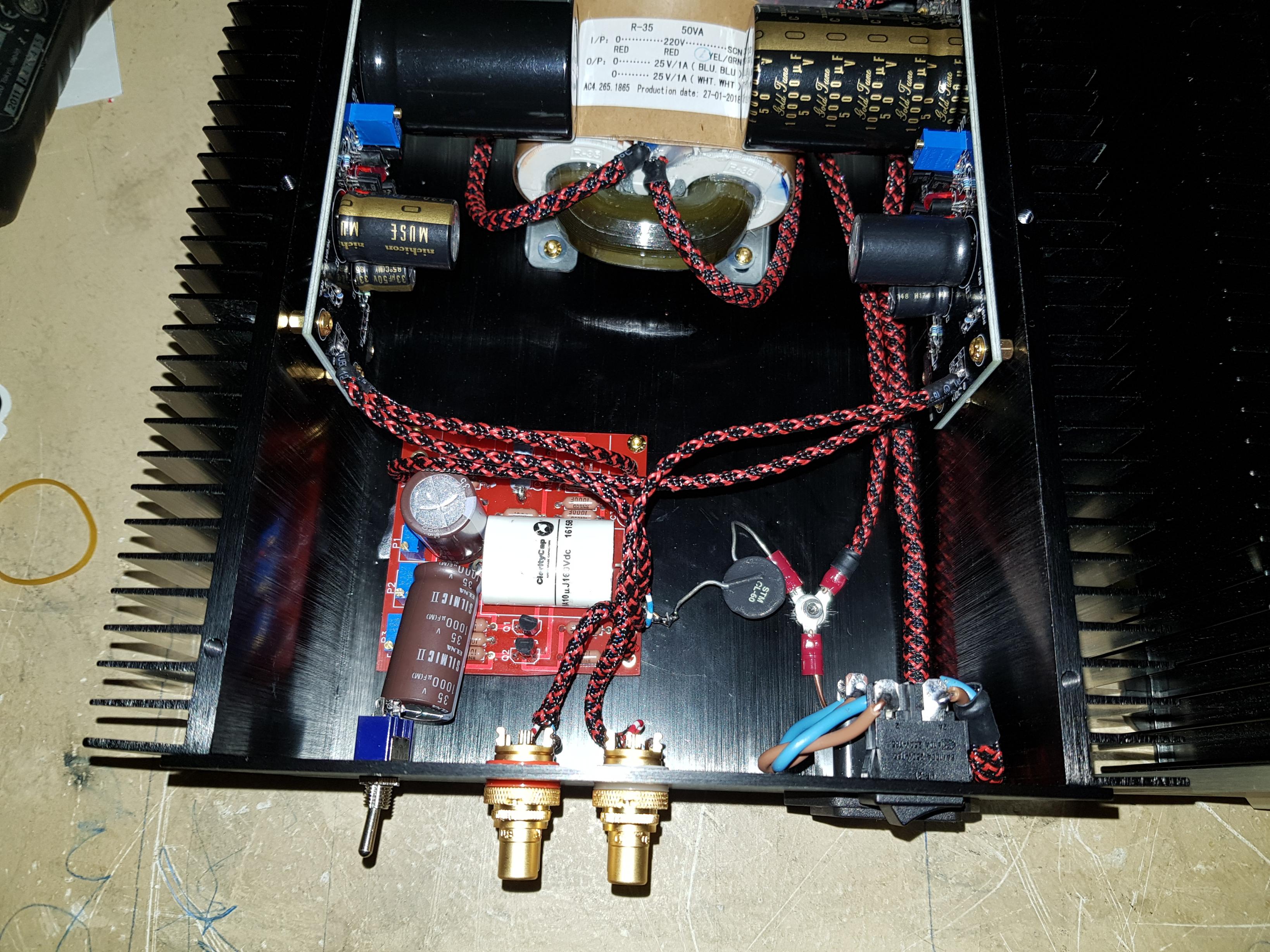

Built my dual mono front end/pre and it sounds really good adding a little life into the chain.
Putting it between a passive volume control/source selector will give a flexible setup.
There is only one annoyance, it's adding hiss like an old tube preamp.
Based on others here, it should be dead quiet when input shorted and going into an F6 or M2 - here it is in neither.
The hiss is annoyingly loud at 1m from my 99db speakers. Not that much at the listening seat, but enough to kill the experience. My DCG3 pre does not make a sound in the same chain.
My build is standard parts after the BOM/schematics, board from the store and Fairchild mosfets with 1K pots in P1/P2. PSU is dual mono Salas SSLV1.3 shunts giving the BA3 front end dead on +-24V. Bias and offset seems fine.
Both channels produce exactly the same hiss.
Tried paralell 330ohms to R13 and 100ohms series to R5 after reading here, thinking it would be too much gain. That solved nothing.
Anyone clever?

I had the same dual mono BA3s and it added just a little hiss, because of having way too much gain. If I see this build and the modifications you tried, i think you do everything right.
Don´t know why there is so much hiss. Try the volume control in front of the BA3 and after the BA3?

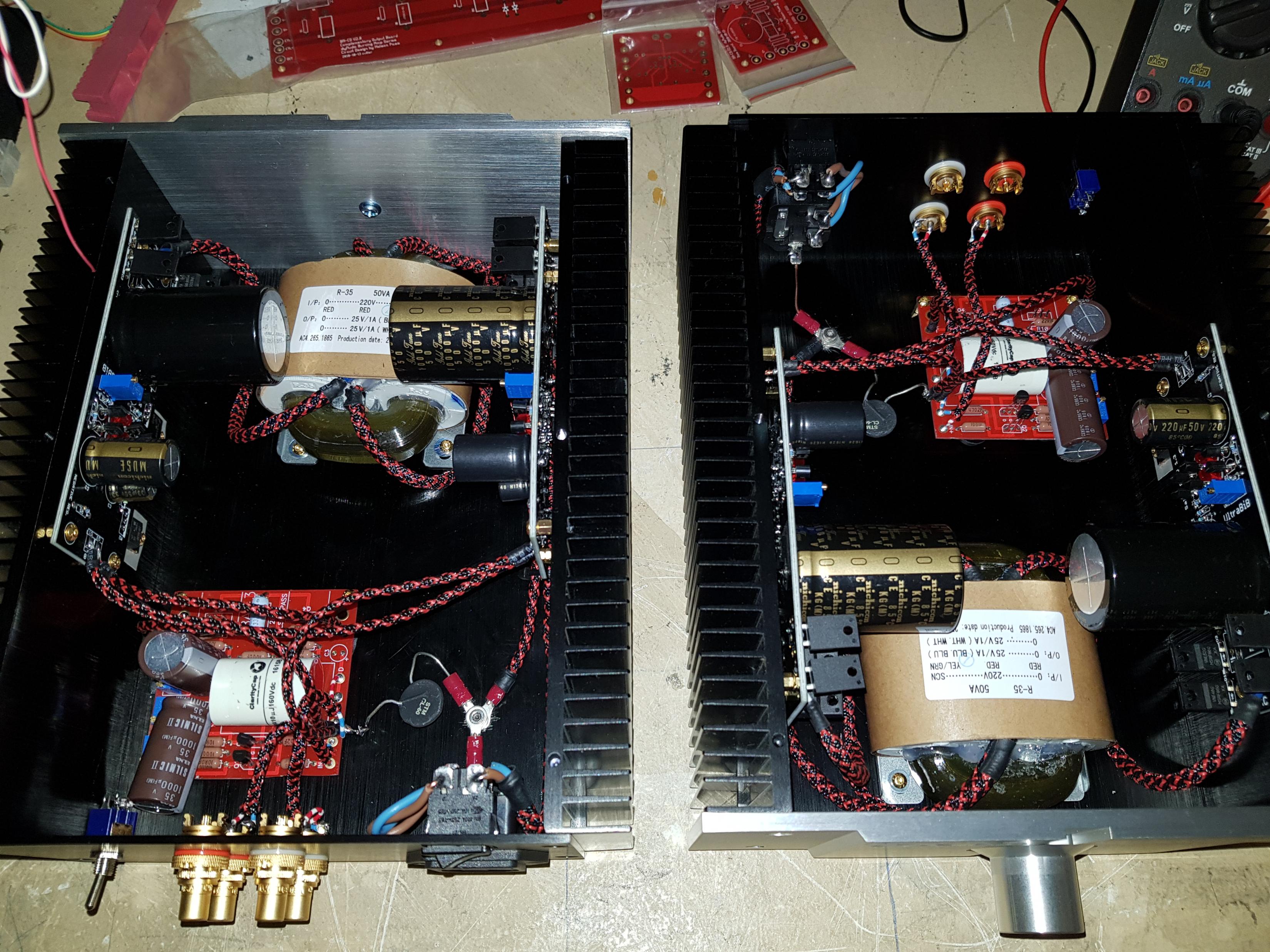

Thanks! I will give it a try!just for fun , try one channel with basic 7824/7924 reg , to isolate problem - is it in regs or in active stage
Or maybe put up a standard CRC psu - as I have the parts without looking through every box. Should't be too noisy?

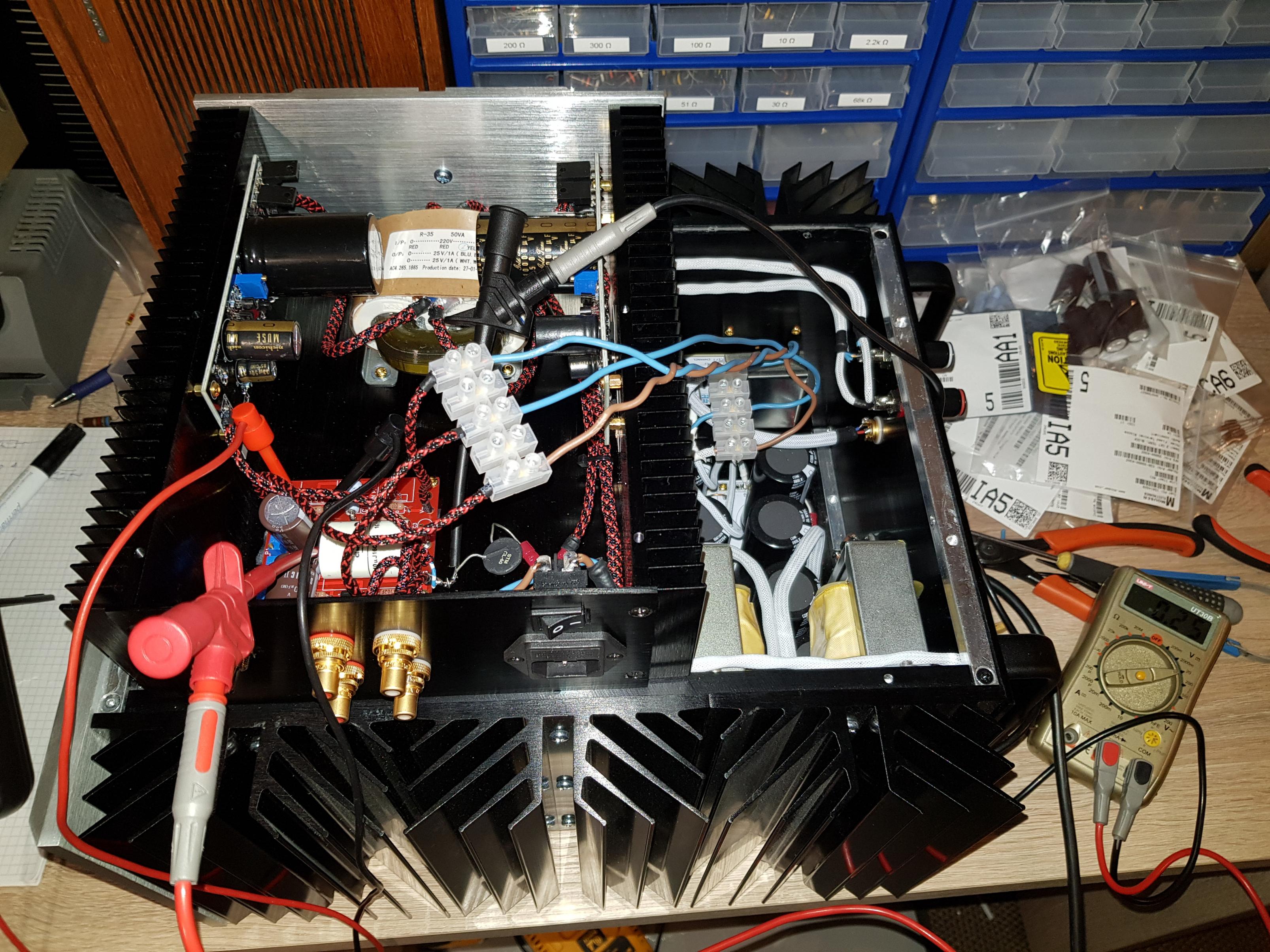

Just made a mess of one of my M2 blocks(easiest access), giving the pre a psu with enough capacitance to last a couple of tracks
I let it warm up a little and did proper adjustments.
But the hiss is still there.
Atleast now I know its not the inhouse power
