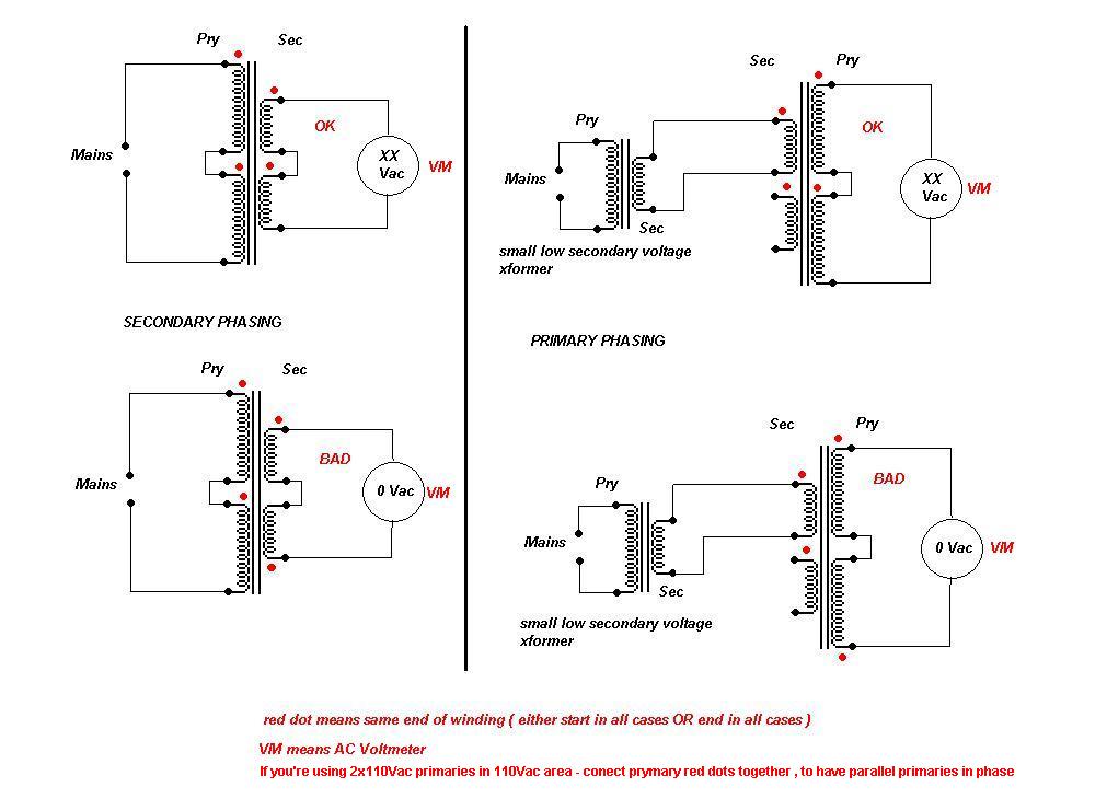

- In the original post of this thread, i notice you (6L6) tie the center taps of the secondaries to ground on the regulator. Is finding the correct ones just a matter of tying to together and checking whether the remaining give 40V or 0V?

- see attachment and think a little

regarding xformer - , when you have two windings , which you want to make one center-tapped from , there are really just two successful options ( and two wrong ones)
choose right one , then connect CT to PSU GND , remaining two wires to diode bridge
it's certainly easier/more productive to read and look at adequate schematics and think , then to ask pretty trivial things
catch is - some trivial things are harder to explain than to understand
go here : Basic Car Audio Electronics , menu on right , chapter 89
Thanks ZM, that does answer the question, point duly noted and i will keep reading!

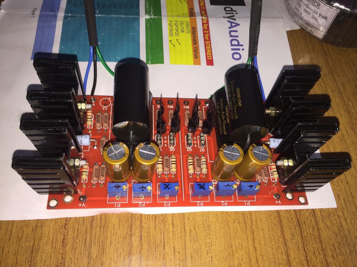

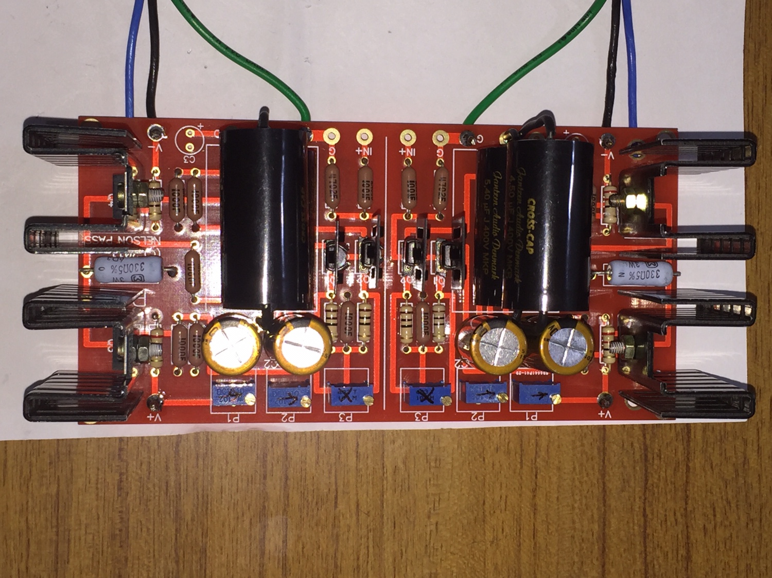

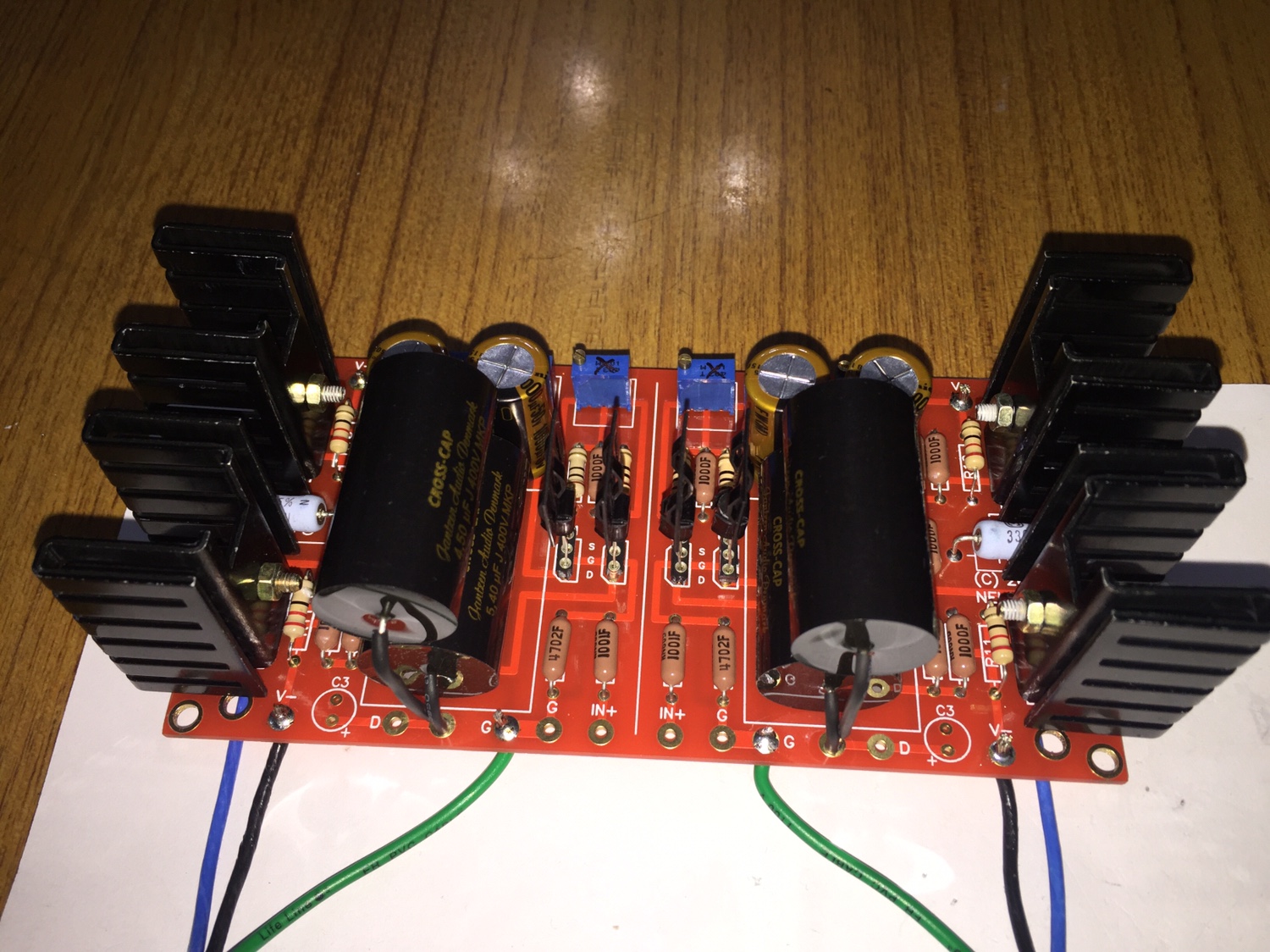

Weekend work seems to be bearing fruits...magic smoke still inside...phew!!!...started biasing right channel...took about 30 turns on the 1K turnpots before the first digit moved on the MultiM...heart pounded like anything...but that was a good sight...started biasing on R10..R11... slowly and gradually set that up at 0.75V on both the resistors...funny thing is the reading across R12 reads 0V no matter whatever bias I set...either I have done everything amazingly correct or messed up something...The MOSFET's are warming up just fine..close to 41 degrees C....went through the forum that need to ensure there is DC offset before C3...I tried moving around a places...except if I out MultiM across C3, is when I see some reading...Need suggestion which is the best point to pick for DC offset setting...
Measure dc offset between cap input > ground reference.
