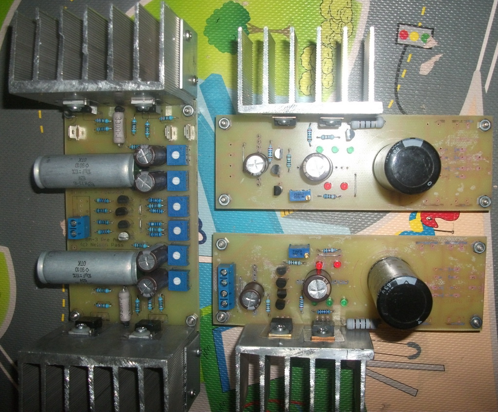

Firing up my third BA-3 FE and first one to give trouble....
It uses Toshiba Mosfets from B & D that 6L6 told us about, dont know if it is them or something else.
Problem is, unlike the first two, I cant get past .750 across R10 & R11 while turning P1 and P2 COLLECTIVELY...by this I mean I can turn one up to 1.0 across R10 & 11, but when you attempt to bring the other one up, the other comes down.
With my first two, you could just keep edging up...Even though they are the Toshiba mosfets, perhaps I need to go to the 1000 ohm pots...or change out mosfets with a set of the remaining two amps worth that I was saving for a pair of BBA-3 mono blocks. Those sets came from member Prakit which I used in the other two builds. Worked great in other two...
Second problem, which makes me wonder if I am getting tired and miss wired something, is that there is 22.7 volts of DC, and it does not change as P1 and P2 are adjusted. This is the same on both sides, measured from R12 to ground or from the top of the Cap to ground.
I'm staring at one of my working ones looking for a wiring error, but may need to wait until tomorrow to look clearly.
Any Ideas of where I slipped up? Or where a defective part could be? I reread the thread, especially Delacoys adventures, but I am just not seeing it tonight, yet.
Thanks in advance,
Russellc

Just caught it. Noticed one of the 1000uf caps ends was slightly "ballooned."
All of them are oriented correctly but holy dumb bunny power supply wiring
blunders. Hopefully didnt cook any thing fet wise or Mosfet wise. I have another set from B & D. Really want to save what I know are good and from same source for BBA-3 mono blocks. Also have more J fets, really dont want to waste those
On my last two, there were separate wires going from power supply to board.
On this build, I put a terminal block in between so I could easily undo the V+, V-, and the ground wires. Getting tired, and getting in a hurry, I wired the V+ and V- on each side TOGETHER to the same leg.
Fortunately I was using a variac and am hoping that one cap with slightly swelled end is all the damage, too many distractions and dumb mistake made.

Oh well, looks like damage done. Rewired, turning pot to minimum, P3 remaining in mid position and fired up with variac, up just over 1.0 volt across R11 and R12 at just 40 volts of 120 mains here.
At least the power supply points all measure correctly.
Will replace mosfets tomorrow and retry, if that doesnt do it I guess it got the J fets as well. That's all I can tear up tonight.

This is where the Mains Bulb Tester comes into it's own. It lights up when you try to power ON with a wiring error.
But there is a further modification you can do to make your amplifier closer to bullet proof.
Add a 1n4002, or higher, across each of the main supply rail decoupling capacitors. This shorts a mis-wired power input turning on the filament and ensures a reverse voltage never exceeds 1Vdc
