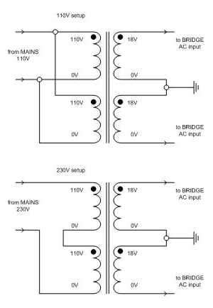

6L6, You know the Peter Daniels power supply I used on my first BA-3 preamp, as you helped with its assembly greatly!
But on my second build I am using a power supply from Tubecad.com:
GlassWare PS-19 Bipolar Power Supply Kit
It is very similar, at least as far as my question goes, to the Tubecad.com power supply you used on your build thread BA-3 preamp. I am using the same transformer I used on the first one: (it is available, and I already have it)
AS-0522 - 50VA 22V Transformer - AnTek Products Corp
Like the power supply you have, instead of having 4 pads connecting to the portion of the power supply with the rectifier/diodes, it has 2, and a third pad marked CT. I noted in your build thread you said you used a "configured as centertap" connection to power supply for your transformer, which was a 20 + 20 volt unit very similar to mine.
Is this an example of how it should be hooked up to this tubecad.com power supply? Looking at your build pics this appears to be correct, but thought I would double check: (top illustration for 120 volt mains) I can not tell for sure where the secondaries are going on your pics, but I think this appears right.

Like this - (I think this is the image you wanted to link)
yes, that's the one, thanks! Just wanted to make sure...
