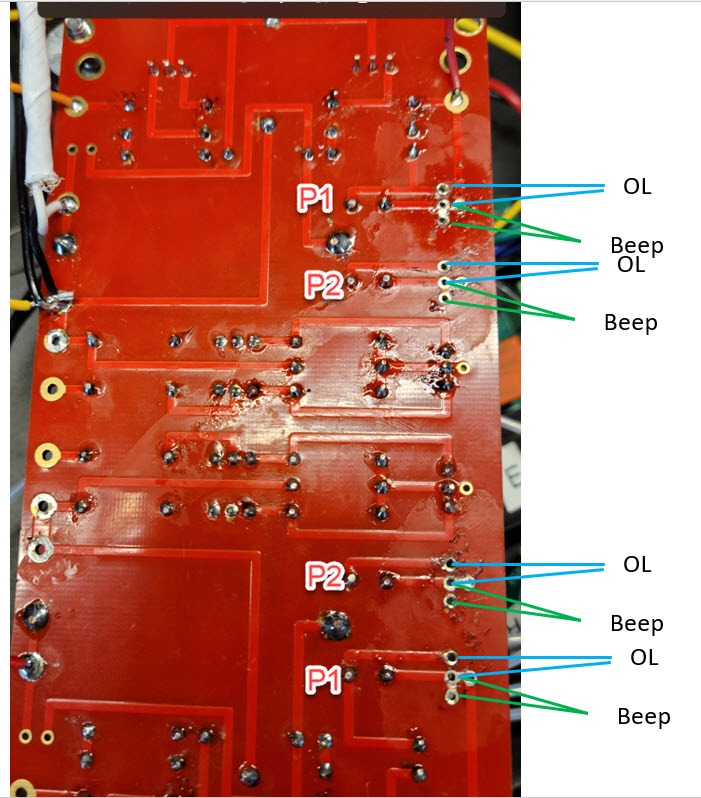

Well, I have the new pots. But in getting ready to put one in, I noticed that plastic between two of the leads has worn off due to aggressive removal of the previous ones. What you see in the photo is not solder between the two leads but, the red layer worn away. I think these two are linked anyway as part of the circuit?When you have the new pots in place, make sure you set them to minimum value before powering up.
Am I ok to use this board as is, or is it shot? I have one more pot with the same issue on this board.
Well, I have the new pots. But while installing the first one, I discovered that my aggressive removal of the previous pot has worn the plastic surface between two leads. See photo, what looks like solder is the trace between the two posts. Since they appear connected, can I still use this board, or is it time for a new one? I have one more issue like this on this board.When you have the new pots in place, make sure you set them to minimum value before powering up.

I can't tell exactly where that is on the board, and I don't have access to a good / big monitor.... but...
It looked to me like you just scraped off a bit of the solder mask across a short trace vs. lifted a trace, lifted a pad, or cut a trace. Someone else at a good screen can maybe confirm. Either way, you need to be sure yourself, and it's a good skill to have.
If you only scraped off the mask, then the trace will still have continuity to both pads. That's what you want. If you've lifted anything at the pads or the trace, you would have an open circuit.
Essentially:
Remove the relevant parts. You may have already done this, but I think I saw a lead still sticking through a hole.
Set your DMM to continuity. The meter will beep if you have a closed circuit (continuity) between the probes at a low enough resistance. It won't beep if there is no continuity (open) or if there is a high resistance.
The "Long way", and the correct way, is to check the board on the other side for the silkscreen designations for the parts that went into those holes.
Check the schematic to see whether you should or should not have a connection between any of those 3 points or not and verify using your meter.
The short way, and the way I'd do it, for your specific issue is to look at the traces and know that the two pads on the left are supposed to be connected. There is a visible trace between the pads. Make sure they still are connected. Poke your probes into the holes and make sure it beeps. It would be very surprising if it did not based on the pics.
Since it's close to your area of concern, put one probe into the hole on the right, and then alternate the other probe into the holes on the left. My guess is that you should not have continuity for those two measurements, but check the other side of the board for any traces between them. Check the schematic to see if there is supposed to be continuity between the two top pads. I can't tell in the pic.

So chiptech, if that's the case, then you should have one more lead to desolder (the top one?) and the two pads in the middle should have continuity (to each other and the bottom pad). See... don't go by my ability to see a picture. Go by the schematic.

Yep, I did understand that.I was hoping that Chip would look at the schematic and realize that two pins of the the pot are connected, and that the pcb has two pins of the pot connected (post #2344).
See photo below of my readings: Beep on two pins that are connected and OL on the other one.
I think I'm good to go.

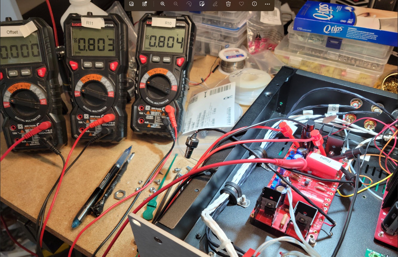

Progress. Put everything back together. Wired the button start backwards. Fixed that.

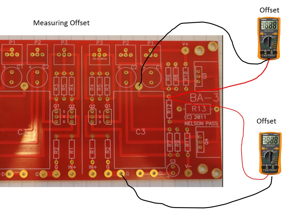

Getting readings around 0 .810 DCV on R10 & R12
Offset is minimal and never amounted to much as I adjusted the bias.
I'm using two different ways to read offset. I think I saw a recommendation to pull after the C3 cap. See photo.
Either way, not much offset showing up.
Am I missing something?
The sinks are both warm.
