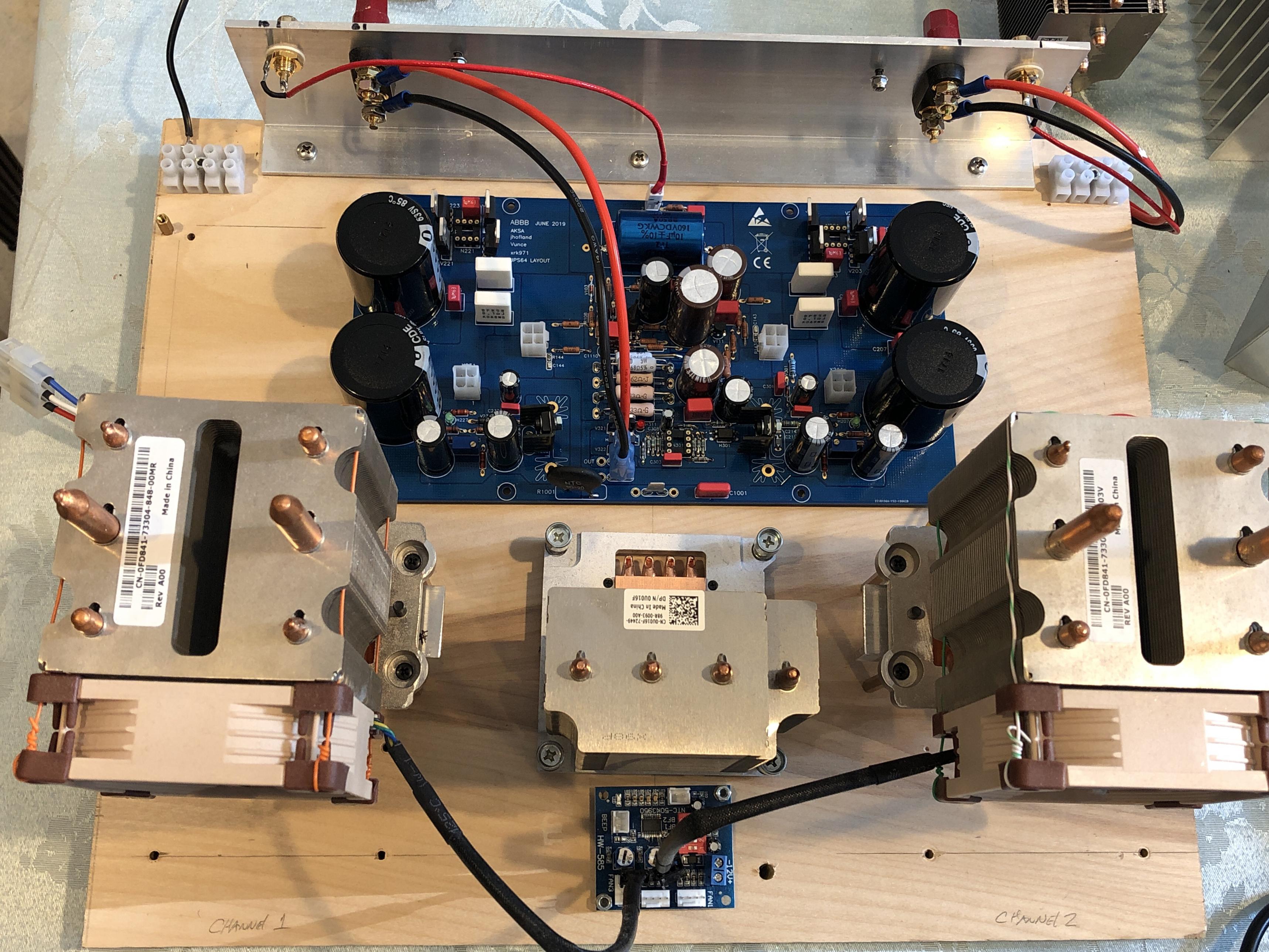

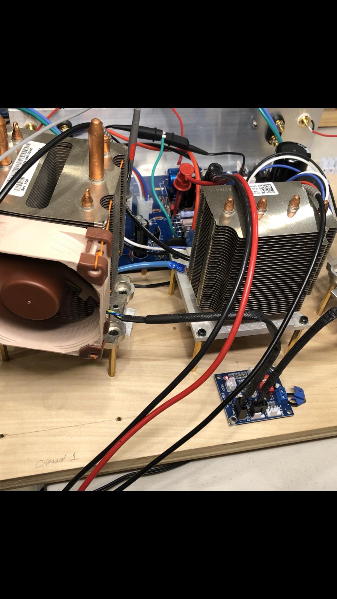

The plywood board will have three cpu coolers. One for each Mosfet, and one cooler for the pair of capMx BJT’s. For the initial power up and tweaks, all coolers will each have a Noctua pwm fan. The pwm control board has three outputs so that works nicely.
Yes, one channel. Ultimately, my plan is to build a pair of monoblocks. I will arrange the Mosfet CPU coolers so a single fan can be utilized and use the aluminum chassis for the BJT’s. The trafo will be upright on a 90° bracket.

At least this one has you covered with PSU, amp, and speaker protection. Just add trafo and cpu coolers/fans.
If anyone wants to try water cooling - this is a great project for that as the actives are on flying leads.
One could get a section of aluminum square channel, seal the ends with a fitting and use a clamp bar to clamp all 8 actives on it and let some water flow. Doesn’t take much water to remove 400w.
Just need some active way to monitor water flow or temp and cut power if reached.

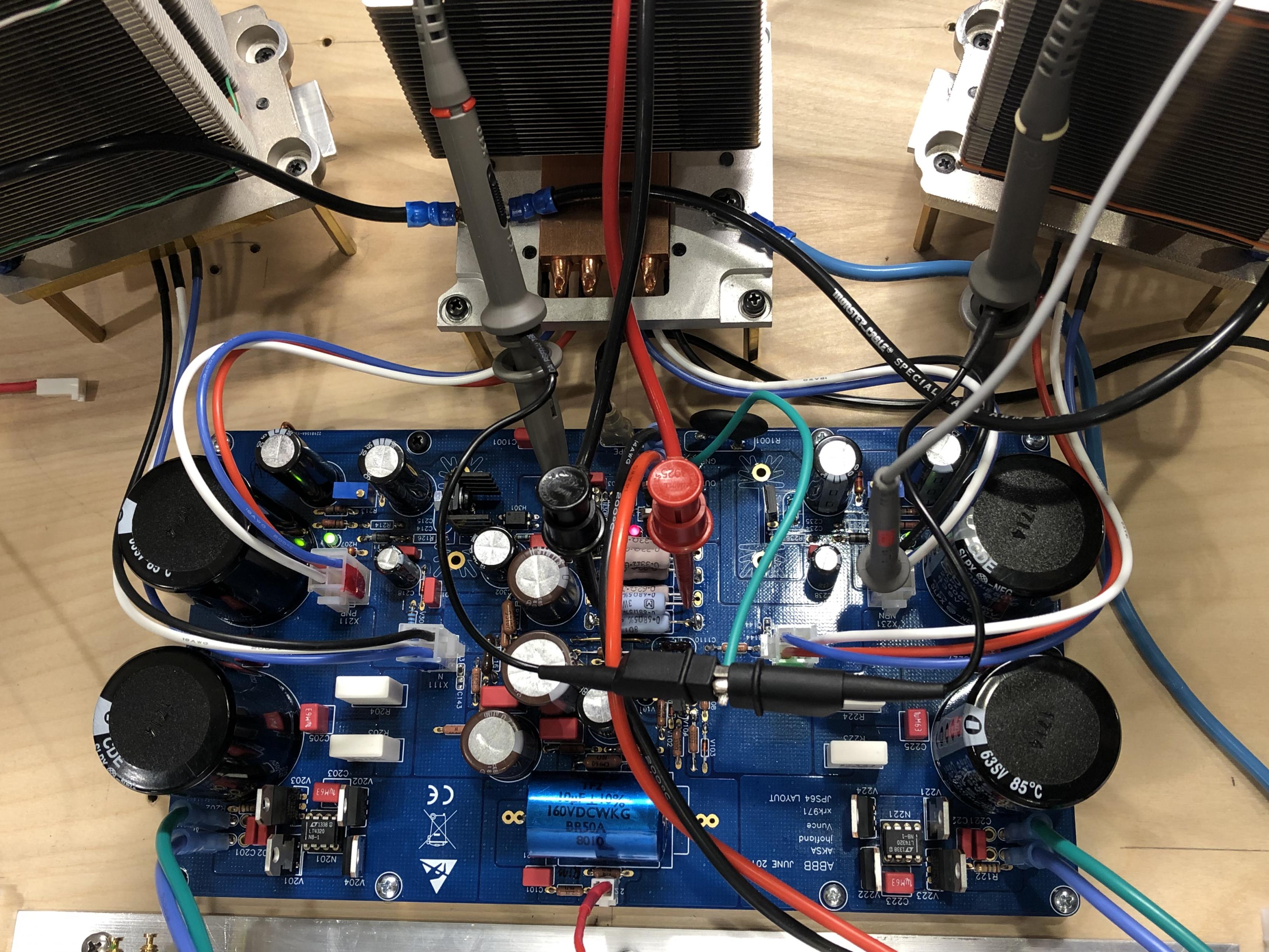

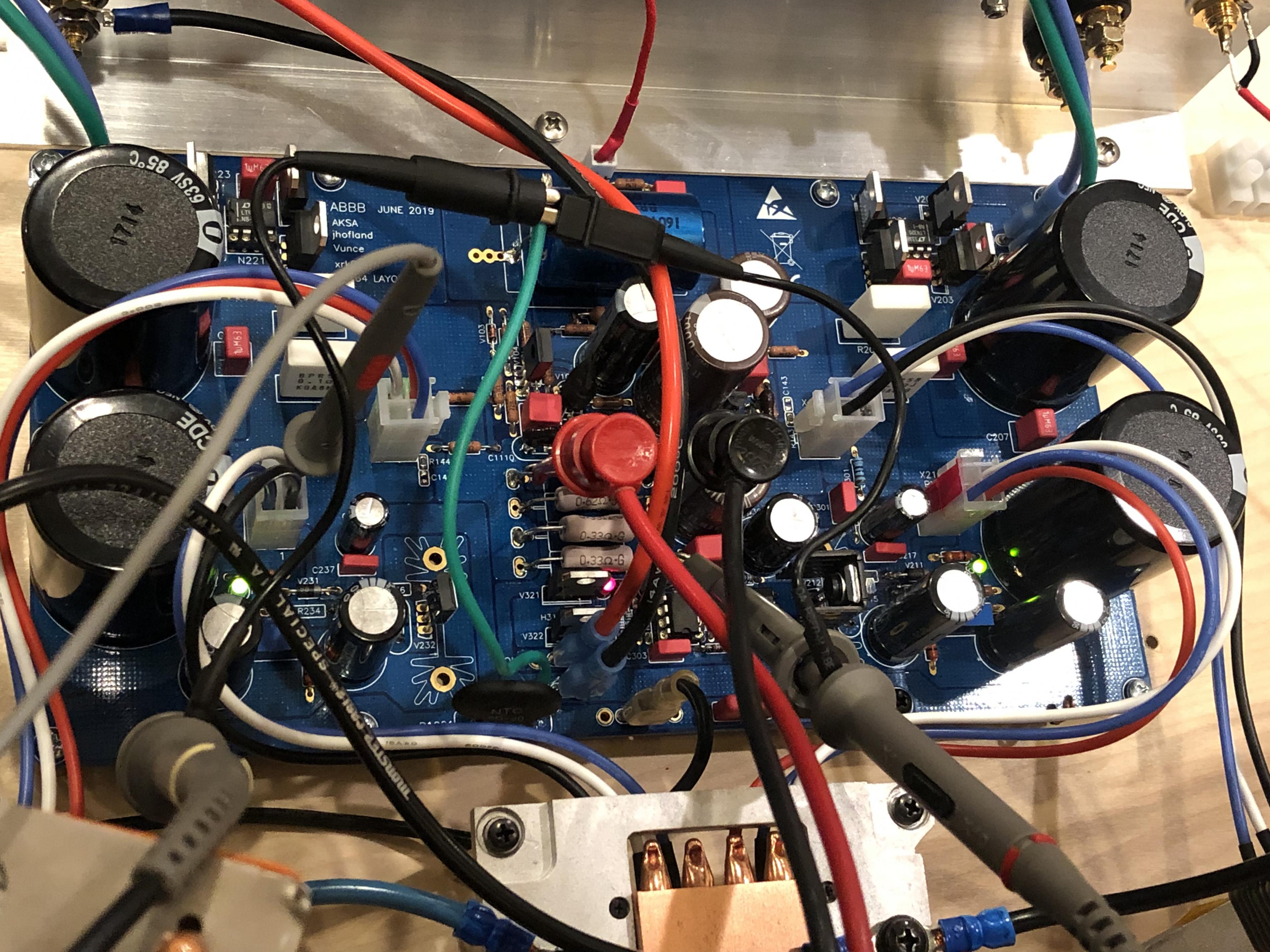

After ironing out a few details, we have an Alpha Big Boy w/Buttah singing away!

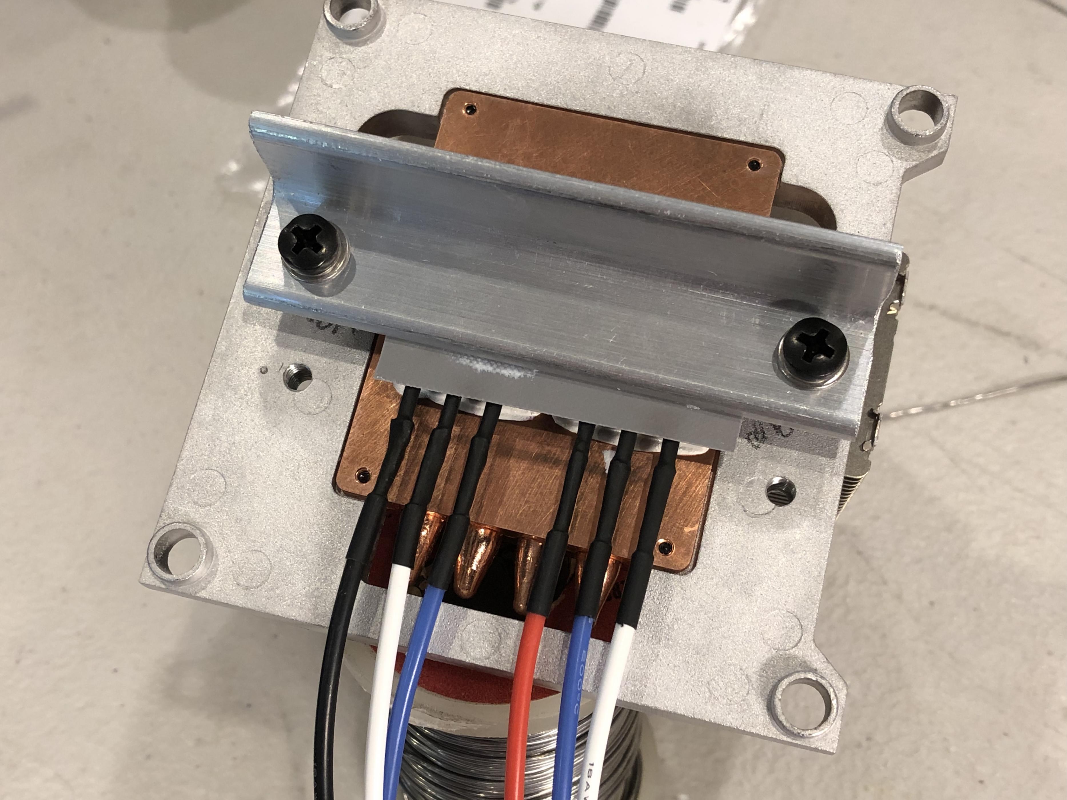

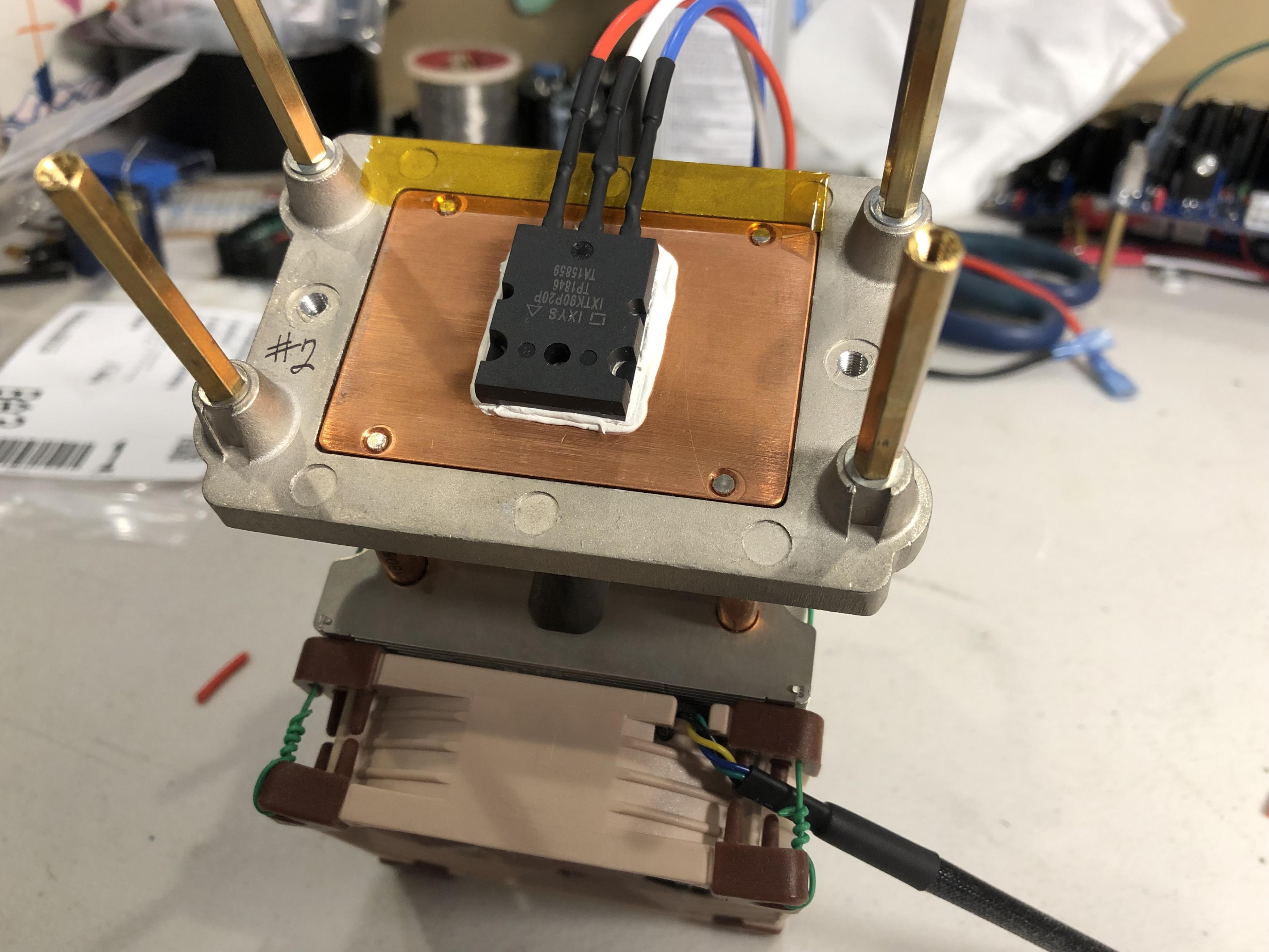

Since this project requires the Mosfets to be mounted off-board, we decided it would be best to have the snubber components mounted as close to the Mosfets as possible. This required the talents of JPS64 to layout a very small pcb to mount the Mosfet, resistor, capacitor and connection wires.
He even gave the option of using SMD or THT components 🙂. These will accompany the main ABBB board.
The SSR speaker protection/delay has also been tuned for approximately a
6sec delay time which works excellent at squashing any power-up thump and initial dc offset.

Beautiful work, Vunce! Thank you so much for leading the charge with the verification build. So glad it is singing happily now - I will have to get your notes and ask JPS64 to make some minor updates to some silkscreen typos. The board layout itself was all good, with the main change of moving the MOSFET snubber to the new small local MOSFET pin-mounted boards, which even have their own Molex Minifit Jr quick connects! I suppose one could connect the wires via soldered flying leads to these small boards and have just one Molex connector on the other end.

I’m running 37vdc after the onboard capMx and .600vdc across the parallel sensor resistors, I believe that’s approximately 2.75A bias current.
All cpu temperatures are very well under control. The Mosfet coolers are running 37°C at the fins and 50°C at the aluminum angle clamp bar.
The amp at idle is silent with my test speaker setup, but I will hold off judgement until I hookup to my main speakers that are very efficient and reveal any noise.
I was listening for about 2hrs tonight using an iPhone—>Bluetooth module with Toslink output into an “old school” R-2R Dac. For only a single channel now, the ABBB sounds wonderful 😀!!
