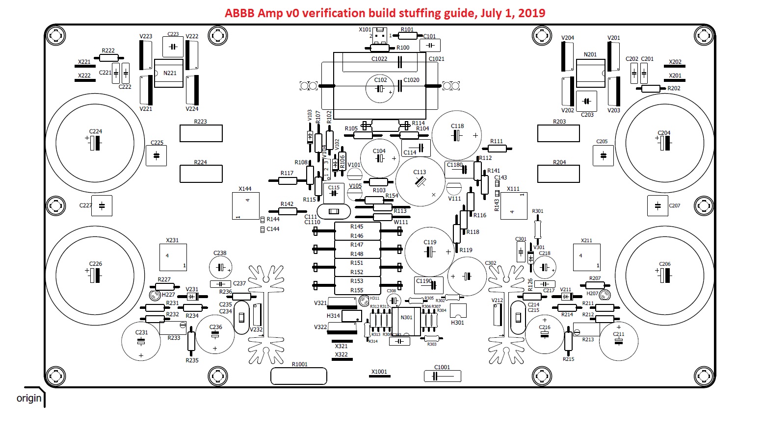

Thanks for the update X - I’m just starting to research and put BOM together now - starting by merging the Alpha BB and SLB BOMs from respective threads. Do you plan on releasing the BOM you’re using for the verification build - it would be most helpful?
Here is the ABBB BOM (v0) - for prototype verification build only, subject to change.

I have word from DHL that the ABBB prototype board should be arriving this Monday. Both Vunce and myself are geared up with a BOM and ready to go. We will try to document the build as much as possible to provide a detailed build thread.
