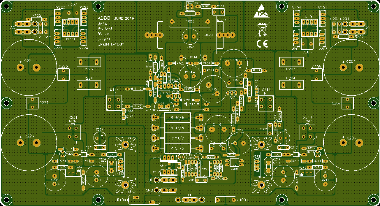

Here is a preview of the verification build board as rendered by the board fabrication house. Actual board will be blue solder mask. Tented vias are in place - all 14,000 of them! Note that on a large complex boards such as this, I have to verify the build first before ordering all of them.
240mm x 130mm x 2mm thick. 70um (2oz) thick copper, blue solder mask, ENIG finish.
Wow, what amazing work from all involved. JPS64, your layout is impeccable as always. Not a lonely trace to be found, just nice fills. What does the bottom copper look like? Is it a mirror of the top?
At some point do you think the fab house will start complaining? I could only imagine the impact 14k drill holes might have on productions, even with the best of CNC setups.
