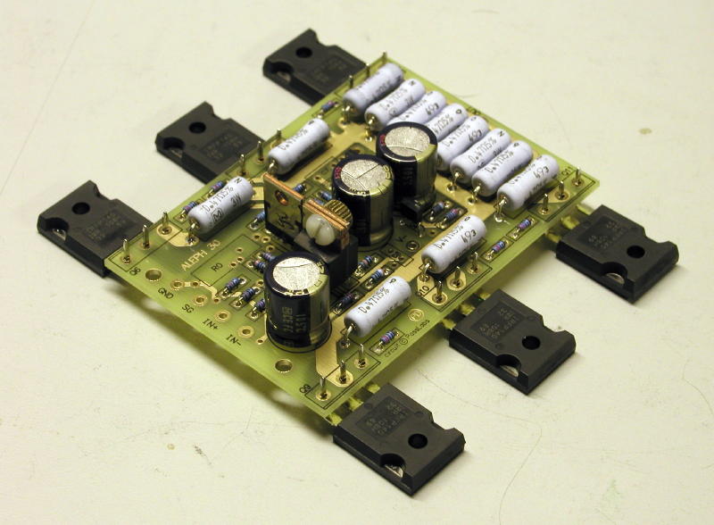

The Aleph30 PCB layout
hot hot HOT
I thought my amp was very hot. I've never had an amp run this hot before and was a bit nervous so........ :angel: I borrowed a few thermistors from work and fastened them onto various components inside and outside the amp, closed it up and played it for 2 hours.
The top of the IRFP240's got as high as 67C, the tab of a 9610 on the differential pair got to 82C, ambient inside the amp was 48C, temp on the hottest spot of the heatsink was 55C.
These readings surprised me as I can barely hold the palm of my hand against the heatsink for more than a few seconds :hot: yet the temp on the 240 suggests my heatsinking is OK.
Question: is the tab temp on the 9610 a little high at 82C as the spec says absolute max is 150C at the junction.
BTW fantastic sounding amp 😀 😀 😀 😀 😀
Kev
