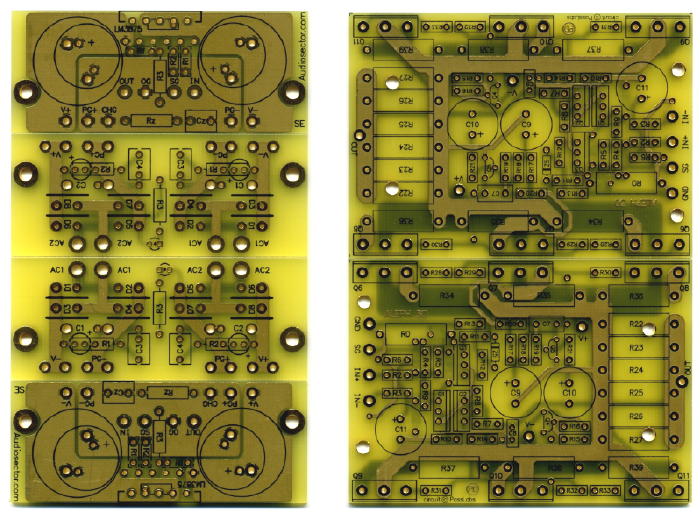

My working circuit looks exactly like in pic below. Besides the 3 elektrolytics, I didn't use any other caps. It workes fine.
You can see that output devices are not soldered yet, as it's better to solder them after they are attached to a heatsink.

That was actually my objective: to make them not much bigger than GC boards 😉

Thanks Peter, my boards arrived today. My plan is to build a Aleph60 by combining two PCBs per channel, using the other only for the output devices.

I've just built up the first board, not tested yet but it went together really quite straight forward. I'll test the first 2 when I've built the other, hopefully this weekend if work doesn't intervene
My plan is to build two tri-amped mono blocks, 2 of the boards will be Aleph 30's the other an Aleph 3 for the tweeter.

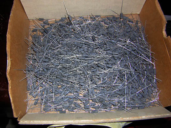

Mark A. Gulbrandsen said:I still have a few Dale CW2C-14's 3% tolerance left over that I could send to Peter if he thinks these would work. I believe these are 2 watters.
I think those would be fine too, as long as they are 0.47R, but it's up to the people what they want. If there is saving on the resistors in a picture, I can supply them as well (how much are you asking?).
So whoever needs resistors please specify your preference.
I wouldnt be too happy using 2 watters for source resistors. Since its Dale's they are probably conservatively rated, so maybe they will do. In my excperience, the source resistors runs hot

Free... I got these for next to nothing so if folks can use them why don't I send you a hundred. They are .47 at 3% tolerance....... If I had time to ship them out to individuals I would but my time is short for the hobby these days. Let me know....

The 3W Panasonic resistors are $15/set of 24 with shipping of $6
If interested, I can also forward the resistors Mark voluntered to donate, in that case it would be only $6 shipping. Please specify your preference by e-mail.

On a 1Khz square wave the leading edge overshoots slightly. Is this known as "ringing"?
Anything I can do about this?
Is it a problem, I don't know what affect this ringing may have on the performance of the amp? I also don't know how to alter it.
i haven't measured the -3db point but I noticed that the amp went up to around 60KHz before the output voltage started to drop.

I notice that on the photo Peter put up of the populated board, that the input differential pair looked as if the sources were connected together at the tab. On mine I have to have them electrically isolated but thermally connected. Is this normal?

You can adjust square wave performance with C8. By changing the value of that cap (5-10pF) that "ringing" can be reduced. I didn't install the cap as I didn't care for square wave. IIRC the presence of the cap affected sonics slightly.
In my picture, the input differencial mosfets are also isolated electrically ( I used mica piece, that's why it's not well visible).

I received second production run of the boards today. Anybody placing the order after Feb.3 will have their boards sent tomorrow.
There were some questions regarding the voltages across 220uF electrolytics. I just measured it today and this is how it is: with rails at +/-27V (from 2 x 20V, single 500VA transformer per two channels) the voltage across the electrolytics are as follows:
C11 0.03V
C9 15.3V
C10 0.6V
