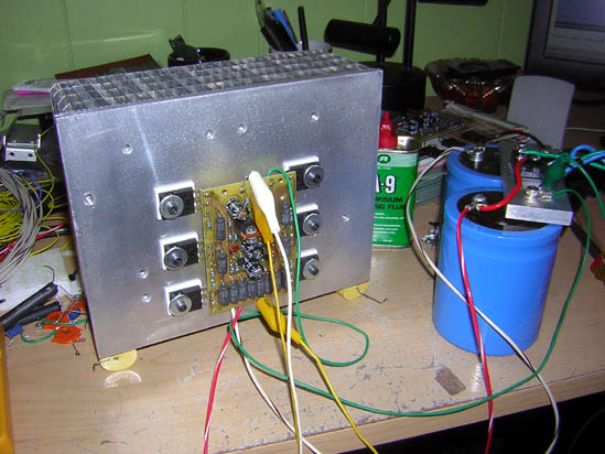

I have one channel up and running but its definately not enough heatsink with the standard bias scheme. The odd thing is that I get .323 volts across the source resistors instead of the normal .25 volts. While this extra bias surely translates into better sound any idea whats up here and why its so much higher? I am using IRFP240's and everyting else is as on the Aleph 30 schematic.

something definitely isn't as on A30 schematic;
current through first mosfet in LTP (voltage across 390E resistor) ?
you certainly missed some resistor value

I think it is the design. First off the board is way to small to accommodate 6 fets. It is to cramped up to dissipate all that heat in such a small area. My Mini A's produce a fair amount of heat and that is only 2 fet's. I'd hate to see what 6 fets would do with a higher bias and more rail voltage.
The reason most aleph boards that are sold on here with external output device boards is because of this exact reason, Aleph's get hot.

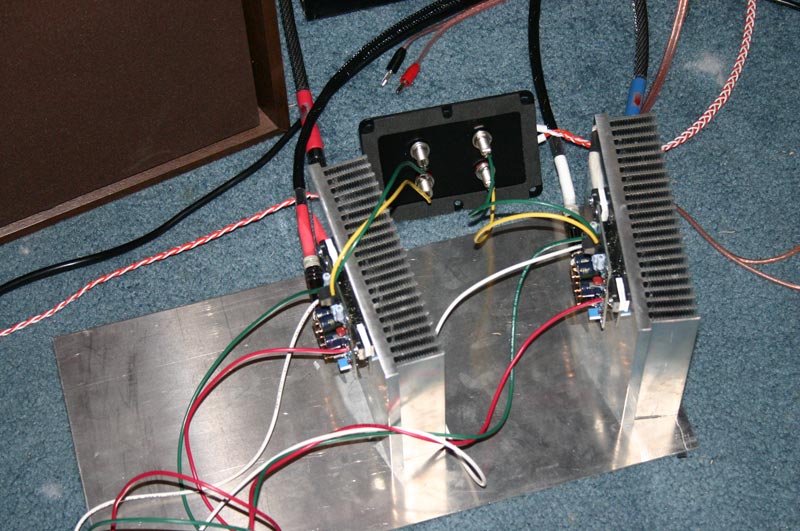

I attached a picture of Brian's new aleph mini's that i built for him while i stayed there.
After 24 hours of break in and warm up, these things were up to a pretty good temp. I'll ask Brian to plug them in and check them with his thermal meter.
My point here is that peter has a good design but the flaw is that the boards a little to small and the A30's get hot. I bet it sounds good.

those are high efficiency heatsinks, they only work well with fans.
With a fan mounted on them you'll be amazed.

Your point is wrong. It's not the board that dissipates heat but the heatsinks.
Looking at the pic below I couldn't see a better way to arrange the mosfetsd on that heatsinks.
If bigger heatsink is required, I don't see a reason why not extend mosfet connection to the board with wires (that's how Aleph 0 was done).
It is also much better to run 3 x 3 wires (to each mosfet separately from small front end board) than 3 wires to 3 mosfets on additional output board (per side).
Besides, one should build the amps before commenting on the design.

Mark your heat sink is way to small to work with this board. I think the only way this is going to work is if you used forced air into that heat sink.
There is absolutely NOTHING wrong with peters design! In fact his device spacking is farther apart than the O.P. device spacing on Jan's original KSA-50 board.. and that amp dissipates at least twisce the heat
. Peter's board is not only an excellent design but also very ingenious. There is no disputing that fact!
Jacco is correct on this one. These sinks are amazingly efficient if one places a fan that blows up through it. I now have a small 2" computer fan running at half voltage and the whole thing is just luke warm! This sink was from a huge pulse width motor speed controller and it WAS fan cooled for that use.
As for a resistor in the wrong place... definately not as I measure each resistor before it gets soldered in place. My eyes are too bad off to see those tiny color bands
. The fact that is all 6 mosfets have .320 give or take .07 volts on them.... I matched them very closely. My operational DC offset untrimmed was just under 5 mv, again due to use of my old but trusty gigantic 5-1/2 digit precision Racal DVM.
I will just leave the bias as-is for now. No need to lower it as long as I have the fan going. I am tempted to build a chassis that uses the fan to pressurize the whole chassis and allows the air to flow through the sinks and out of the case.... somewhat like a BGW 750 power amp... that always worked really well.

maybe you can make your chassis so your air flows up words with a 5" fan i the middle running at 4V. 4v will me quiet but also move air to keep them cooler.
Have the chassis hold the heat sinks fin's to fins. Like peters tower he created with the A30's using this same board. he strapped them together and put a fan in it. Make your chassis flat and have a metal grate over top to allow cold air in bottom and hot air out the top.
Peter's board looks really nice mounted like you have it. Good job on the board peter.
The BGW 750 had just a four sided steel chassis. The power supply and protection circuit is in the bottom and each channel's heat sink bolted on top... there was a 1" gap between both of them in the center. Then a top copver was placed over the sinks sealing them in with only the air inlet between them. The rear mounted fan on the back of the chassis blew into the chasiss through the sinks and out the perforated top sides. Very simple and effective.
