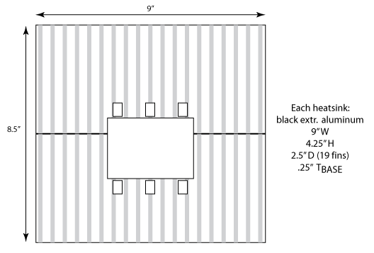

Taj,
Do you plan to thermally link the 2 pieces? With the A30 board layout the devices are located differently on each one. It would be best to take steps to assure that all the devices are close to the same temperature.
So,if I were going to use them in that arrangement, I would consider a large plate common to all devices between the devices and the sinks. A thermal transfer is necessary, so match/mate the surfaces accordingly. HTH

Ed Lafontaine said:Taj,
Do you plan to thermally link the 2 pieces? A thermal transfer is necessary, so match/mate the surfaces accordingly. HTH
I do now. Thanks! It's a lot more work, but I guess I'd better start looking for a giant heat spreader and 5 gallon bucket of thermal paste. 🙂
Nobody answered the dissipation question though.
..Todd
The answer to this is not so simple. but I will give it a try.
First I typically test any piece of heatsink by increasing the dissipated power into the heatsink until I reach the desired heatsink temperature.
Then I determine the delta temp of the heatspreader. This is a function of the thikness of the material used and the the material itself. For an aluminium plate of 6mm (12 x 30cm) I calculated about 9C from the middle till each end @ 120W.
Then look at the insulation pad and heatsink compound. The thermal resistance typically is 0,05 till 0,3 degC/Watt.
Then look at the Thermal resistance from junction to base for the device you want to use. I use 0,9 degC/wat for IRFP devices in TO247 case.
So assume you want to dissipate 100W at a heatsing delta temp of 25 degreesC, you need a sink of 0,25degC/Watt. At a room temp of 25 deg, the sink will be 50C.
The heat spreader will be 60C
To make sure that the device does not fail after a short time, I calculate the maximum junction temp @ 100C.
The maximum dissipation per device is then (100-60)/(0,9 + 0,3)
or ~33Watt
So in this example you can use 3 devices per heatsink.
I hope this helps...Tarasque.

Well I'd like to think it helped. I'll let you know after the pain killers kick in and smoke clears. I suspect I'll be just as confused then though. Not that I don't appreciate the response.
..Todd

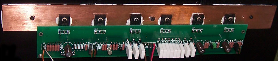

- The Aleph30 PCB layout
