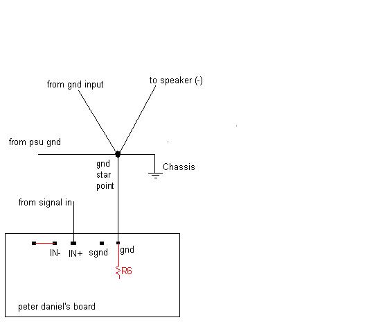

I have daniel's board, I want to do grounding like original Aleph30.
I use only single ended input. This is my grounding scheme, is correct?
The R0 power resistor in the original aleph is 3 ohm. Is not easy found it. Is a critical value?
In alternative is possible use 3.3 or 2.7 ohm?
giorgio
