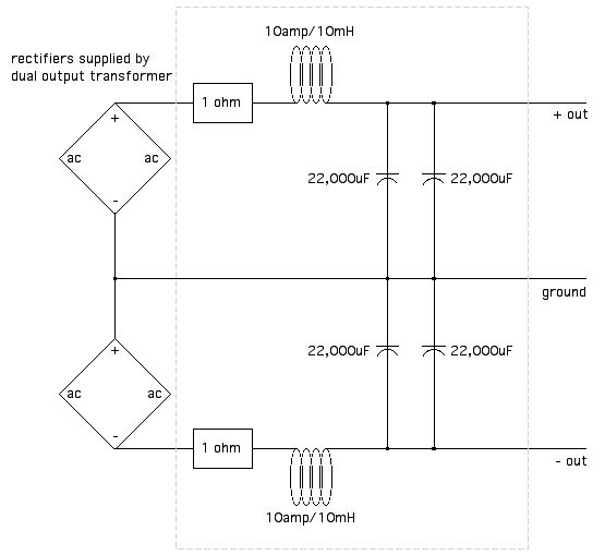

Is this on the right track?
Is this drawing correctly following Erik's description of a rlc power supply. Can the components in the light gray box repeat themselves for more filtering?
Thanks,
John

is there a particular reason for such an unusual choice of filtering topology? 10mH/10 continuous amps is a huge coil, unless you plan to use a northcreek 8 gauge coil, the coil itself is going to have around 1 ohm resistance. If you plan to buy the iron core 10mH/10A from surplussales of nebraska be careful, they spitball the current rating.
Have you tried to simulate the PS? It's a lot of fun. I think your circuit would benefit tremendously from having some capacity before the L.

how do you measure choke resistance?
The 10 amp 10 mH chokes are iron core and when measured with my v/ohm meter read 0.4 ohms, but, the probes read 0.3 ohms when touched to themselves. There is no null adjustment. I subtracted 0.3 from 0.4 and arrived at 0.1 ohms resistance in the choke. Now, with power running through it, the reactance will cause the resistance to increase. Am I correct? I have no way of knowing how much of an increase there may be and I'm not certain how to measure the difference. The idea of the added resistor is to stop any potential ringing in the circuit.
John

That is the right picture
Thanks,
John
That picture is what I was describing. Nelson brought up another
interesting way to do it: put the resistor in parallel with the choke.
If you have a simulator, give that a shot. You might want a bigger
resistor than 1 ohm, depending on the results.
If you want to add additional LC sections, I wouldn't necessarily
use the great big chokes after the initial section.
Erik
