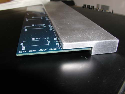

The ones in my photo are Bergquist Sil-PAD K-10. They are not pennies in quantity from Digi-Key. I bought 12 for $12. Yikes.
:$: :smash:
They do have the best R<sub>θ</sub> of any insulating pad sold on Digi-Key. Despite their description in the catalog, these are not rigid PVC with adhesive. They are thin floppy beige pads without adhesive.
