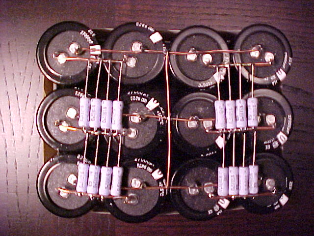

Gratuitous image of aforementioned CRCRC power filter.

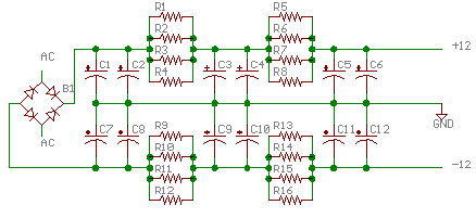

Okay sure. Let's number the capacitors in the picture:
05 06 11 12
03 04 09 10
01 02 07 08
Capacitors 1, 2, 7, and 8 are nearest the rectifier. 1 and 2 are from 14V to ground, and 7 and 8 are from ground to -14V.
1 and 2 are connected to 3 and 4 via 4 0.51Ω 3W resistors. The current is 8A, so these resistors drop 1V, and the second bank (3, 4, 9, and 10) are at +/-13V.
One more round of that gets us to the last bank, where the potential is +/-12V, and the ripple is only 5% whatever it was at the first bank of caps.
Thank you very much!
jwb, I've taken a "snapshot" of the screen and will keep the info you've given the rest of us. Do the resistors get hot? Any idea what the final mV amounts to? Also, how many stages can you add (it seems that every stage drops a volt). Could I could take a 20 volt transformer and drop it to 15 volts with 5 CR stages, or is there a point of diminishing return?
John
I think there definitely is a point of diminishing returns. Remember that the Aleph-X circuit will inherently reject ripple anyway, due to it's symmetric nature. So, noise in the circuit caused by power supply ripple will cancel at the speaker outputs anyway. But, of course there can always be asymmetries and so on... Also remember that the Aleph-X will always draw a constant power supply current, regardless of power being delivered to the speakers. There was quite a bit of discussion about this some time ago, and I posted a much more comprehensive set of simulation results and conclusions... it's all back in the thread somwhere. I'm too lazy to go look for it right now, though. 😉
I'm planning to use just a one-stage CRC stage. This already provides superb performance, giving a negligible 13mV ripple on each supply line. This is with 62mF - 0.25ohm - 100mF computer grade (low ESR) caps, result simulated using PSU Designer II. I also tried simulating a CLC using a 2ish mH air-core choke. The results came out only marginally better, at something like 3mV ripple. The trade-off is the potential of forming a resonant LC tank circuit which may cause music-related supply fluctuation at low frequencies. In general though, the Aleph-Xcircuit should be very insensetive to the power supply used.
Another thing to consider is that you lose a lot of power doing this kind of filtering, especially with the X design which draws double the current of a conventional single-output design like the Aleph.
My advice would be to go with a single stage filter, CRC, and no more than a two-stage CRCRC filter. For some people, just a straight C-only supply will work just fine. Reports I've heard indicate that with C-only, a very quiet hum can be heard at the speakers, and CRC makes the amp dead quiet.

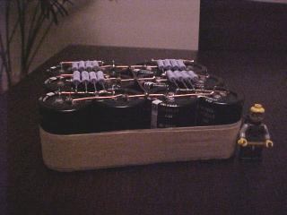

LEGO rules
jwb:
I love the LEGO man for scale comparison! :up:
Ah, I'm such a huge LEGO fan, I used to have buckets of that stuff when I was a kid. Come to think of it, I still do... I wouldn't let my parents get rid of it when I moved off to go to university! 😀
