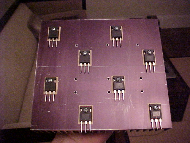

I am all over the digikey, mouser and newark catalogs I can't seem to be able to locate to247 micas or silpads (prefer mica) does anyone know a distributor and the catalog number?
