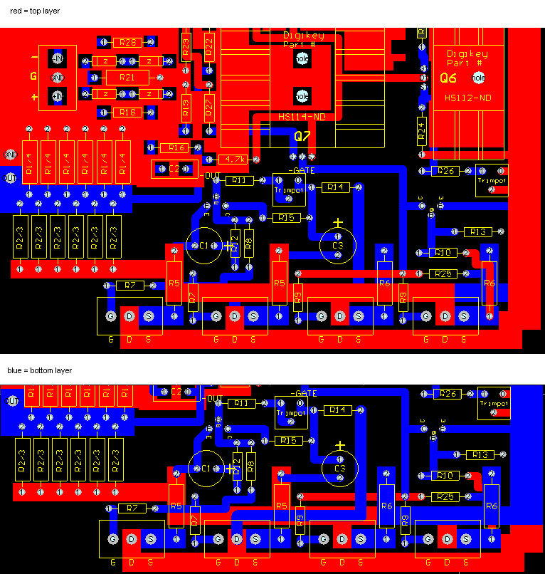

I worked a bit more on the schematic, and decided to include 8 output devices on the pcb. It makes it a bit big, but it doesn't really matter, since I am just using it for prototype pcbs. Here is a pic.
Is this a good way to wire up the output stages? I don't want to mount the mosfets to the main board, but instead attach wires to the board. I was going to use higher current terminal blocks. Would these be alright?
I am still working on the output circuit, and I think that I have the placement the way I want to, and I just need to start looking back over it to see if I got the circuit tied together correctly.
Any opinions on this? How much power do you think each channel could run with 8 devices? I would like to aim for 100W into 4 ohms if possible
Brian
Brian
It looks good. Even if you want to use wires, why not spread the output devices for the whole length of the board. This leaves the option to somebody who wants to mount them directly.
Brian,
it would be better if you tried to keep the source resistor further away from the mosfet. It's good to finally see big traces.
I will space them out some more and isolate the source resistor a bit more. I initially had the groups of resistors orientated lower, and I just changed them so that I could move it over, but forgot to do it.
Is 3W enough for the output resistors attached to the mosfets? I am using 5W for my aleph 2...
Brian
