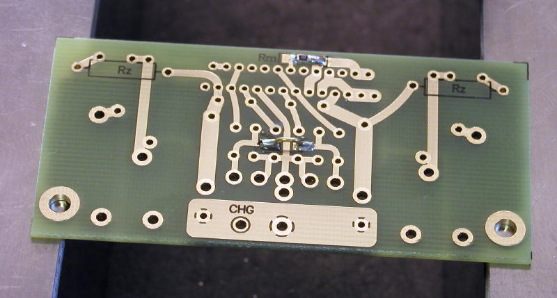

3W should be fine. You might also add extra hole for someone who wants to use Caddock resistor (in transistor like case).
Peter Daniel said:3W should be fine. You might also add extra hole for someone who wants to use Caddock resistor (in transistor like case).
I would just add a hole for that, but they straddle the summing trace.
EDIT: nevermind, I see how I can easily rework it for that. Which package size is generally used for the resistors? I see a few on the webpage.

Caddock MP9100 series if anybody is using them has 0.400" spacing. The smaller ones have 0.200".

The MP9100 is a 100W resistor, which seems like total overkill for use in place of a 3W resistor. I think that just adding the .2" spacing should be fine.

Peter Daniel said:Caddocks MP series: lead spacing .200".
Sounds good, I will add this spacing to the board when I rework the output stage a bit. For these resistors, is a heatsink required for this application? They also have gotten cheaper, since mouser carries them now. Is it worth using these over the film ones that digikey sells?

Found this too:
When in free air at +25°C the MPSeries have
the following power ratings:
MP915: 1.25 W
MP916, MP925, MP930: 2.25 W
MP2060: 2.5 W
MP9100: 3.5 W
I guess a heatsink is required. Would one MP915 attached to an aluminum strip work for the output stage? I could arrange them in a line, and attach an aluminum strip to them all for dissipation. Anyone have any experience with heat dissipation and heatsinking for Caddock resistors?
Brian
Brian,
I just wanted to point that fact out and remember it is ONLY 3.5 W and not even close to 100 W when not mounted on a heatsink properly. That would be pretty close to the 3 W would it not? The MP930 for instance which is a "30 W" resistor and with spacing 0.200" is only 2.25 W when not mounted on a heatsink. Not totally irrelevant I think...

Peter Daniel said:How those two compare pricewise?
For the Caddock 915, it is $2.62 each from mouser
For the Panasonic 3W metal film, it is $2.44 for 5 and $31.39 for 100 from digikey. I think that these are the ones used in the XA. They are the ones in the parts list for the Zen V4 on PassDIY.com
