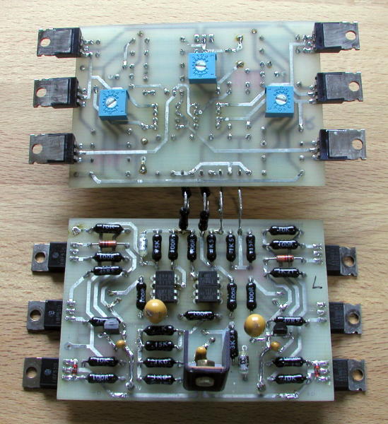

Check my A75 boards. Although I did them 8 years ago, by hand, I still consider them a thing of beauty. The six FETs mount directly to the chassis, so heat sinks are not required. This boards had to be double sided.

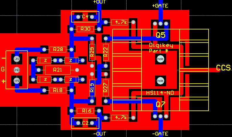

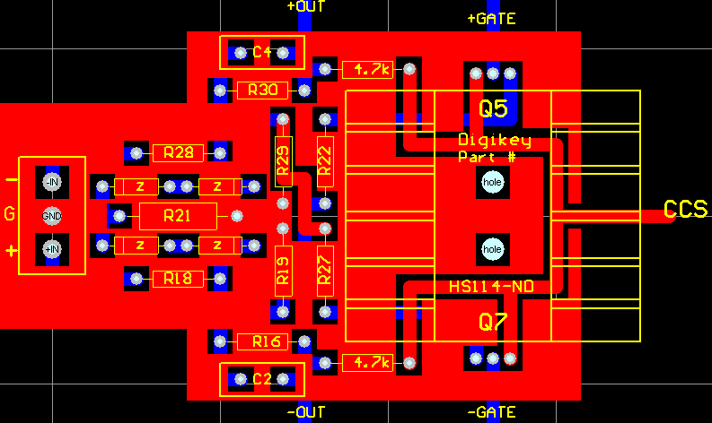

Is this the right way to do the ground plane? I was copying it off of the pass labs pictures. Other ground planes that I have seen seem to have the ground too close to the signal traces.
Brian

Please note that original XA board contains only 2 zeners (instead of 4) as Gate-Source protection. As to grounds, I don't have much experience here.
I posted a page ago about the two zeners and Mr. Pass said the ones in the XA are for gate-source protection.
There are also big input capacitors on the XA front end. What is the advantage of having these?
Brian
