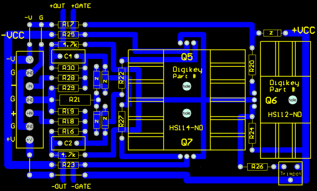

Although, I would rather make my own board. I feel that if a mass pcb order is organized, then the carpenter/wessol board should be looked over and agreed on before the order is taken place.
I am still working on my own board and had some time to work on it some more. Here is my second try at the input stage. It should be more symmetrical then the last version that I posted. I added the ability to jumper the CCS resistor to ground or -V, as suggested by hifizen. I have also reverted to 90 degree corners on the traces in the spirit of the pass labs boards. I wanted to keep a seperate -Vcc and +Vcc input so that different filtering options can be tried.
Any input is appreciated. Good luck on getting the mass pcb order together.
Brian

Ken,
You have some good points there. However, I think there's nothing explicity <i>wrong</i> with carpenter's board layout, except that it doesn't necessarily meet everyone's needs or wish list. So, for those who want to get building right away, I don't see any reason to stop them, as long as they understand that it's based on an early version of the circuit.
Instead of holding up progress, I think it's better to go ahead and do the "unified" PCB as a separate effort, since it will take some time to assemble the complete schematic, do the layout, and arrive at a generally accepted design. Secondly, I don't think the exact details of the physical layout and component arrangement are too important, so long as they're done by a competent designer. Since carpenter's design is actually just a predecessor to the current bunch of variants, it isn't really a split in the developmental lineage. Any results from construction of his board will be directly applicable to other efforts... as long as the connections are correct, it should work substantially the same as another layout of the same circuit. Given this, I feel it is actually more productive to have more people building the circuit sooner. This will allow us to incorporate changes into the "unified" design sooner. Anyway, the circuit of the unified design won't be much different. I expect it will mostly include footprints for alternative components, or stability elements which may be needed, and some layout differences to make the design a little more flexible.
With respect to group buying power, the primary savings are seen going from single orders to quantities of a dozen or so. Beyond that, the gains are a diminishing return with quantity. So, we shouldn't be sacrificing much in this area.

Hello,
here is my new alephX pcb VERSION 0.8, I got some inspiration from TVI layout (thank you TVI).
Details:
Based on Grey's original schematic (thank you Gray and Nelson of course)
Modifications:
-back resistors to source of differential pair
-Fred CCS (thank you Fred) with LM329 and J511 (siliconix version 4.7mA). R17 goes to -15V NOT to ground so it's value should be doubled
-Back to back differential pair and space for heatsink on the CCS mosfet zvp3306.
-compensation caps provided on Q3 and Q8 (ce) and between +/- outs and Q4c and Q9c, respectively.
I am sure I am forgetting something.
What it doesn't have:
-Provision for V2 (one should solder a trimpot figure the correct value of resistance, measure it and then substitute the trimpot for a fixed value.
-Input caps
Grounds:
I put the star ground on the middle of the PCB. The ground from the caps should be connected to the lower hole, the upper hole should go to a thermistor to the chassis and AC plug ground.
I can say that the layout is 99.9% symmetrical topology. Lots of effort was put into this. In one case where I couldn't do it I made the traces have identical lenght.
Double sided, metallized through-holes. BIG traces, doubled on both sides.
Later, I am going to make another version with twice the output mosfets for higher bias.
Suggestion for further mods and snide remarks are welcome!
EDIT:
I have made some mods in the ground section and modified the figure 8 motif which was pointless. I am going to bed now. Will make new pics later

here is a chassis layout as I envision it and the updated PCB whit slight mod to the ground area.
Having symmetry in the circuit is a good thing if you want to balance out the effects of transformer stray flux. Symmetry also should balance out the field generated by the high currents that circulate on this pcb.
By the way, the PCB was done with the ExpressPCB software.
I have to ponder on the circuit some more but in about a week I will send out the file to make a few prototypes.
