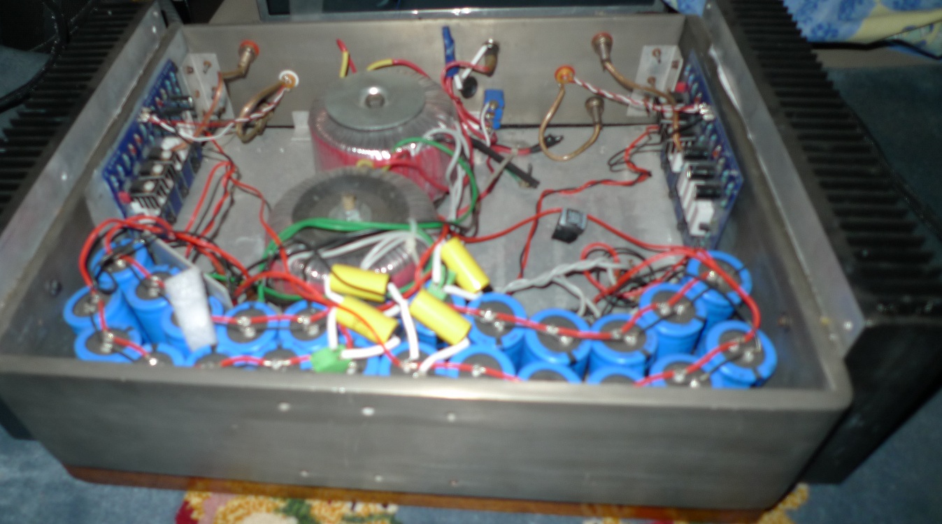

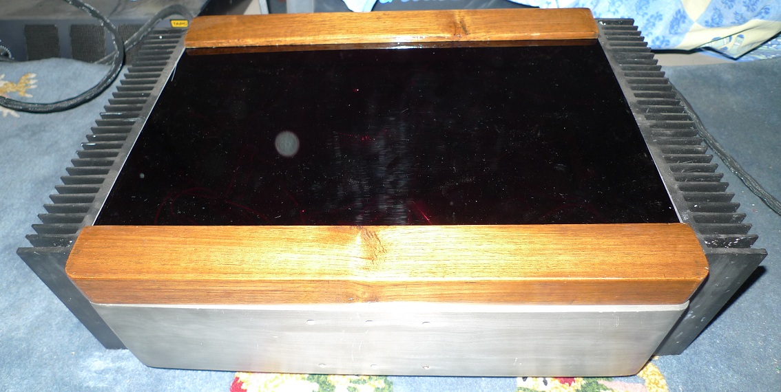

This is a picture of the bottom of my amp.
The aluminum base plate of the amp with all of the holes in it measures 10" by 20".
Here is another picture from the top:
Sorry that I don't have any better pictures right now. Both of these are from my web page. Someone in the Mechanical Lab is cutting some custom top and front panels for my amp. When these are completed, I'll post some updated pictures.

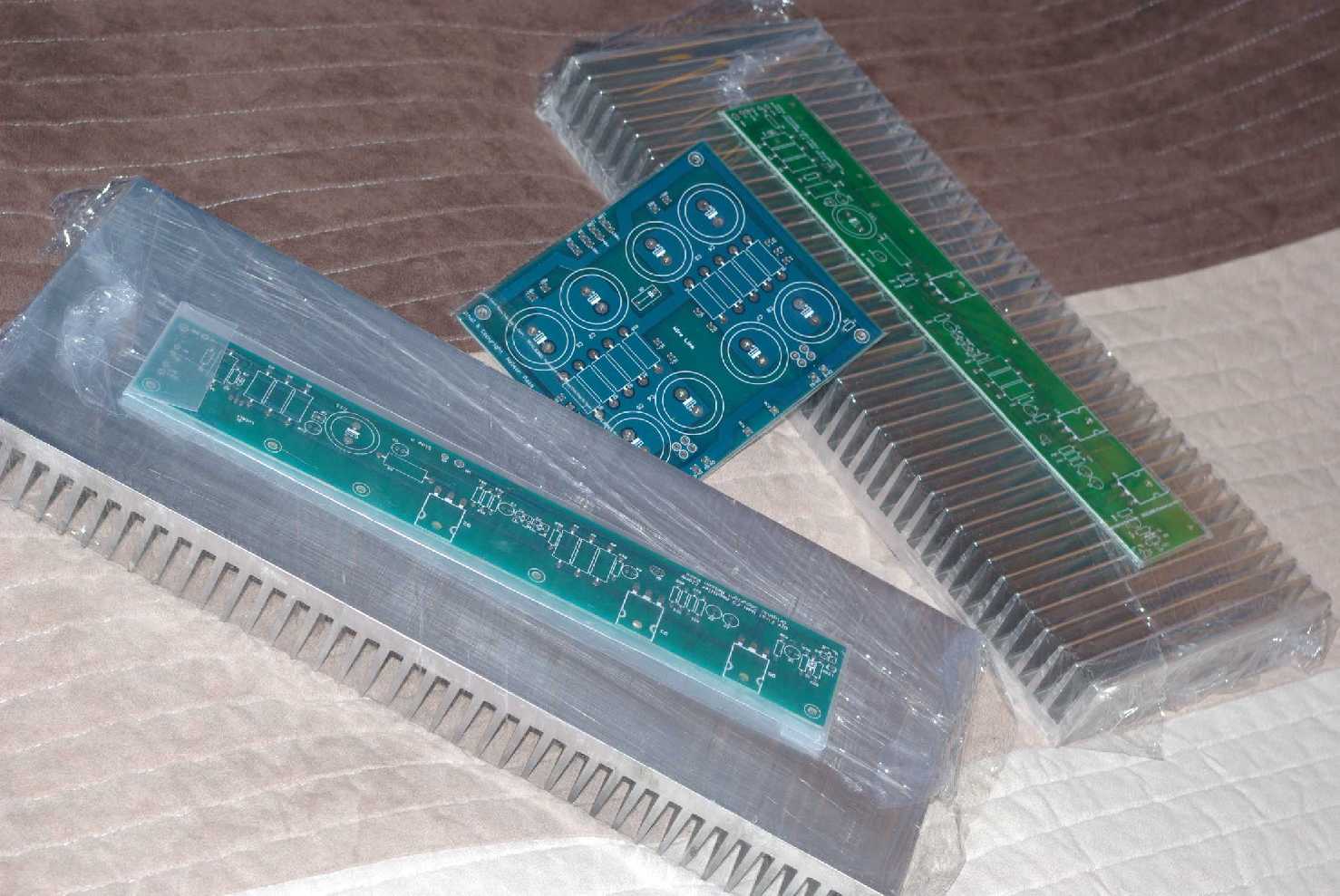

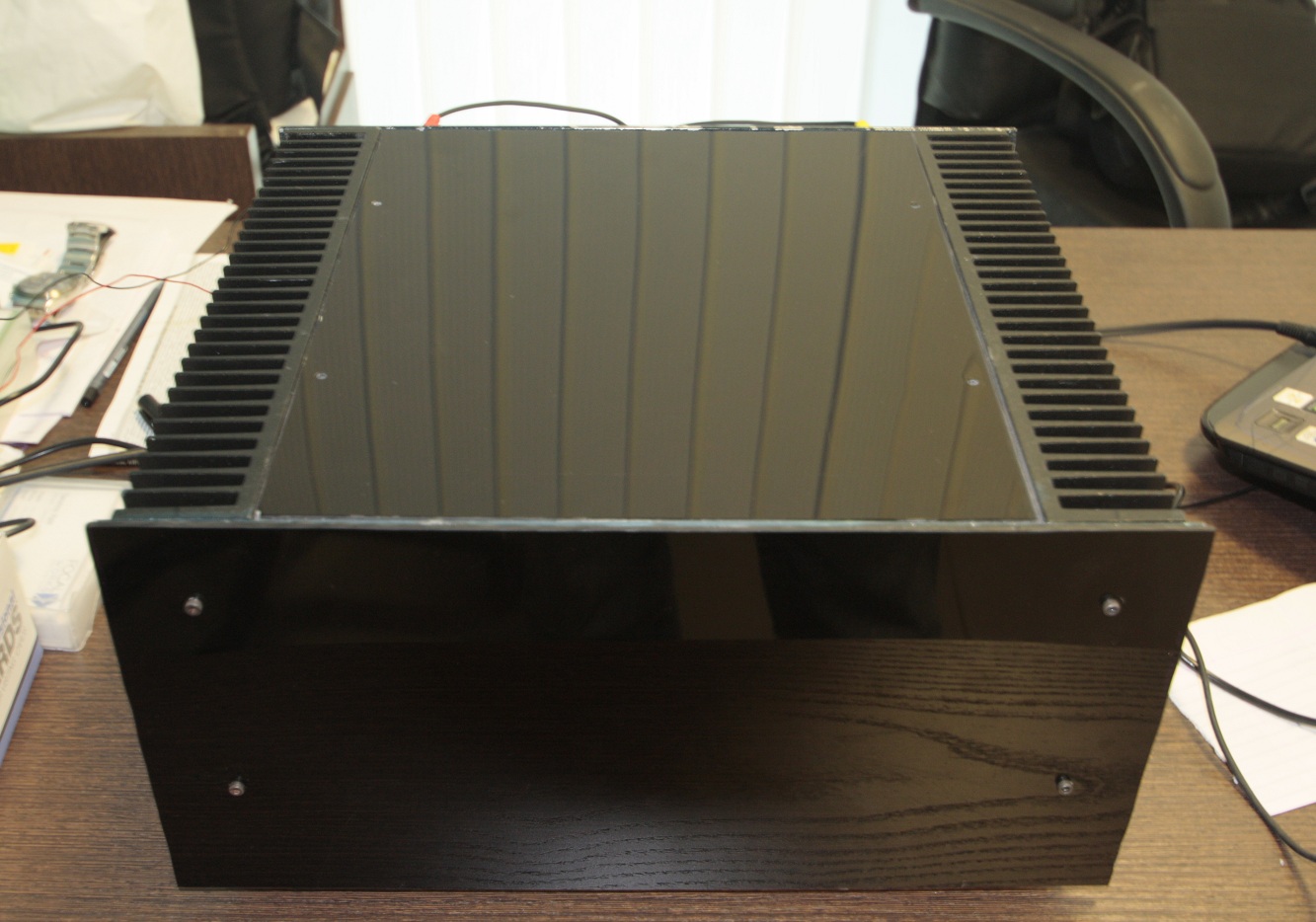

F.E. here is mine HR-400 (for NP F3 amp):

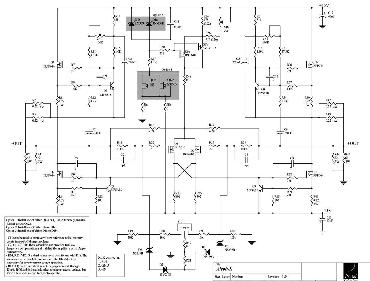

This is my first post of diyaudio. I am building an Aleph X and need some help with settling the Absolute DC offset. I have read through most of the post on this subject including the Wiki and the detailed article by Eric without which I wouldn't have had the courage to get started on this amp 🙂

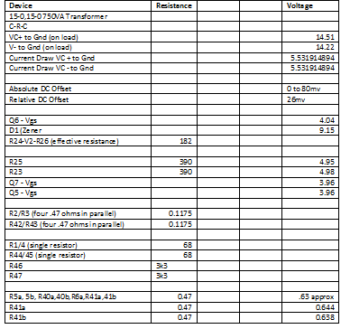

I managed to bring down the absolute DC Offset well below 100 mv using the the V2 pot and it remains reasonably stable, but the voltage across R23/25(390)is 4.95 volts. If I increase V2 towards reducing the current through Q5/Q7, the DC offset goes up to 7 to 8 volts and stays there.
Here are the details:
The Absolute DC Offset is near zero with V2 set such that the voltage across R23 and R25 is about 4.95 volts and I am measuring .63 volts across the .47 ohm source and output resistors. Resulting in 1.34 amps across the 8 IRF 040s that I am using per channel with the rails measuring 14.5 volts.
I would ideally like to run the amp with much lesser current, but If I bring down the voltage across R23 and R25 down to 4.5 volts using V2, the Absolute DC Offset jumps up to 7 to 8 volts and stays there. Changing V1 and V3 doesn't help in bringing down the offset.

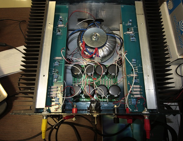

I am using the Aleph-x Rev 1 PCB. Got it from a friend who bought them back in 2003. Here is a pic of the PCB from Eric's website.
http://www.facstaff.bucknell.edu/esantane/movies/pcb-ext.jpg
For the current source I am using a 9.1v zener with the Q6a mosfet (irf9610)
Didn't mention in my original post - I have one channel setup and working. It sounds pretty good.
