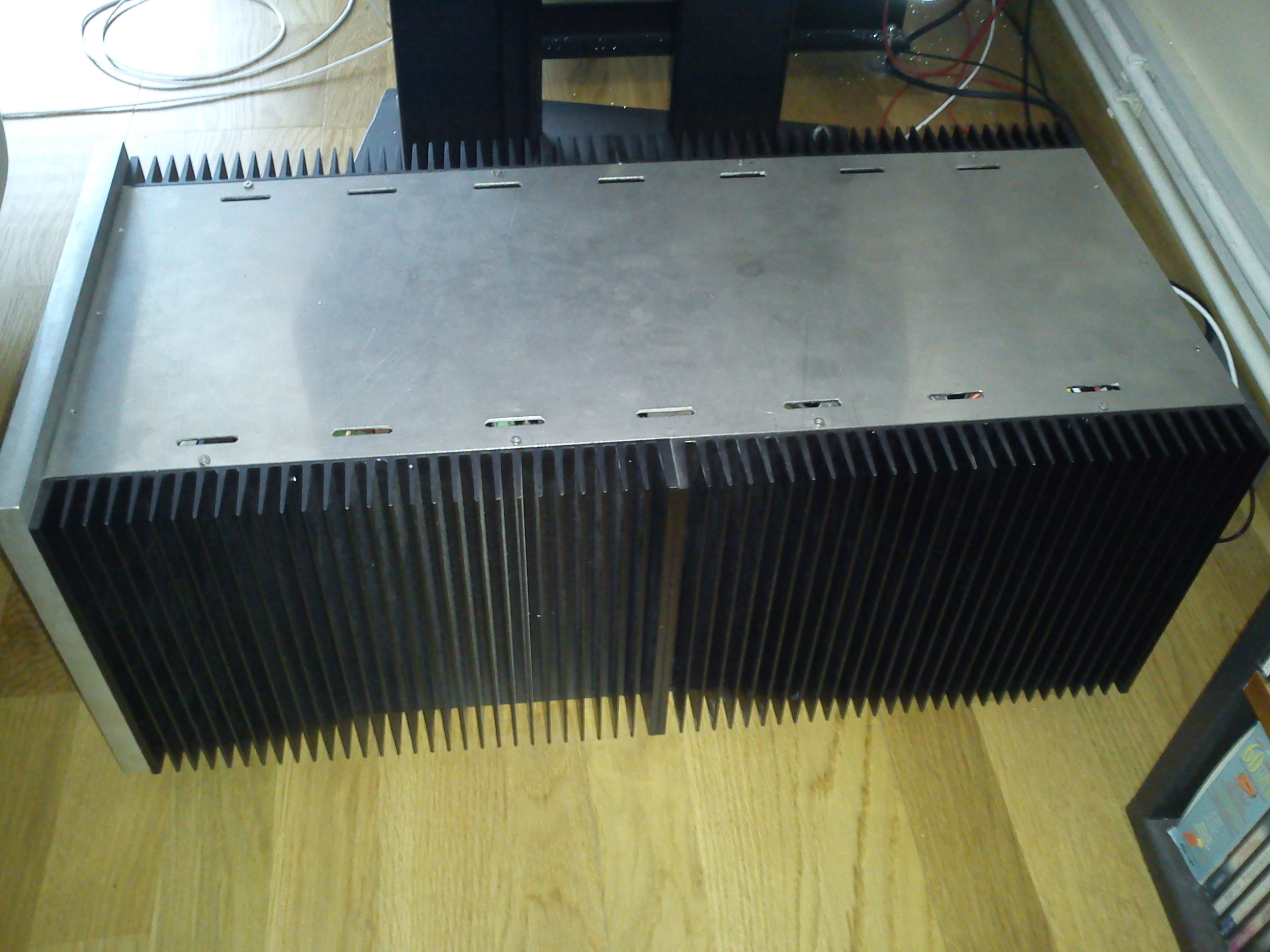

I have to spend a fortune in heatsinks? could anyone link me to a proper heatsinks model to have an idea?
From my web page: I have 6 of these per mono. Total cost was about $200 per mono chassis. Others have used the heat sink guy who posts here on DIYAudio, though I am unaware of pricing. Seifert (spelling?) in Germany makes very high quality sinks, but they tend to be somewhat more expensive.
My Borbely 75w have each mono amp 4 heatsinks 30cm x 22.5cm (fins 4cm)
My apologies, Felipe. My sinks are 10" (~ 25.5 cm) tall. Given your location, I would look into sourcing some Seifert (or other more local) heatsinks. They have one that comes in 18" widths (45cm). I'm just thinking that shipping from the US will be very expensive.
The "law of diminishing returns" applies to the length of your heat sinks. A 10" long heat sink does not provide twice the cooling capability of one that is 5" long, so making them much longer does not help as much as you think.
Eric
No, the link you have provided are TINY heat sinks intended for CPU cooling and are not appropriate for an amplifier. The rating of those is 0.8 c/w WITH A FAN.
The sinks I used are 0.8c/w per 3" (80mm) length. Since mine are 10" long, they have a c/w rating of somewhere near 0.43 c/w with natural convection (no forced air with a fan). Using 6 of these per mono provides about 0.07c/w for the entire chassis.
The final size of my chassis is determined by the size of the heat sinks. One mono chassis measures 20" deep (3 sinks side by side), 12" tall (10" sinks + 2" legs) and 14.5" wide (10" of interior chassis space plus 2.2" of heat sink on each side) and weighs over 65 lbs.
