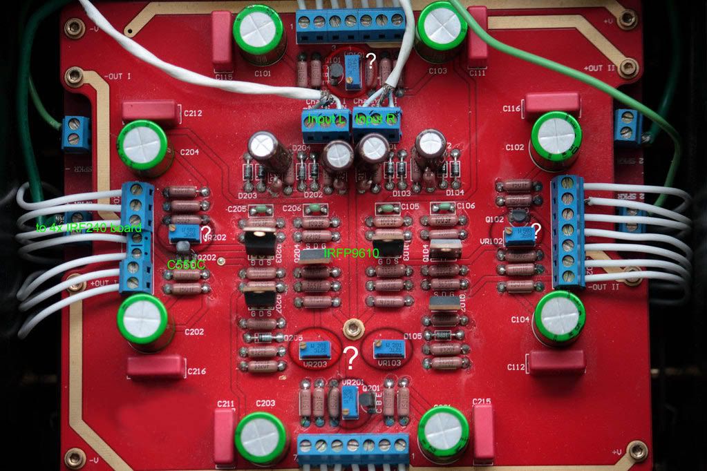

I have two oscilloscopes, a Tektronics 442 and an old 2MHz army surplus analogue scope with a full complement of probes. I really don't know which is the better tool. I also have a Fluke 8505A with the AC option cards and the HP 4271 for capacitance measures. You're giving me the sense that there is nothing better than the 9610 for the input pair other than the JFETs already used for this circuit or you would have said so. If this is going to be about tweaking the Aleph-X with the tried and true parts then I should probably be asking for help in the Aleph-X builders thread. I don't want to muck this one up with posts on how I failed to build it right.
I am asking those who have taken on my quest to better my Aleph-X to look in the builders thread for all future posts about measurements, adjustments and tweaks. I will continue to post in this thread only on alternative front end design changes and parts.

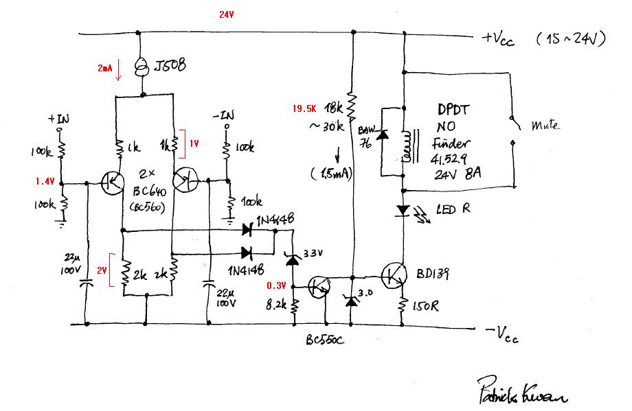

Chois¢â said:Patrick
I tested your balanced protect circuit.
But I got wrong result.
CCS 2mA. Supply voltage 24V.
When relay on state, "+in" and "-in" point were 1.4V both.
To trip relay it needs 5.8V over at "+n" or "-in" point.
Plz help...
you put -Vcc on gnd or on -24V ?
it must be -24V

> I tested your balanced protect circuit. But I got wrong result. CCS 2mA. Supply voltage 24V.
> Plz help...
Sorry for ridiculously late reply. I have not been watching the AX threads for years.
CCS 2mA is too low. J508 is 2.4mA, giving a max of 4.8V across one of the 2k resistors. This minus 0.6V drop across the 1N4148, and a further 3.3V across the zener, still gives 0.9V to turn the downstream transistor on. This is not the case with 2mA. You can make up for this by changing the 2k resistors (2x) at the collectors of the BC640s to say 2.4k or even 2.7k. The circuit should then functions properly.
To adjust trip point sensitivity, you can vary the values of both 1k resistors at the BC640 emitters (both simultaneously). E.g. when changing 2k to 2.4k, consider using 1.2k instead of 1k.
You might also need to adjust the value of the 150R power resistor to suit your relay. The valus is given by 2.4V / Relay on current. The 2.4V comes from the 3V zener - BD139 Vbe.
Hope it still helps. I have sent you a PM.
