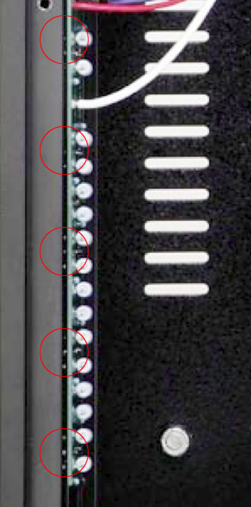

Counting the fets (source resistors actually) there is 32 in each side of the pic. If the picture in the japanese pdf is in fact a XA100.5, that amounts to a total of 64 mosfets. I could have sworn that Mr. Pass said 40 somewhere?
Steen🙂
I though Mr Pass said 40 too. Perhaps we were both hallucinating? 🙂
Ian.
NP posted that as a comparison to the 24 of the pure single ended version.
He may have only mentioned the total of matching top and bottom numbers, gone up from 6 in parallel to 10.
Papa likes symmetry, so it's hard to read the number of output devices from the output board.
If there's a 1-on-1 relationship, a simpleton would assume 10-10-12 for each side of the mirror.

A total of 40 doesn't really add up either, i've been thinking about this number thing for weeks.
Suppose the number of output devices in parallel remains 6, a total of 40 then leaves 8 for the single ended bank on either side.
Placing power resistors in parallel has not ever been one of P's attractions, fair to assume that the 64 power resistors are connected to the same number of devices.
The 300 watt power consumption figure speaks against it, however.
I had the same thoughts myself about the 6 and 8 devices. Then again I can't make much more sense of the 10-12 either. I guess the ratio of PP devices to SE CCS devices will depend on the amount of SE bias leaving us back where we started. I wonder if the 300W power consumption tells us anything apart from the obvious total amount of bias?
Ian.

Seems like there could be 14 fets in each corner with 2 fets for SE biasing each? Take a look at what papa says in the link and a close look at the outputboard.
Steen🙂

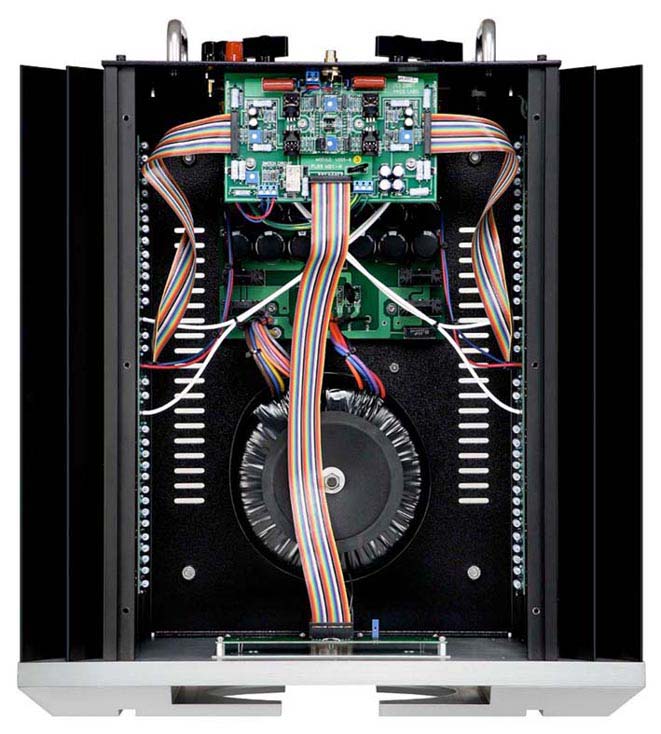

Everybody counts the number of resistors in the Japanese manual not the MOSFETs! When you zoom in the picture you will see the legs of the mosfets. There are 10 devices mounted above and 10 (which you cannot see) below on the heat sink - means 40 devices for the complete amplifier.
I assume eight complementary pairs + four SE-CCS (made of N-ch. devices) per side.
The bias per side must be something about 3A. I would say 2A out of the CCSs and 1A through the P-devices. That gives a dissipation of 13W per CCS.
But my question are the 32 resistors. Each device (CCS and comp.device) needs one source resistor and so there are 12 to much.
What are these power-resistors for? Output to ground - helping to stabilize the DC-offset like the XA-series does?
Greetings
Dirk

You must have better eyesight than I do. I can't see the MOSFET legs but the resistors are much easier to count. Are you sure that there no other devices lurking where you can't see them? I'm also not sure about the 8 complimentary and 4 SE-CCS. The classic Aleph0 used 8 SE-CCS for 2A bias and this was not a symmetrical design, i.e. would translate to 16 devices for this design. I still don't understand why so many are required unless it is simply a rugedness issue.
How did you arrive at the 2A for CCS and 1A for P-devices? Would this allow 100W into 8 ohms? I agree that 3A overall per side is consistent with the 300W rating for power from the wall. 3A SE is clearly not enough but your 2A + 1A may be on the grounds that PP is more efficient (output = 2 x bias current).
So what are the 'other' resistors for? I guess it depends on whether there really are 40 or 64 output devices. If you are convinced that there are just 40 then we have another conundrum. I don't think the DC-offset needs stablising in this design and even if it did, 12 resistors would seem to be overkill.

Hi ZEN MOD, hi Ian,
yes, I'm quite shure that there are 20 mosfets. You will only see that in the XA100.5 manual not in the 60.5 or 30.5. There you will see the legs a bit shining between board and heat sink. The distance between the fets are always the same.
I don't know if my assumption with 4 CCS per side is correct.
You are right Ian that the Aleph0 uses 8 devices for 2A SE-current, but they have a bit less than double the supply-voltage to handel - each CCS-device 10W (idle).
With 2A SE-current and 1A PP-current through the P-ch. your maximum reachable mixed SE-PP-classA peakcurrent will be 4A (2A + 2x 1A) which will give you 64W RMS at 8Ohm.
When you wanna reach 100W RMS at 8Ohm in classA (SE-PP-mix) the SE-CCS must set to 1A and the p-ch.-bank 2A.
I know there is no hint for such calculations and all is speculation!
It makes the most sense for me that the SE-current is as high as possible, but leaving enough current left over for the p-ch. bank (in my calculation 125mA/device). So I'm coming to the conclusion that the SE-current is maximum 2A = 50W dissipation, a bit too much for 2 devices and too less for 6.
And yes I'm quite sure too that there is no CCS modulation.

It seems that the XA100.5 uses seperate windings for the front end, XA60.5 and XA30.5 don't...
