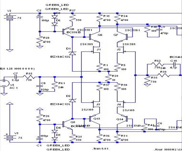

Hi Ian,
I always use a 50-200 ohm resistor in series with the JFET sources on my symmetrical input differential pairs to linearize the gain which reduces distortion. Low parisitics are important here, so either a surface mount or 1/8 watt film resistor work best. I also use zener diodes plus bypass capacitors to bias my cascode circuits.
I attached an interesting JFET-Bipolar_cascode input circuit from a diyAudio thead showing these ideas.
If this group is open minded, a Super-Symm design using the newer ring emitter bipolar output transistors from Sanken and OnSemi would be a good challenger to original all MOSFET AlephX thinking. OnSemi adds diodes on the biploar output die for rapid thermal tracking.
Your idea of including source resistors is one I have seen used elsewhere, e.g. Borbely. This may well be a good idea but is not something I have experimented with in practice. Have you made any listening and/or measurment comparisons of the two approaches?
I also notice that your circuit connects the cascode references to the source resistors rather than earth (as per my schematic). This is intuitively better but I was concerned about then having to allow for the effects of the reference currents through the diff pair 'tails'. Presumably you have not found this to be a problem?
Hopefully the group is open minded and from my perspective there is plenty of room for alternative ideas. Perhaps we can all build something slightly different and compare the results? We will need to keep the basics constant though otherwise it will be difficult to know to what to attribute any audible differences.
Ian.
