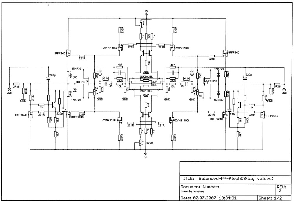

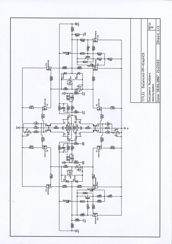

Hello
I've drawn down the idea of an AlephCS in parallel to the p-output followers.
Is it possible to build that, or are there some principle things done wrong?
(resolution is horrible, I can't do it better with 100kb)
At the moment I'm trying to understand how to handle the Aleph-CS in such a position. I have a problem to calculate and manage the ratio between the max. neg. current swing of the CS and the hole max. neg. output current???
Dirk

hi macka,
thank's for your reply. I've chaged the resolution and boost up a bit the size of the font.
It should be readable now.
I know the fortune of the dual-jfets. But there are also single jfets which can be used. A lot of this projects here need some in the front end.
At the moment I am a bit confused which I should do first. It seems to me that the favorit amp out there is the F4. I've published a question to it in the F4 thread with no answer at this moment. Hoppefully that somebody will answer to it - wanna find out which is the better topology.
Also I came to no conclusion, if this published circuit could work.
greetings
Dirk
