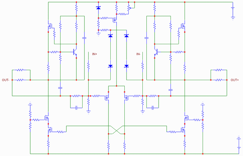

Ok, I don't have the skills, but at least I tried.
Took me a few hours to read the cascode PDF and try to draw something.
I simplified Greys schematic, as only the cascode (at least that's what I think it is) is important.
At the risk of posting something completely ridiculous could someone tell me if this makes any sense.
No need to tell you it will be appreciated. 🙂
/Hugo

That's a nice approach, but would work a little better if you
use a voltage reference instead of resistors to bias the
cascode Gates. This way the transistors will not see supply
noise as much.
Also, you certainly can cascode the input transistors as well,
as was done with the X600 and X1000.

So a Cascode can be used to shield a Low voltage transistor against a high voltage rail by use of a high voltage cascode transistor ?...

Found this post by Nelson:
http://www.diyaudio.com/forums/showthread.php?postid=174696#post174696
Maybe this answers your question. 🙂
/Hugo - still reading patents...and patents...and patents. :nod:
It gets me a little bit closer. Unfortunately I cannot bring myself to read patents, after the first line I want to throw everything out the window. I find that patents really describe everything under the standpoint of what one should not copy, explaining how the circuit works is beyond the scope.
